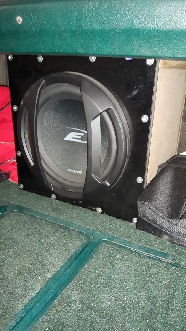

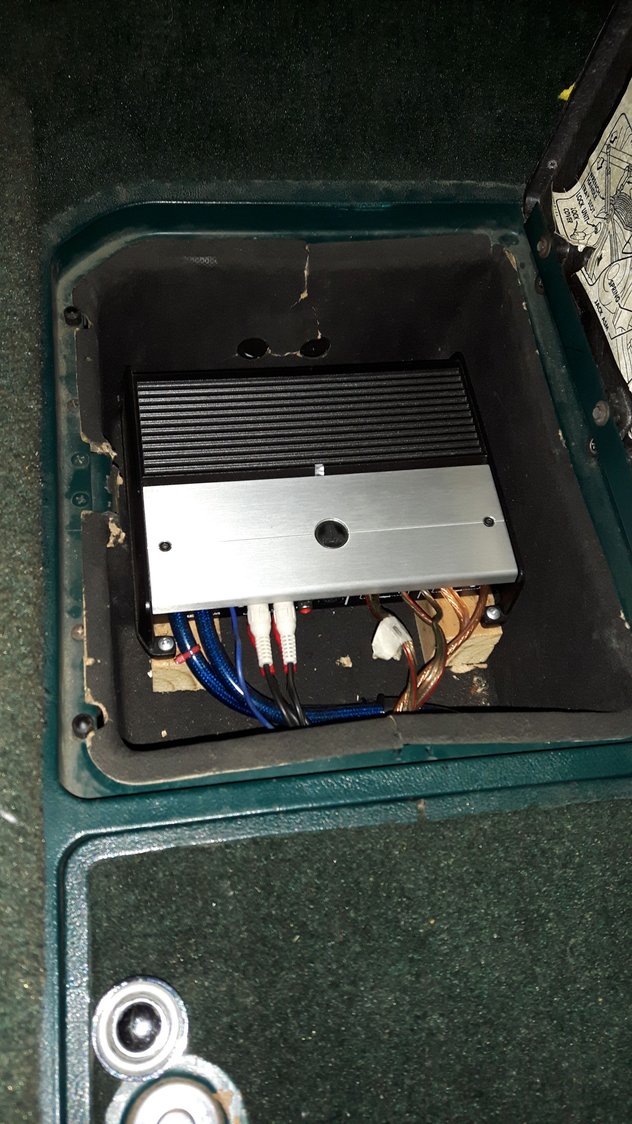

I have this amp, JL Audio 400/4 mounted in the storage tray above the car jack. I close the lid when it's turned off. Also have a 10" sub mounted in a custom made speaker box behind the seats and 6-1/2" shallow depth speakers behind the kick panels.

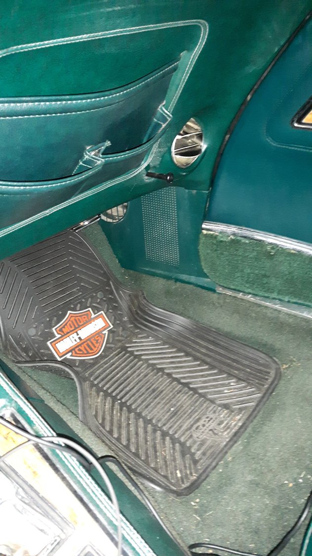

Here ya go.
No need to cut holes in the kick panel with shallow mount speakers.
I mounted the amp on a couple blocks of 1"x1" wood for air circulation under the amp. Lid can be fully closed.

Thar looks good. It was what I was thinking about doing. As long as I found one that fit properly. How did you run the wiring? Under the carpet or did you modify anything? I was also thinking about fabricating a vented cover that would allow it to stay closed.

The power cables were run under the centre storage tray into the batter compartment. Wiring for sub is under the carpet. Front speaker wiring was run under the carpet by the rocker covers and the wiring to the head unit was through the console. I removed the passenger seat and peeled back carpet. I think the only holes I drilled were in the tray to pass through all the amp wiring. Install wasn't all that difficult really. I made the sub enclosure based on Alpine's recommendation included in the sub's install sheet. It's just made of mdf with a removable front. I did it that way so I could access the inside of the sub enclosure to secure it to the existing mounting hardware for the t-top storage straps. It would probably rip away from the mount in a head on but it does keep the enclosure in place. The amp is fastened to the wood blocks but the wood blocks are not fastened to the tray. That way I can flip the amp from the tray in order to remove the tray to access the jack.
