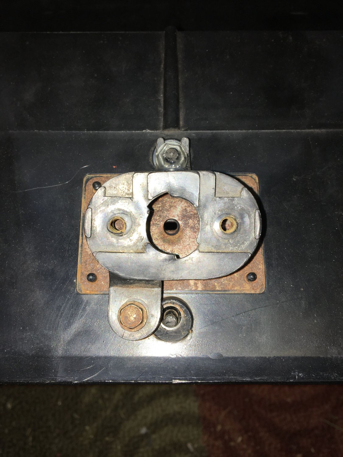

Thank you for your response and pics. Just so I am certain of what I'm doing I am including a pic of my console where the light goes in. Am I correct to think that the two eyelets go around the bulb holder and then that is pushed in and turned to secure it to the console? Please let me know. Thank you all again for all of your help with this. Enjoy ur day.

YES,
Those two Phillips head screws is where you will install the eyelets so when you install the light bulb it will have a 12 volt source and a ground to make the light shine.
I would say that installing an LED in place of that incandescent bulb is MUCH better and provides more light. Because at night tine...there is very little to almost no light that gets to your shift console with an incandescent bulb....even with the correct one with the magnifying end on it. Not only that...the incandescent bulb gets hot and can melt the housing also.

Thank you for getting back to me so quickly. I will take ur advice about the type of light bulb I install. Does it matter which eyelet I attach to which screw head? Do you know where I might find a complete diagram or guide to reinstalling this radio. It is an original am/fm/casette/cb radio and I want to be sure I put in back in correctly. Thank you again for all of your assistance with this. enjoy ur day.

No it does not matter which eyelet goes where as long as youahve enough wire.
BUT...keep in mind that when you go and install the LED light bulb. It HAS TO be installed one way to work. So...if it does not work. Take it out of the socket and spin it 180 degrees and put it back in.
