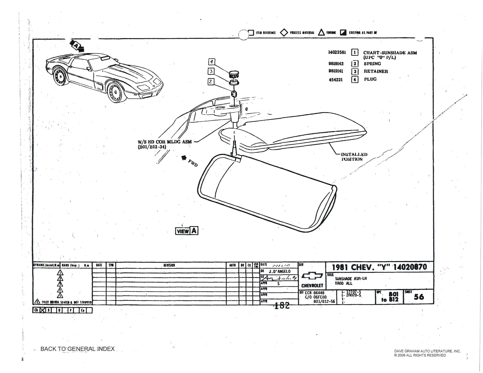

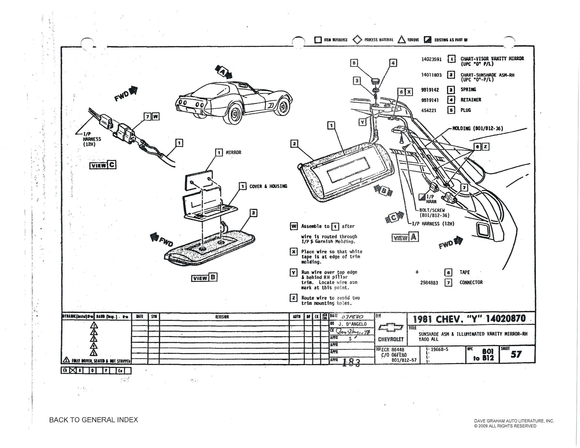

Hi All,
Relatively new to Corvettes. Bought my first this past January. 1982 Base Coupe with only 25000 original miles. I love it!!! Exterior and interior are pretty much perfect with one exception. The lighted vanity mirror on the passenger sunvisor is missing the flip-up lid. I'm guessing it was broken off sometime in the cars history. The lights still work when the little button is pressed but to keep the car perfect I would like to replace the entire lighted mirror assembly. The visor itself is in perfect condition. I did not see much information in my shop manual regarding removal of the mirror assembly from the visor or replacement. Have not dug into things too deep but does anyone have any instructions or suggestions on the steps to perform a replacement? Can't tell yet how the mirror assembly attaches to the visor or how to get it off. Any help would be greatly appreciated forever and ever.

Old May 31, 2018 | 12:17 PM
rastafford3164's Avatar
rastafford3164
Joined: Jun 2013
Posts: 311
Likes: 37
From: Sparta NC
See if these will help til yours comes in. Should be the same. Just realized you are down there in Greensboro. I'm up here in Sparta.

Excellent!!! Very helpful. The new vanity mirror should arrive today so the diagram you sent helps greatly. Many thanks and best wishes to you and all in Sparta.
