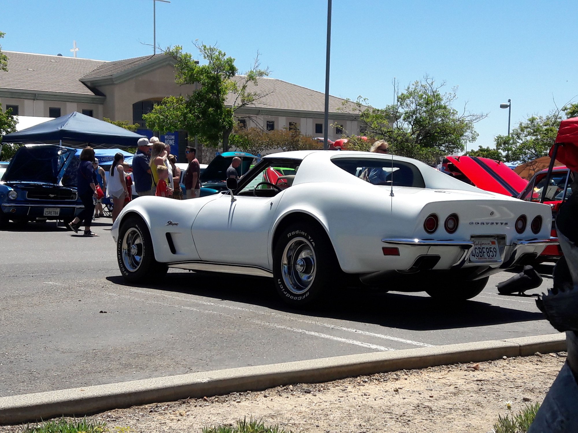

72downunder's Avatar
72downunder
Joined: Dec 2016
Posts: 190
Likes: 30
From: Wollongong Great Southern Land
She's wearing 235/60 15 front and 255/60 15 rear, has been lowered 1.5 inches and have no problem with clearance when turning or over bumpy roads.

jr9170's Avatar
jr9170
Joined: Feb 2003
Posts: 13,238
Likes: 1,092
From: YANKEES UNIVERSE 70 454-LS5 500 ft-lbs Torque
Down under beautiful looking ...

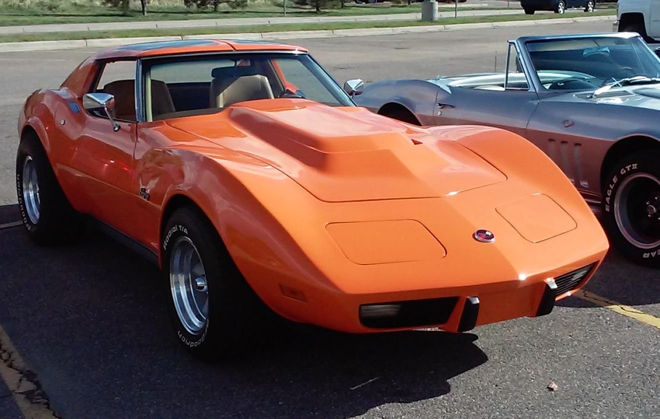

Iceaxe's Avatar
Iceaxe
Posts: 4,355
Likes: 2,633
From: Draper Utah
1970 Corvette
245\60-15 BFG's on all four corners.
72downunder
Joined: Dec 2016
Posts: 190
Likes: 30
Thanks JR
