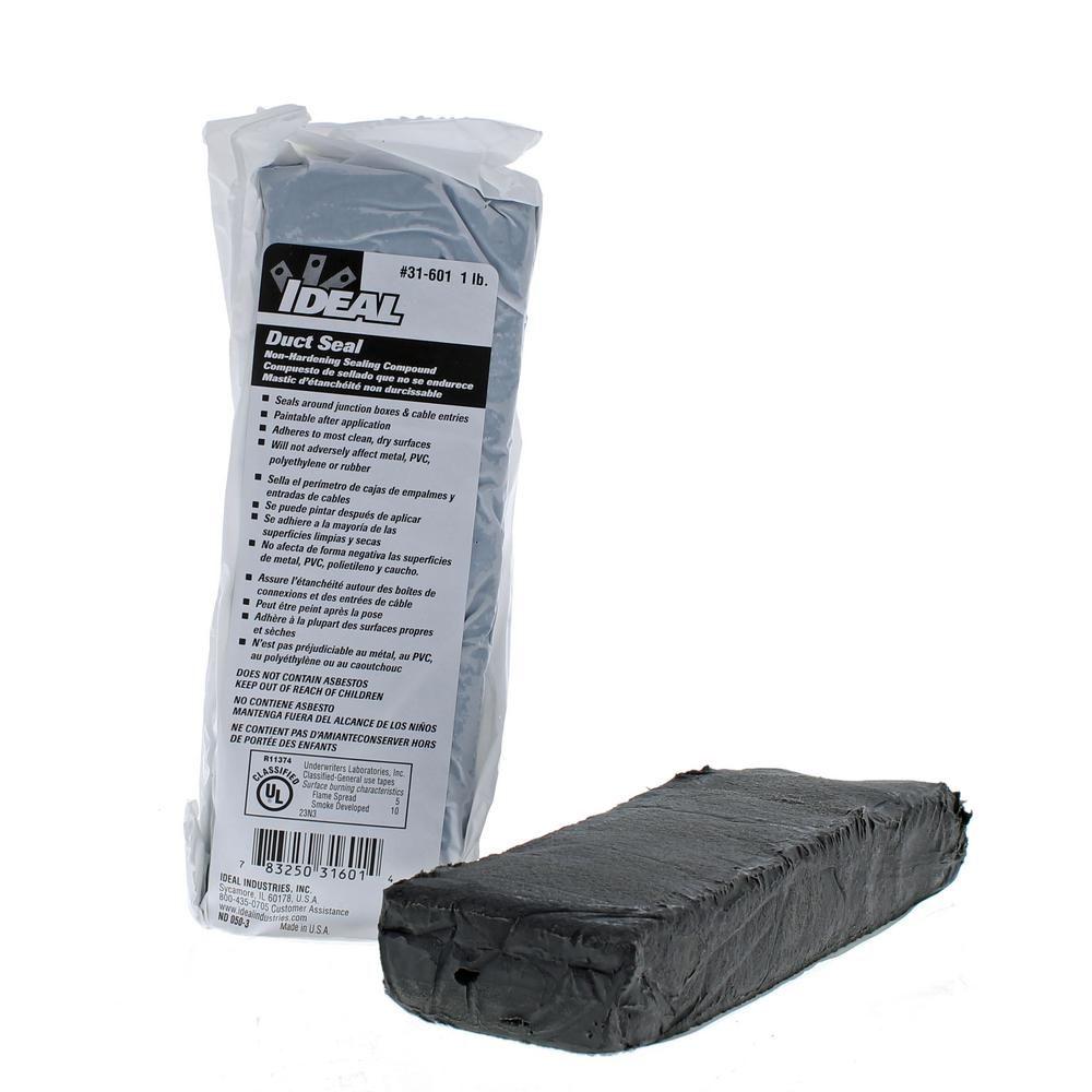

On mine, I used electrical duct seal. It is a putty that`s used to seal moisture out of electrical panels & cabinets. It does not shrink, crack, or harden. I figure if it`s good enough to keep water out of electrical boxes, it should work on my windshield & T-top channels! It`s about 4 bucks for a one pound block, and I used about 3 and a half blocks.
