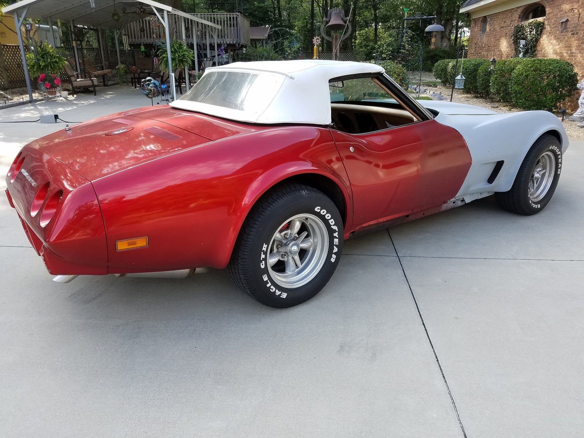

Thanks for all the quick responses. I wasn't clear in that the fenders, hood, front clip and all have been replaced and just need paint. I was going to paint any car most likely as I have a specific color in mind.
The rear bumper looks like it is off of a '75- I'd inquire about that too. It also has the '75 emblem on the gas lid so who knows if this car has had a history with its rear as well. Yes it could be replacement for cracking bumper and the emblem added but I would still wonder.

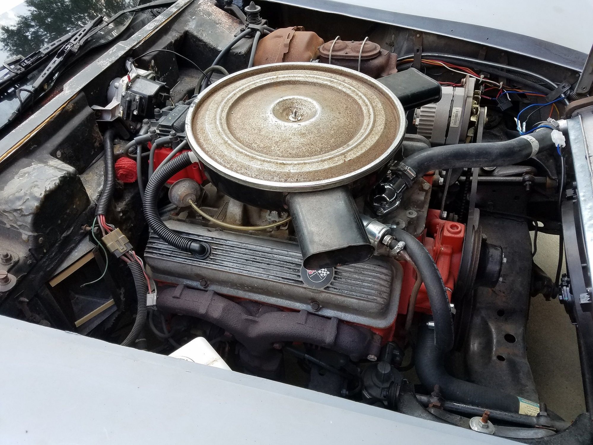

What's with all the JB weld on the top of the firewall in pic 4?
Also, this appears to be an A/C car but the entire evaporator case is missing from the engine compartment (burned to a crisp I suspect), along with the A/C compressor etc. and there is now a huge hole in the firewall where it should be mounted. What's with that?
I have to agree with the others-
This is a questionable car that still requires a fair amount of effort to complete.
There are lots of better options out there for the money.
Just sayin'

Ezobens,
I missed that, pretty much hack job there,
Im pretty sure the engine has to come out to repair the ac housing...my 72 bb did
Just sayin'
I didn't notice that at all. Also, I had no clue it was a 1795 rear clip and emblem. I asked the seller about that when I was bowing out and he said he didn't believe that. Anyhow, thanks again for all the knowledge and suggestions!!
