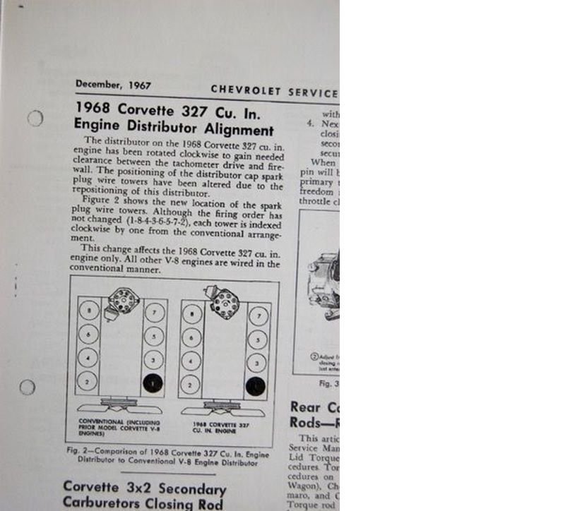

This sounds similar to the OEM problem:
The issues of the tach drive angle and advance can clearing the shield support were critical enough that they made the Service News as the 68 cars were being produced. It affected both 327 and 350 cubic inch engines. Note the change affected only Corvette engines.
