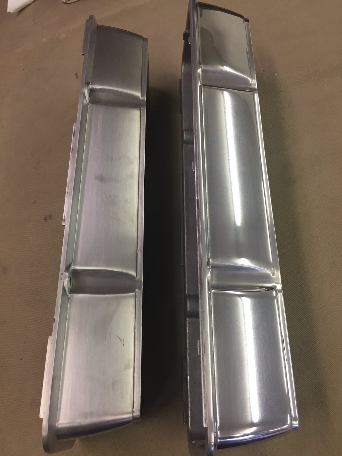

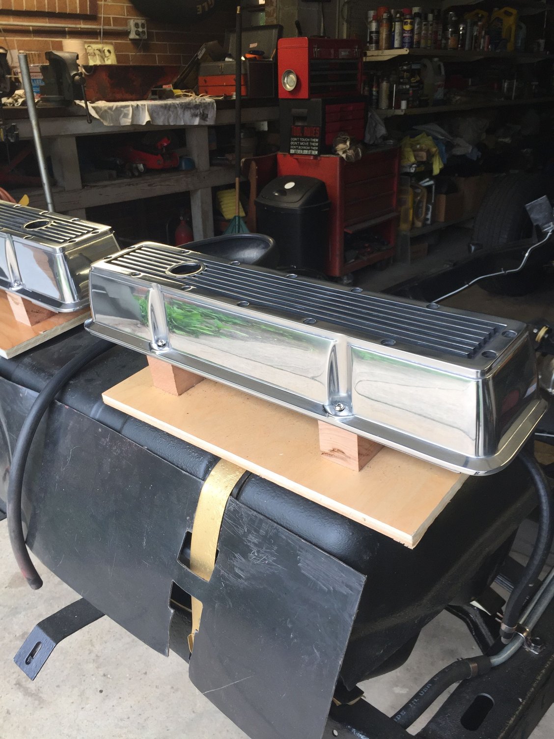

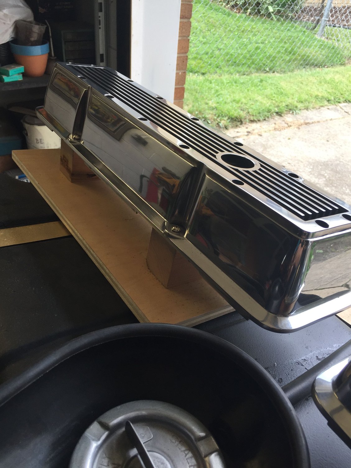

I've decided not to anodize or use alodine on my aluminum valve covers. I hand sanded down from 150 - 1000 grit paper in 6 steps and then hit them with a buffing wheel and I know everyone is dying to see them (not really, lol). Well, here they are. First, a comparison between 1000 grit and buffing and then after with metal creme polish:
