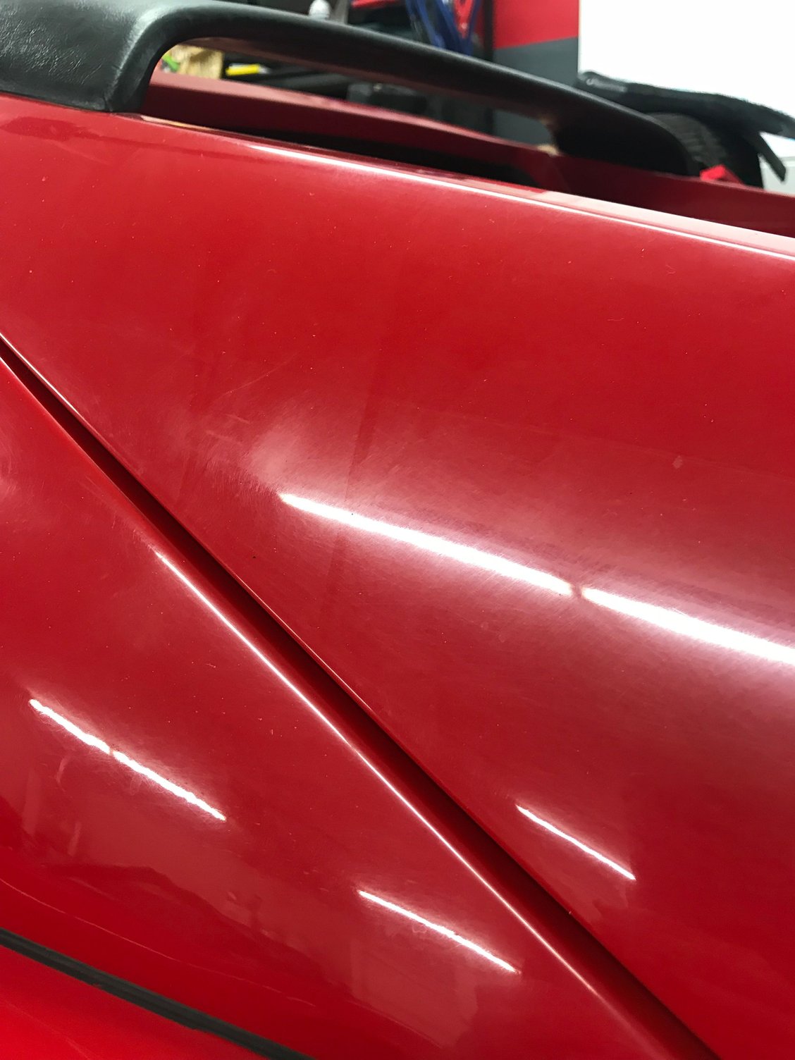

My 1979 Corvette paint is dull and I would like to get it looking shinny like it was 10 years ago when I got it... anyone recommend any good rubbing compound that could take a a thin layer of paint off and get down to the next layer and make it shine?

Have you considered a clay bar?

Try meguiars show car glaze number 7

You probably need a good "cut n buff". Mild rubbing compound followed by a good glazing finish. But, this needs to be done with power polisher/buffer, correct pads and good quality compound & glaze.
My suggestion would be that you find a good shop to do this for you, unless you feel you have the skills to do it. But, if the car has its original paint, you may not find anyone WILLING to do the job. If that's the case, ask the shop [who you trust the most] to give you a list of proper materials, pads and technique. Then, give it your best shot!
P.S. The most important thing to know is ALWAYS have the machine rotation direction going OVER any edges; NEVER have it directed into an edge. (If that confuses you, send me a PM)

I just recently sold a Ferrari dubbed “Frat House Ferrari”, google it. The paint was really dull, and I spent very little time on it. I used Adams Polishes Swirl & Haze Remover with the recommended pad and a Porter Cable Buffer. I did the entire car is a couple hours and the results were awesome.
Clay bar will not bring out shine, it will just remove any surface contamination.

use meguires 105 with an orange pad. finish with ultimate wax or nxt tech wax. Its my go to over the counter stuff you can find locally.

I wouldn't do the learning curve on your corvette, go get a smashed hood form an auto wrecker and try it on it first. you will burn right through on edges and corners (corvette has lots)
