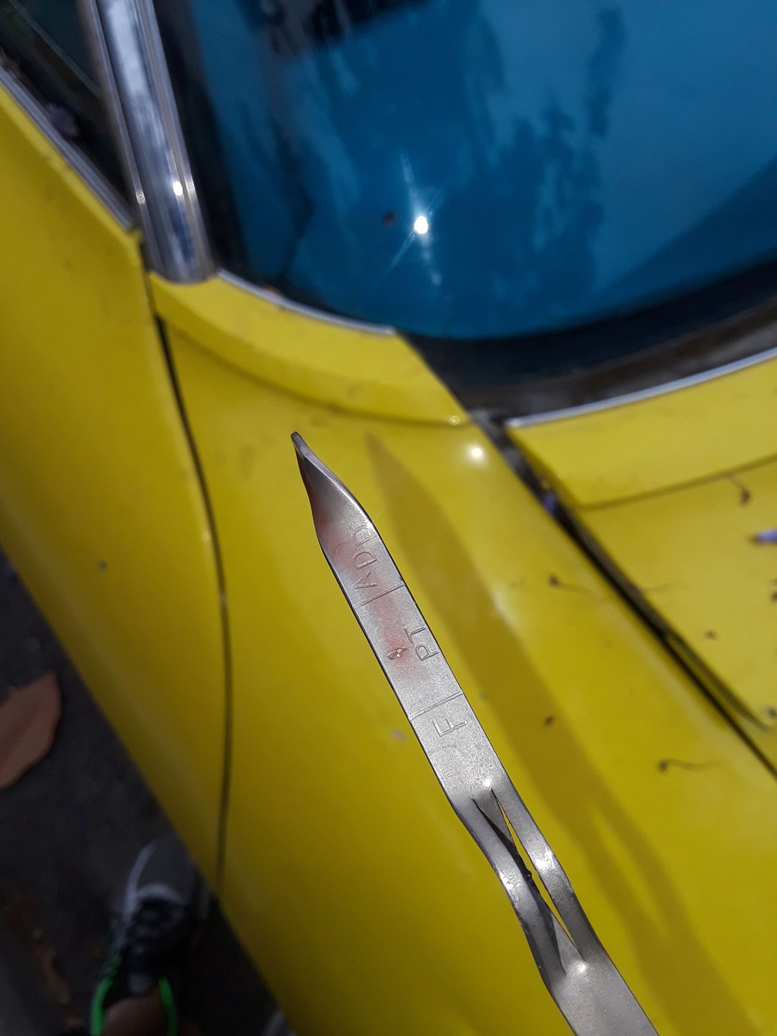

Checked most of my 69's fluid levels today. I only have the Haynes guide to go off of. So I was hoping you guys could help me with tips. Can you take a look at the pics below and give your analysis on the quality of fluid, level of fluid, and which brand/type I need for refilling?
Radiator Fluid. Seems low, going off the guide. Couple inches under the brim.
Engine oil. When refilling the engine oil, I DON'T go through the dipstick tube, right? It's the cap on the rocker arm cover that I put the oil in, right?
Brake fluid, seems low. Does the quality look good?
Power steering fluid. Extremely low, I think. Cool to touch.
Auto transmission fluid.
Let me know what you see! Thanks!

it all looks good. As long as you top off with recommended fluids there should be no problem with brands. Its pretty difficuly to flush all fluids out completely and replace with a particualr brand anyway.
there is a procedure for bleeding air out of the cooling system but if youre not having overheating problems you can just top it off after the car warms up. your coolant looks fresh and nice level, there are cheap coolant testers to see the concentration quality of coolant.
the power steering is a bit low. but you dont want to overfill or the pump pressure will blow it out. I think the cap has a vent on it to blow out pressure so maybe thats why the engine is so dirty. but a lot of the time its worn seals on the pump/case, and leaky hose ends. So maybe replacing hoses pump and cylinder in future.
brake reservior level will vary slightly and drop as brake surface wear

Looks like ethylene glycol for coolant in the radiator. Any good brand will do. 50/50 mix of water and antifreeze (unless you decide to buy the ready-mixed stuff.) You need to get brake fluid into that master cylinder. [especially the rear section] Can't tell by looking what DOT No. it is....probably DOT 3. But, some of the other types are incompatible with DOT 3, so you need to be sure.
Put power steering fluid in your P/S pump. Folks put ATF in it, but that's not best for it. If the fluid in the P/S pump is red, it's ATF. If you need to change it, I'd suggest you take the car to an oil change place. They can do a complete drain and swap over to P/S fluid (clear).
ATF level is checked with engine warm and running, and after shifter has cycled thru all of the gears. Any decent brand of ATF will do.

Coolant will typically be about 2" below the neck when cold if you don't have an overflow tank. If you fill it to the top, it will just burp it out on the driveway when hot until it's at the correct level. Looks to be your typical Prestone variety.
Engine oil gets re-filled via the cap on the valve cover.
Brake fluid needs to be topped off.
If it hasn't been flushed in a number of years, you may want to consider it as brake fluid will absorb water which will eventually corrode the system from the inside out.
PS Fluid can be filled carefully.
If it's red, use Dexron ATF, if yellow or clear, use PS fluid.
GM used Dexron for PS fluid for a number of years so it's not 'bad' for the system and I wouldn't flush it for that reason alone.
Trans fluid needs to be checked when the trans fluid is hot. Engine temp is irrelevant-
Trans oil expands with heat so the trans fluid needs to be hot to get an accurate reading so you don't overfill.
Typically some spirited driving for a few miles will do the trick.
Car should be on level ground and the engine needs to be running (trans in park) to check.
