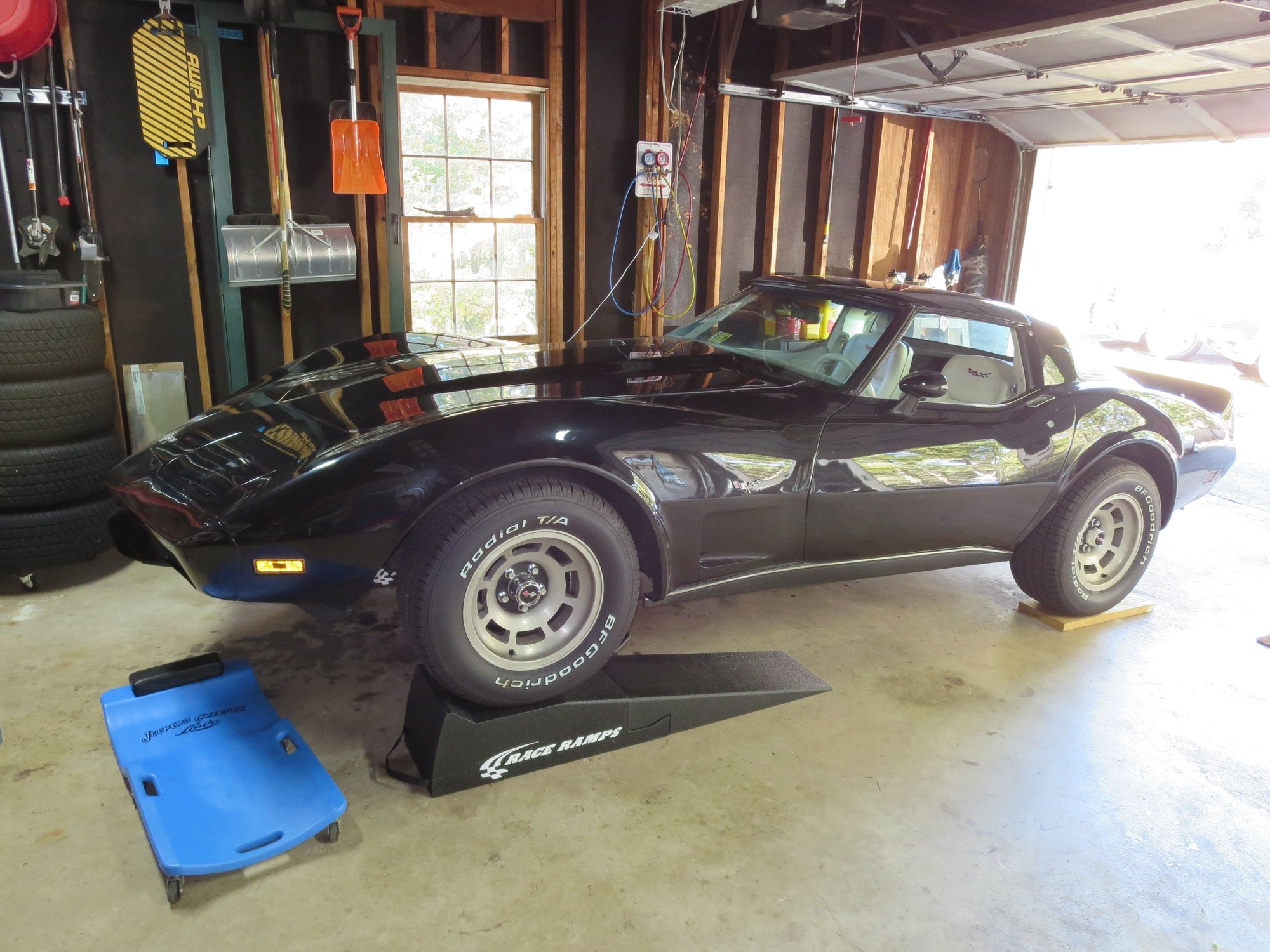

From the floor, I use 2 piece 56" RaceRamps at the front. I can then jack the rear either with two jacks, or one with a bar attachment to straddle the exhaust and lift by the steel spring. Then I can leave the front on the RaceRamps, or jack it by the front crossmember a few more inches to get stands in front of the wheels, and the wheels off. Never do I need to pivot on a stand more than a few degrees.
Thinking that continued jackstand use might hasten my demise, i now use a Qwik-Lift full length ramp system. I can get the car onto jackstands on top of that using bottle jacks.

Those are good tips. That is why, when possible, I prefer to leave one end on the suspension. If I do jack up all four corners, I count notches to make sure that both sides are raised up the same amount. Lifting from the front or rear, vs. the side, also helps.
When I don't use my Qwik-Lift, I do this. The 2x8s under the rear tires are to get the clearance for a lift under the rear that can lift by the rear spring. The 56" two-piece Raceramps will work with my 80, despite the front spoiler. Steeper ramps didn't fit.
