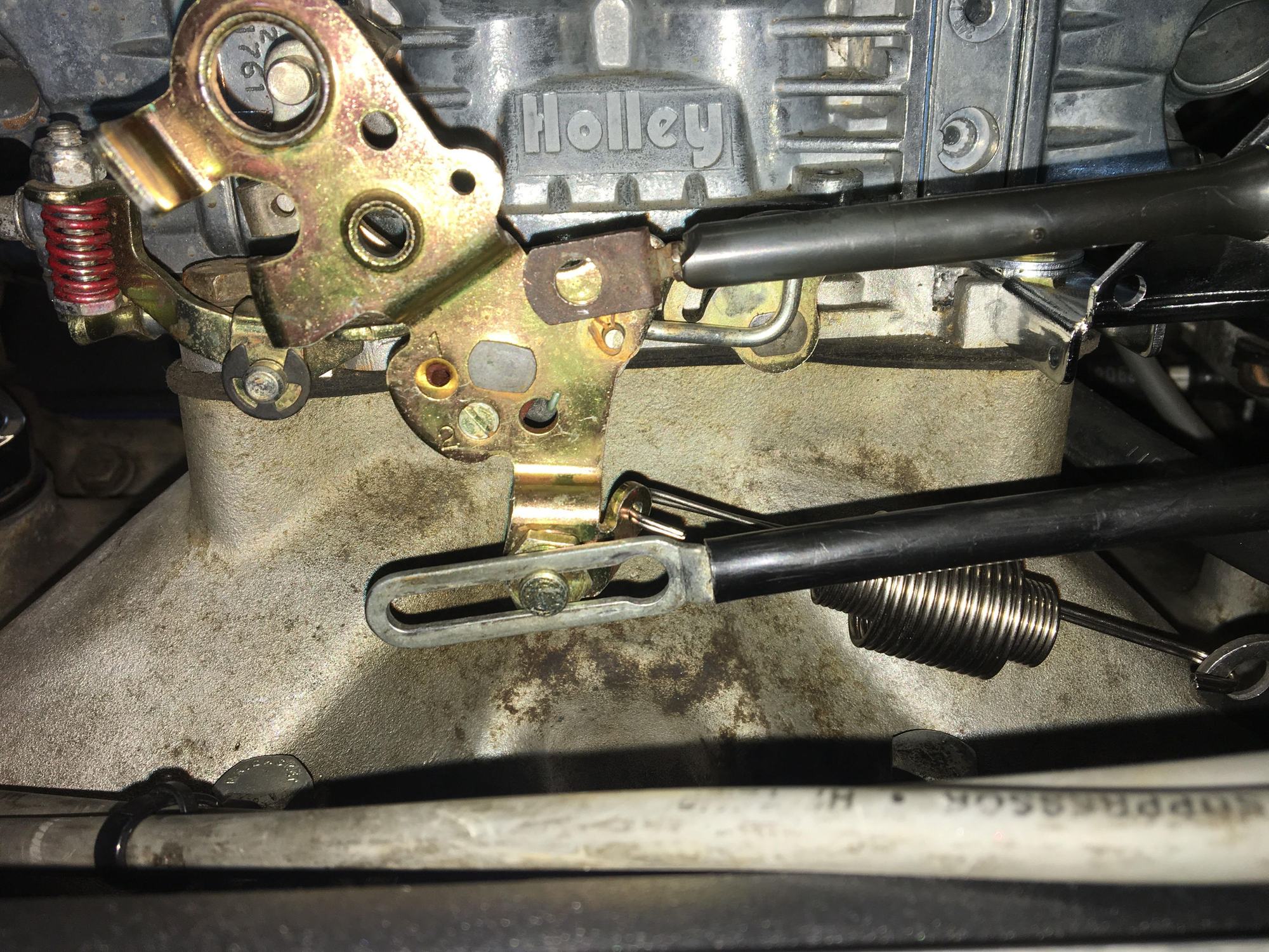

Trying to hook up my trans kick down cable on my TH350 and I'm not completely sure on how to do it. I read that you want tension at WOT, but how do you want it to be set up when you're not on the gas? Just tension on it at WOT? Included pic for reference.

When NOT on the 'gas'...just like you have it in the photo. TENSION on with then you have it at W.O.T.
DUB
Thank you! Just wanted to make sure.
