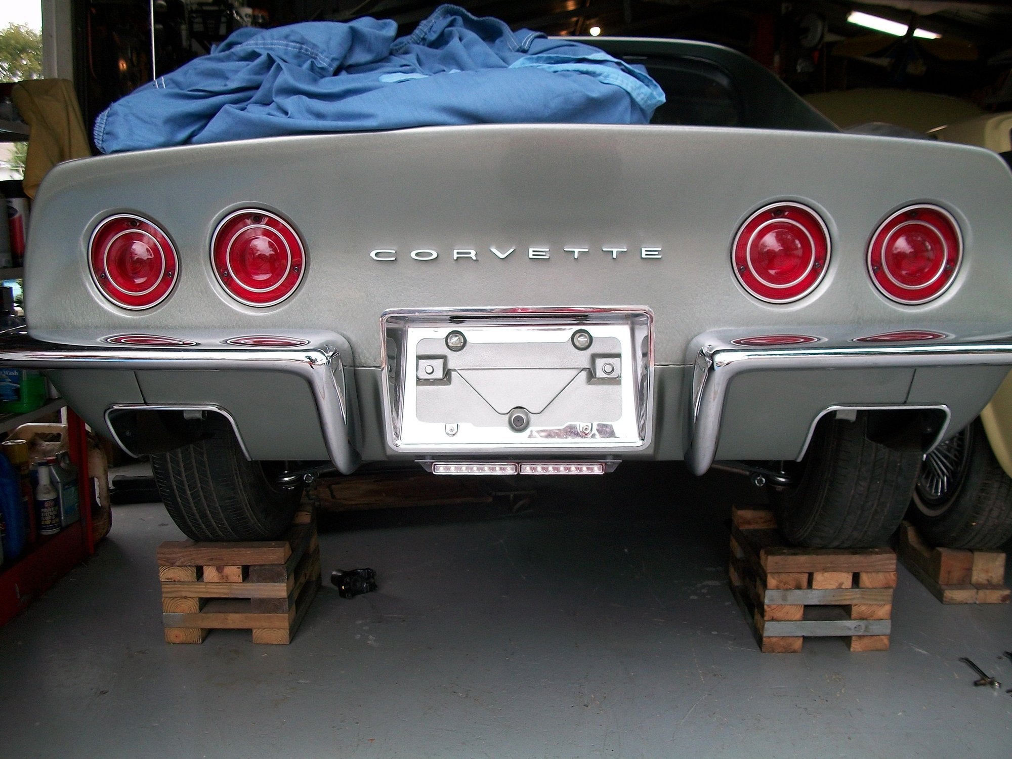

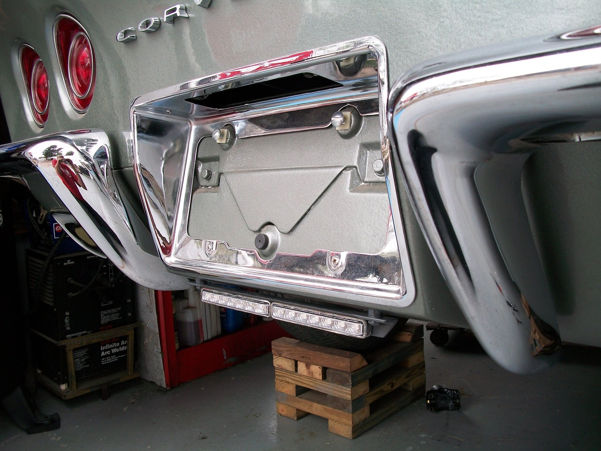

A few have. They make license plate frames that double as reverse lights.

We did it to our 71 coupe. The inner buckets have to be replaced, to accept the double pin bulb. The license plate frame with LEDs on the sides wouldn`t fit inside the stock bezel, so we cut them off, and mounted them underneath for reverse lights.

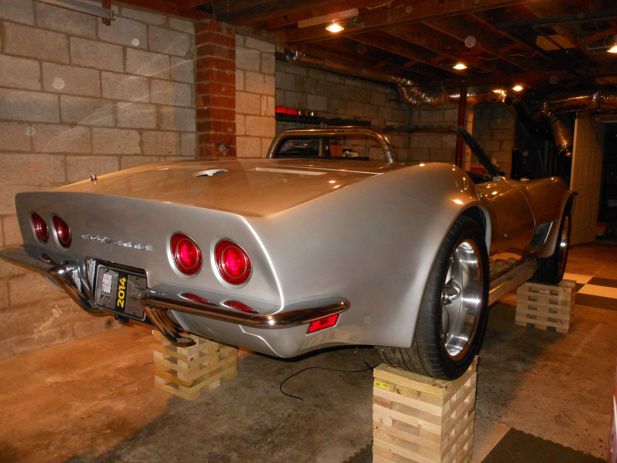

Yep- I think they look so much better-
Also did "hidden" reverse lights
And added sequential turn signals-
