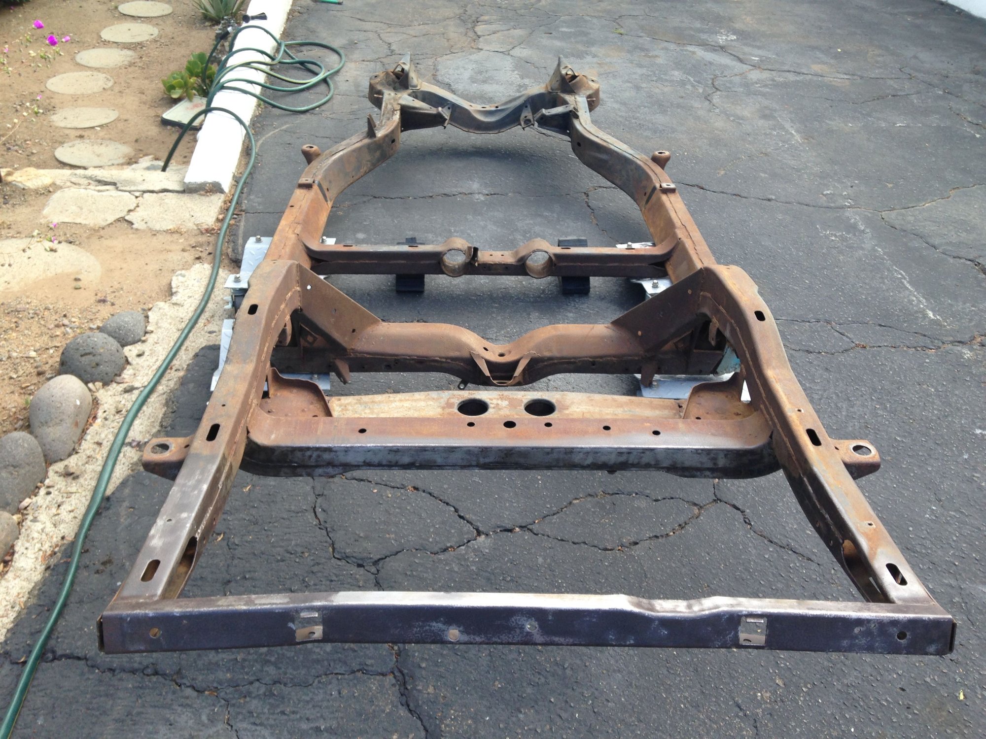

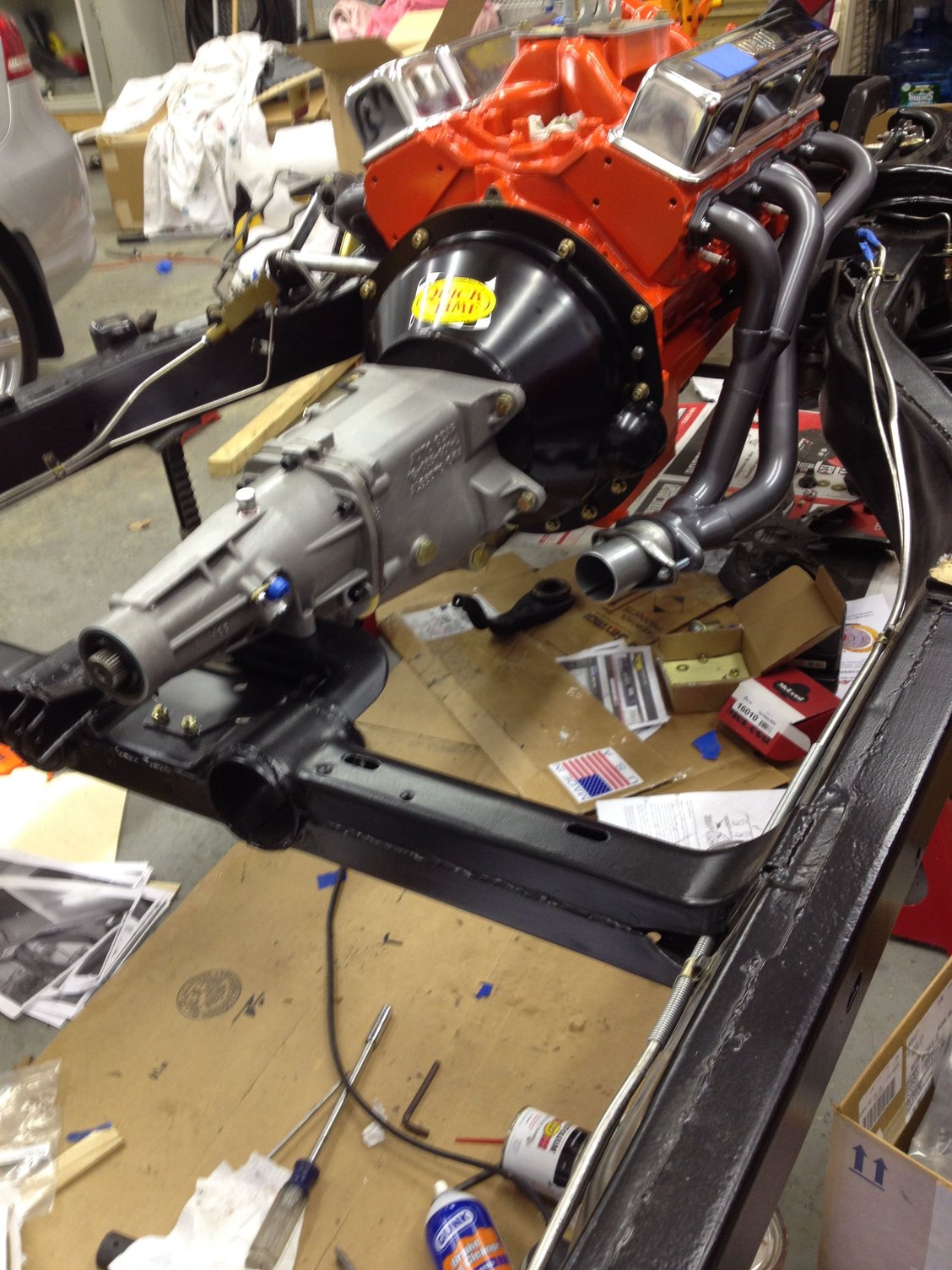

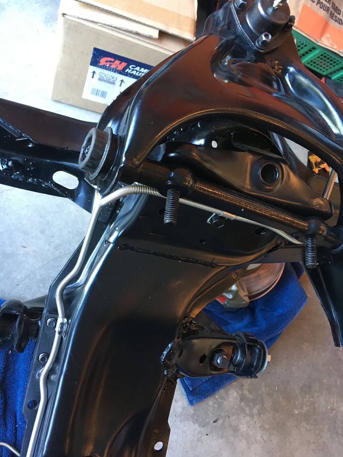

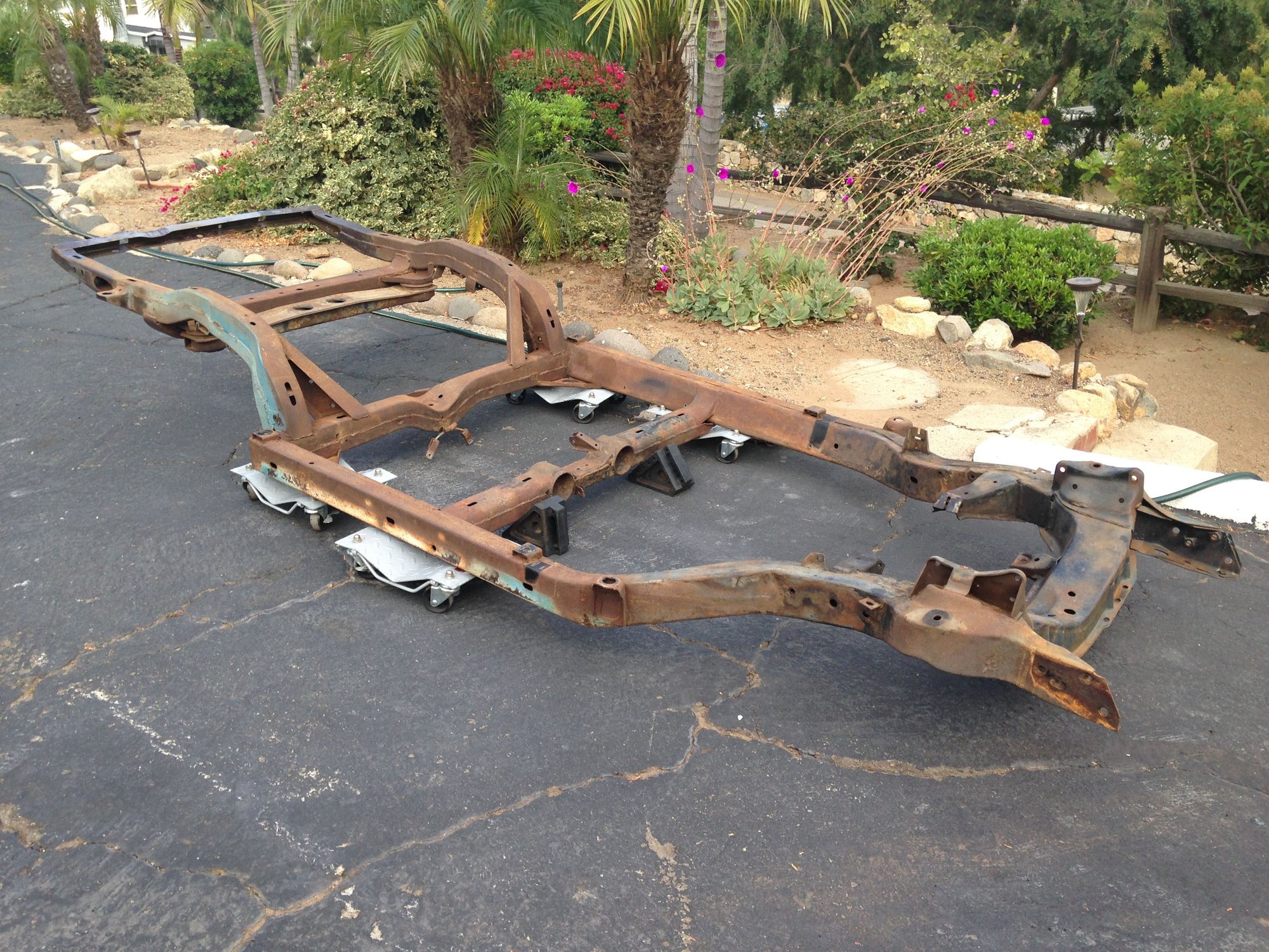

I sandblasted and powercoated
after I tried doing the derust and paint myself
Best $650 I ever spent
