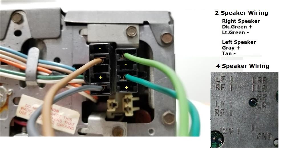

Front dash speakers only in 1977. These stereo radios were used in several 1977 Chevrolet model cars. The stereo radio can be wired to except 2 additional speakers because of the empty cells on each L&R connector marked + & -. You will need to find a few of these connectors if you want to add speaker wiring to your original connector.https://www.ebay.com/itm/25-Pack-Con...75.c100623.m-1
