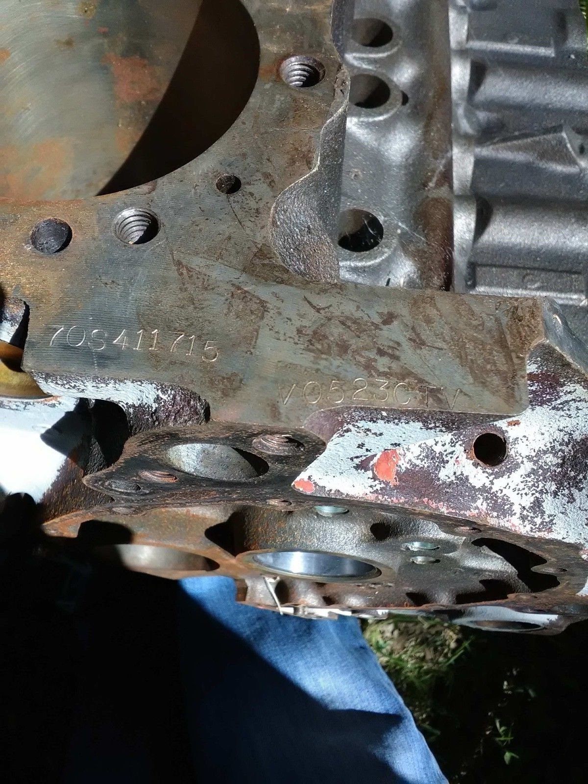

A famous quote, by a famous person, went something like“If you tell a big enough lie and tell it frequently enough, it will be believed.”
Note the attached photo of a 1970 Corvette engine, for a ZR1 convertible, currently listed on ebay
If you are going to lie about it, you might as well go big.
Oh yeah, the famous person who made that quote .... Adolf Hitler
Ebay link: https://www.ebay.com/itm/1970-Chevro...9bBIGy&vxp=mtr

I'm not real familiar with the old school cars, but you've got me curious. What set off your BS detector?

He is saying Stevie Wonder could do a better job stamping that pad.
Note this difference in the VIN stamp between the restamped ebay engine (Top pic) and this factory stamped 70 block (Lower pic). The engine ID stamp and the VIN stamp will ALWAYS be different....which is not so on the ebay engine. It also appears that the restamped ebay engine has the ID and VIN numbers in reverse order too.
THis one popped up on the NCRS forum.
I looked at the engine pad and started laughing.

He is claiming it is one of 25 ever made. He is claiming that he has the original engine that PROVES the car is a ZR-1. He says he does not know if its been restamped or not. This car is not one of 25 ever made. The engine does not prove anything. And if Corvette people are looking at the car, he has to know that is an awful restamped engine. Also, earlier this year, someone on the forum posted about this guy's eBay ad. He knew the car before it was modified. I'm sure the seller knows the truth by now.
"YOU ARE BIDDING ON A RARE ICONIC 1 OF 25 EVER MADE
I DONT HAVE THE TANK STICKER ALL I HAVE IS THE ORIGINAL ENGINE THAT PROVES THE CAR IS A ZR1
I DONT KNOW IF ITS BEEN RESTAMPED OR NOT"
A big block stamp is in reverse order from a small block. Assembly date first followed by VIN derivative for big blocks.
Thank you!
Those ebay block numbers couldn't have been stamped more *****-nilly either.

the factory stampings are waaaay deeper and more defined, looks like he stamped that with a 6oz hammer...
