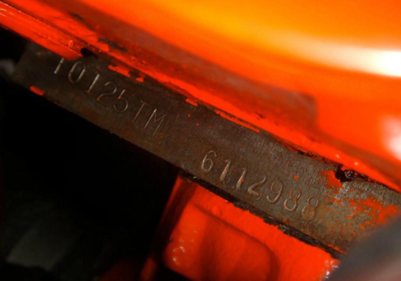

jv04, I posted it on NCRS site earlier today. That car has “sold” a few times, yet same seller lists it. I contacted the seller with the details on it being BS. Initially it was claimed to be a 100% legit ZR1. Hard to be even a LT-1 when it has L46 tach, and I know the history. The stamp being full depth, even after the block was decked (with rotary tooling), wrong font, not lined up, etc.
Its a car you can have fun with and it’s quick. Likely still has the 4.11 gears. Just annoys when trying to knowingly deceive people.
