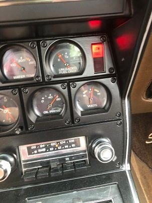

Being this old thread has legs again, curious how much fuel GM said is actually left in the tank when it lights up?
Here's when mine lit up.

When I repaired my low fuel module I also was curious when exactly the light came on. With a bone dry original tank with bladder I added 1 gallon at a time. When I finished adding my 3rd gallon and while measuring the 4th the light was on. There is about a 20 second delay before the light comes on my thinking is to compensate for fuel sloshing.

Thanks, I thought I was running on vapors at that point.

Can't say exactly how much but I once experimented by intentionally running out of gas a couple times. In my stock '79 I got about 15 miles of conservative city driving or about twice that at 55 mph cruising. In other words it means, "GET GAS NOW!"
