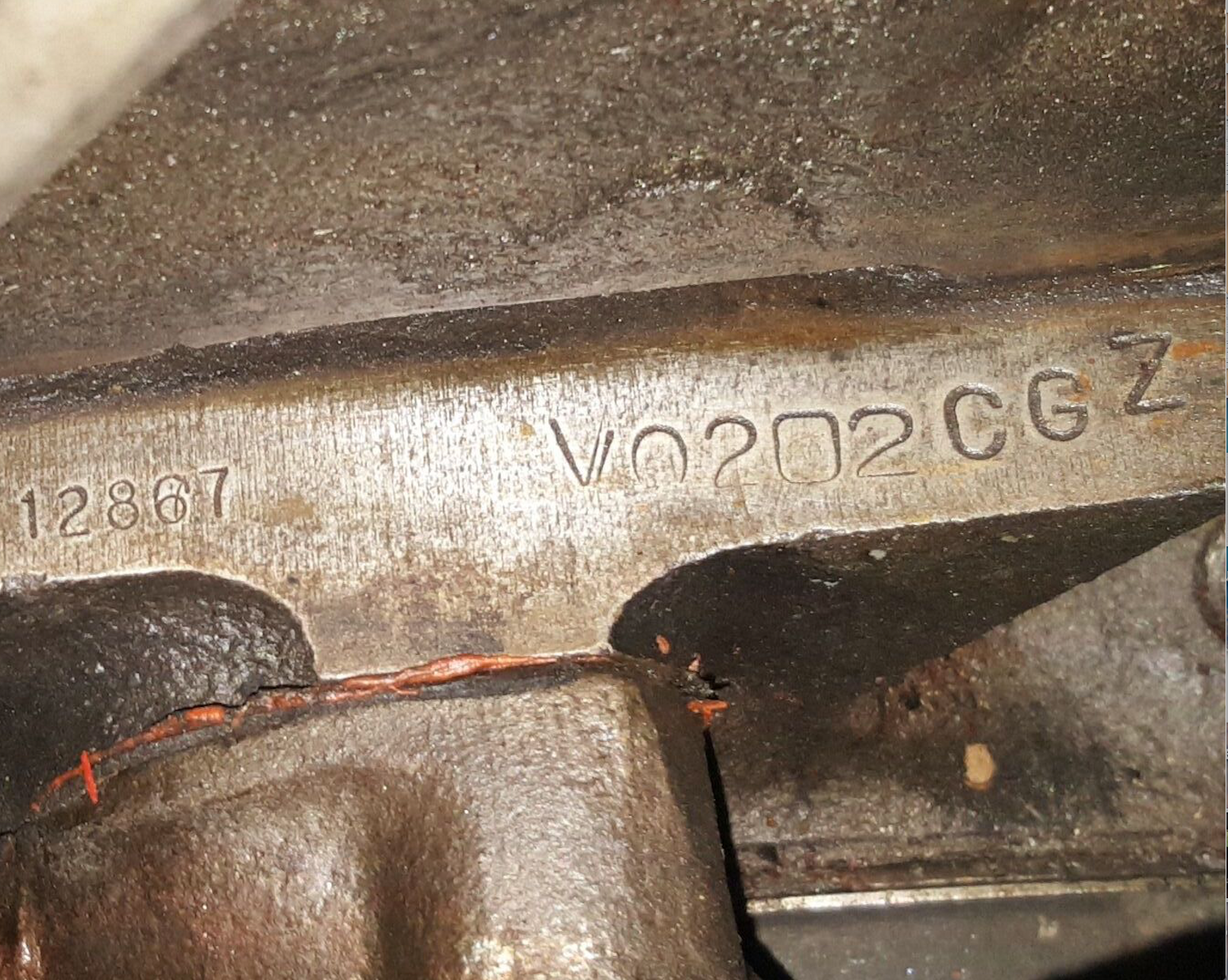

Default 1971 LT-1 stamp pad
Originally Posted by jhudec
Cannot tell anything with the paint on the pad. It needs to be removed gently with paint remover.
Paint removed...any improvement?

CGT is 350/270, auto trans, uncertain usage. CGI is a 350/330 ZR1 manual trans, and CGZ is a 350/330 LT1 manual trans. The Z in your stamp is way out of line for the gang stamp. You need a macro shot in high resolution that shows the longitudinal broach marks in the stamp pad surface to determine if the stamp has been messed with. My advice....run Forrest run.
See if you can get a resolution picture, in focus, then send it to me.

The first photo shows a legit stamp, IMO. The second appears to be faked or a restamp. The latter would need significant support documentation to prove its legitimacy.

I turned your pic ninety degrees. What do you see?

Obvious and poorly done forgery or re-stamp.

How is that any different than this one from another verified LT-1??

The font for the last three letters (the important part of the code which designates the engine version) are different than the prior letters/numbers. They are deeper stamped than the prior letters and they are not all on the same level. These codes were stamped in with a 'gang stamp' where the individual letters/numbers were inserted into a holder and the entire code was stamped with one good blow to the gang stamp. This same grouping was applied to the frame and to the transmission.
The engine code was put in one letter at a time, manually...and not very well, at that.

He was asking how the VO2O2 CGZ pad is any different from the other illustrated pad?
IT IS A CERTIFIED LEGIT PAD... the one you said is not legit with the individually stamped suffix code... is certified legit.

Who is the recognized expert who verified or certified it as legitimate?
