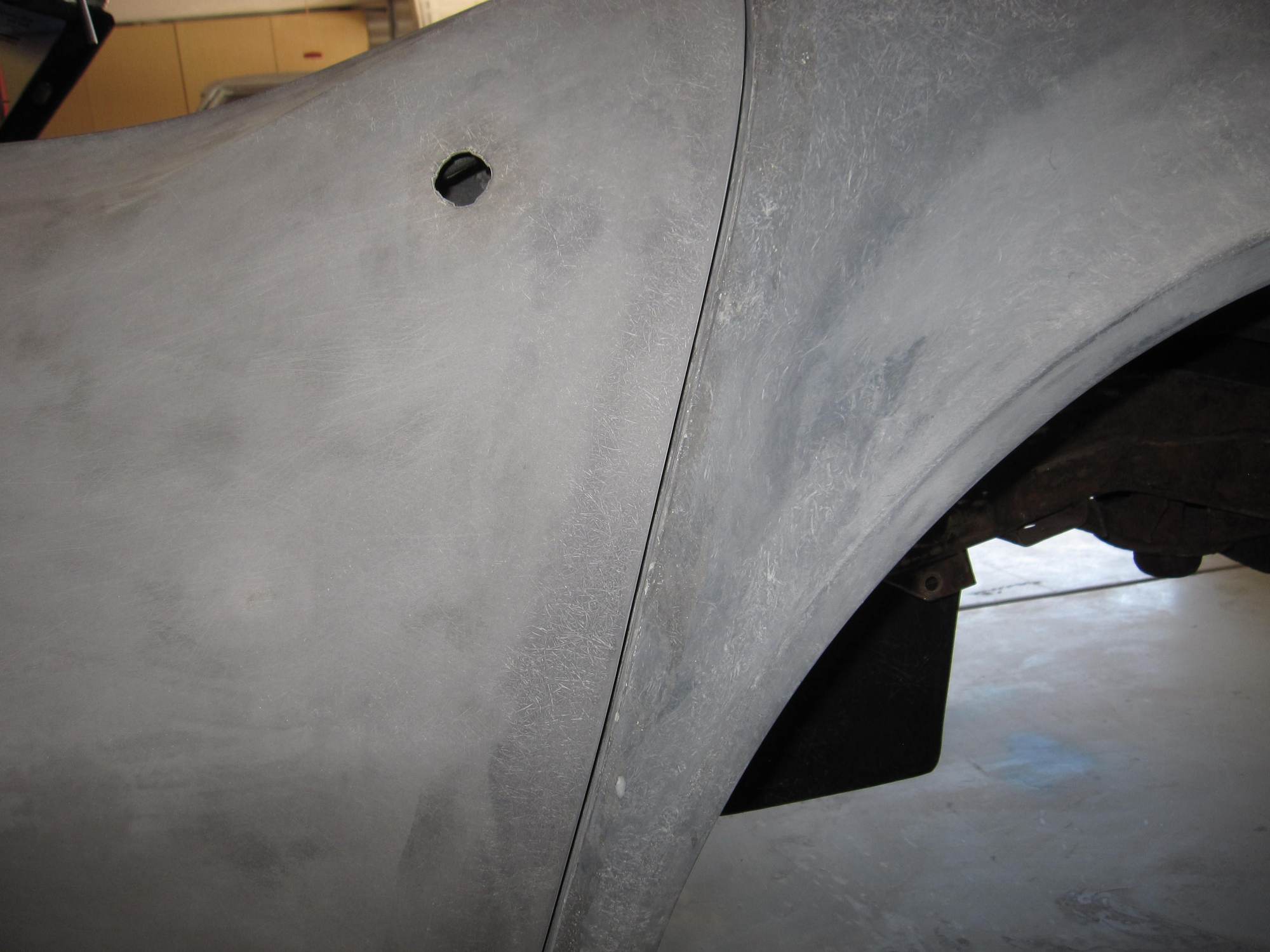

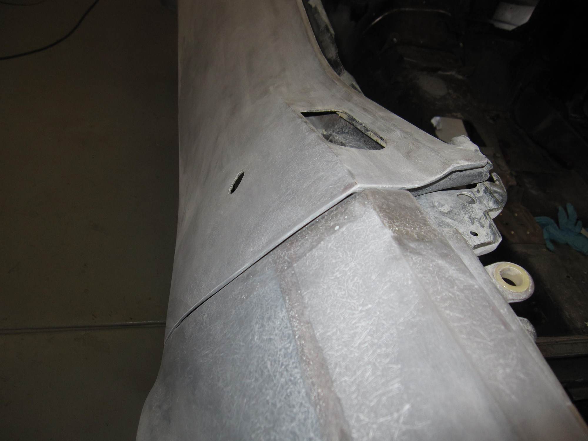

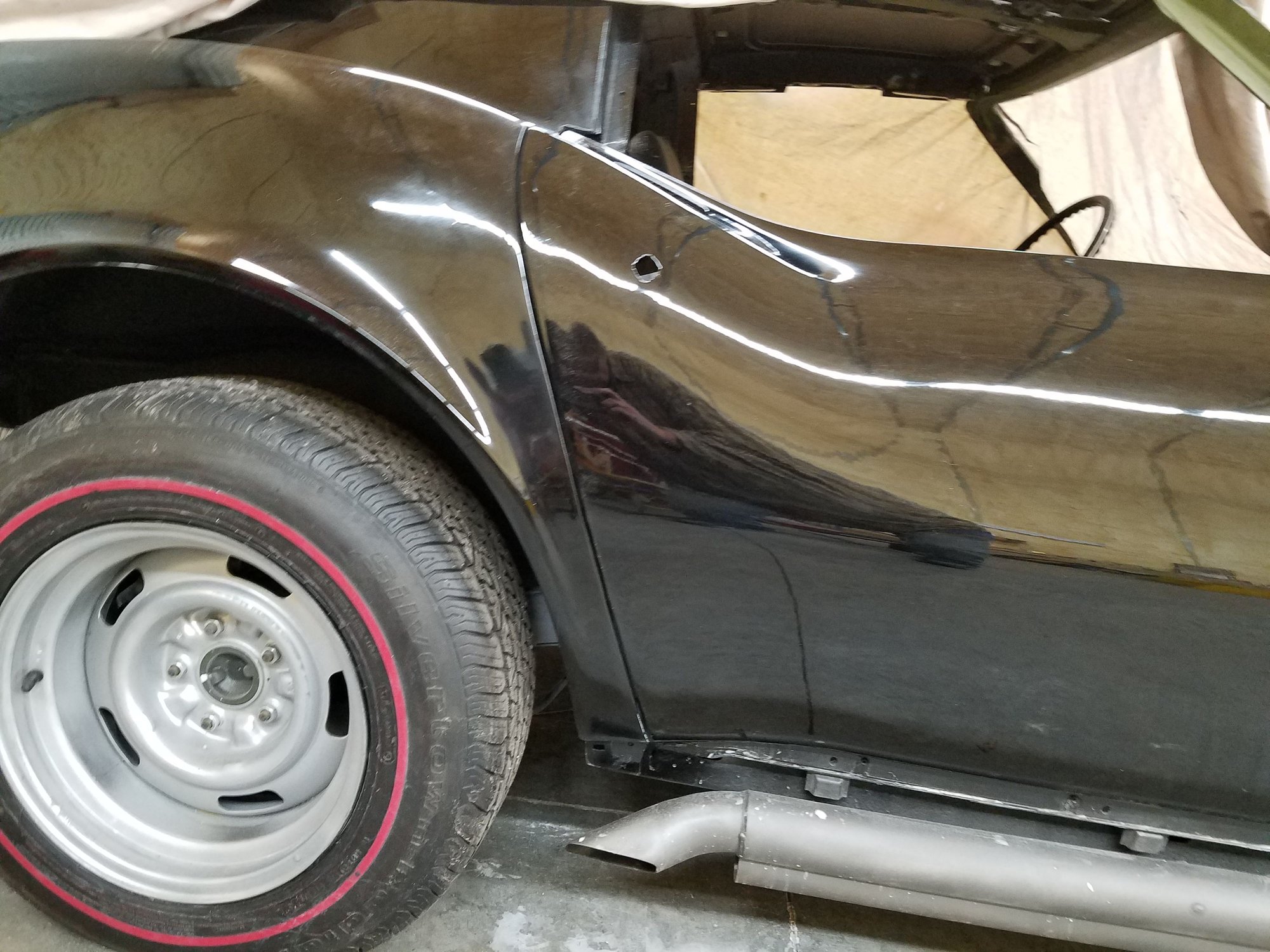

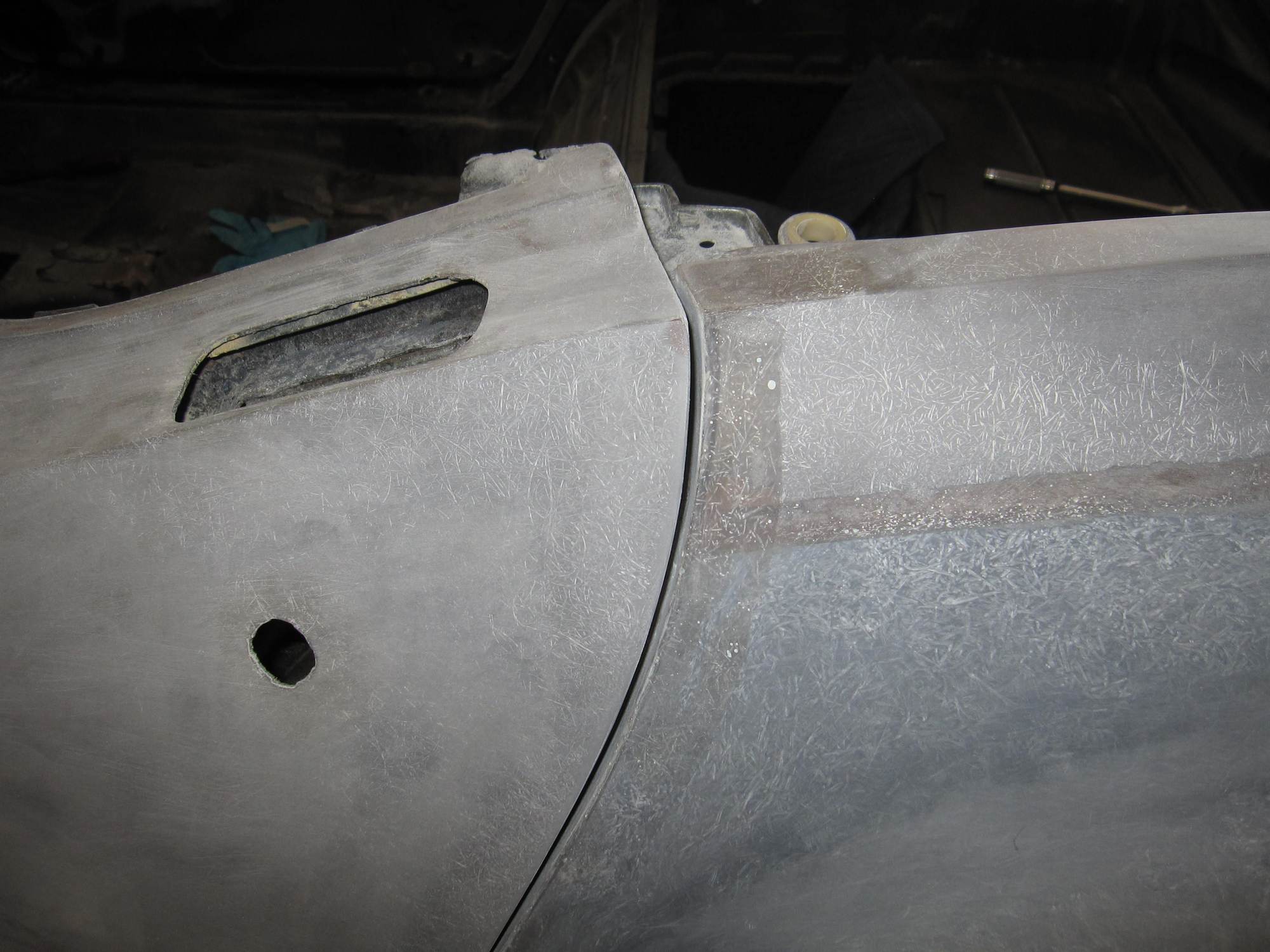

This is my 72 that I am working on and I set the gaps top and bottom at 3/16

Wow, very nice door gaps on the rear, 3/16, that's what I'll do, thanks Mike.
