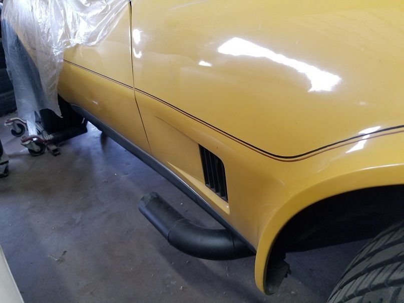

Old Aug 7, 2018 | 11:53 AM
Duke94's Avatar
Duke94
Posts: 6,640
Likes: 287
From: Ann Arbor Michigan
Default Gotta love sidepipes
Originally Posted by platinummaker
Hi Guys,
I will be acquiring my first Corvette, a 1972 Coupe very soon. Have always liked the way these Vettes look with side pipes, and I am entertaining putting them on the 72. Would very much appreciate any comments from those of you that have or have had these on your Vette, either the good, the bad, or the ugly.
Thanks,
Dave
I had the Hooker's on my 78'. Loved them. If you get the Hookers, be sure and buy some heat shields so you don't get "branded" getting out of the car. They get HOT.
