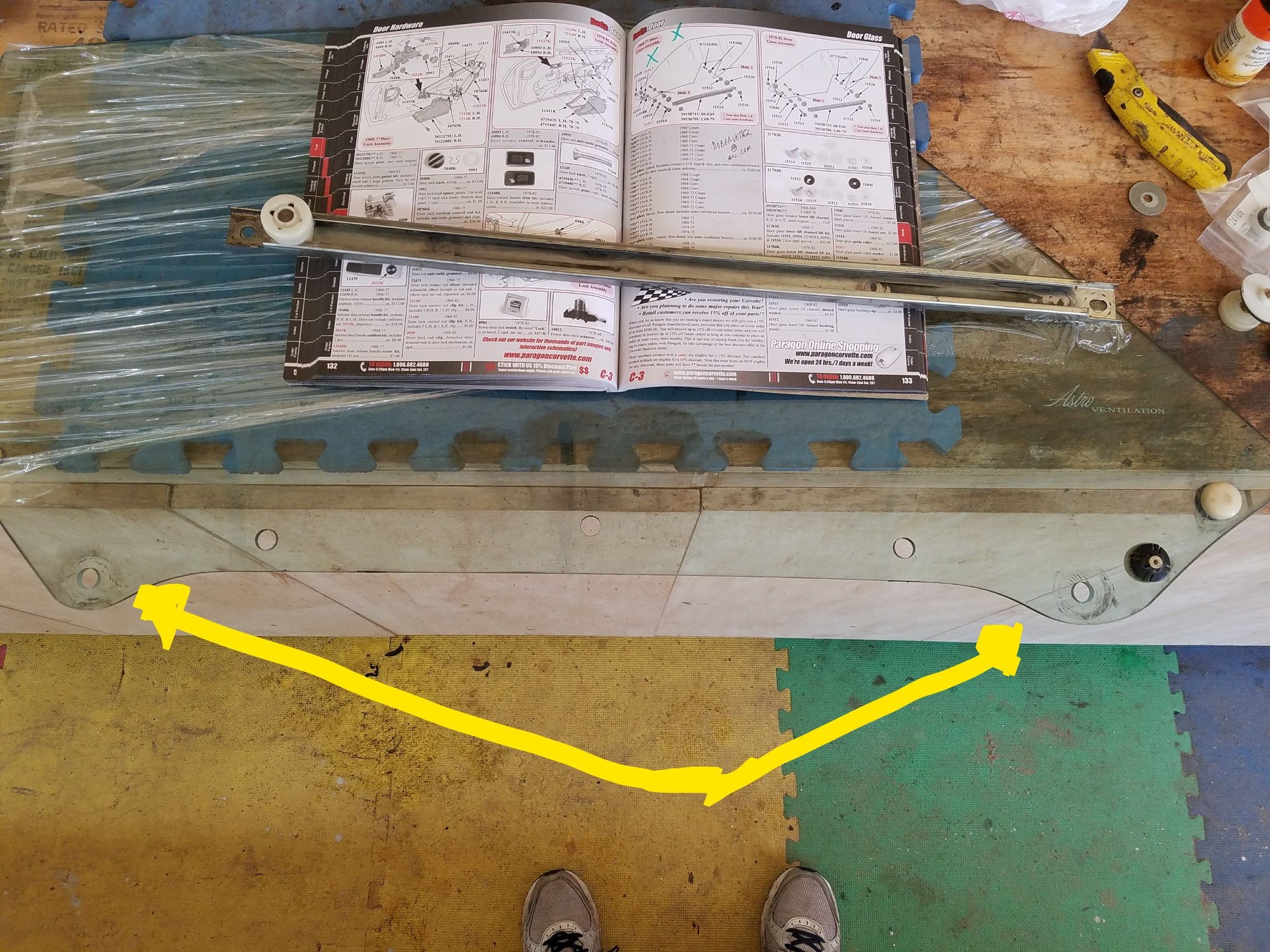

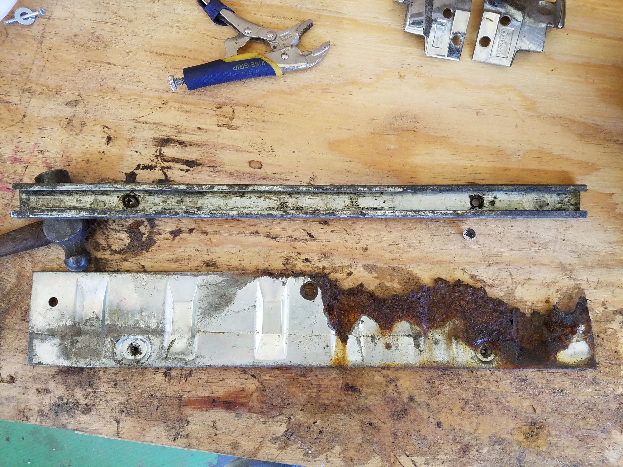

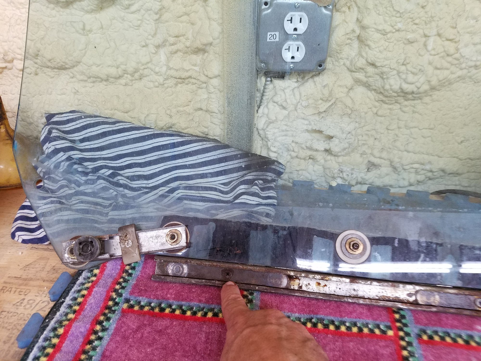

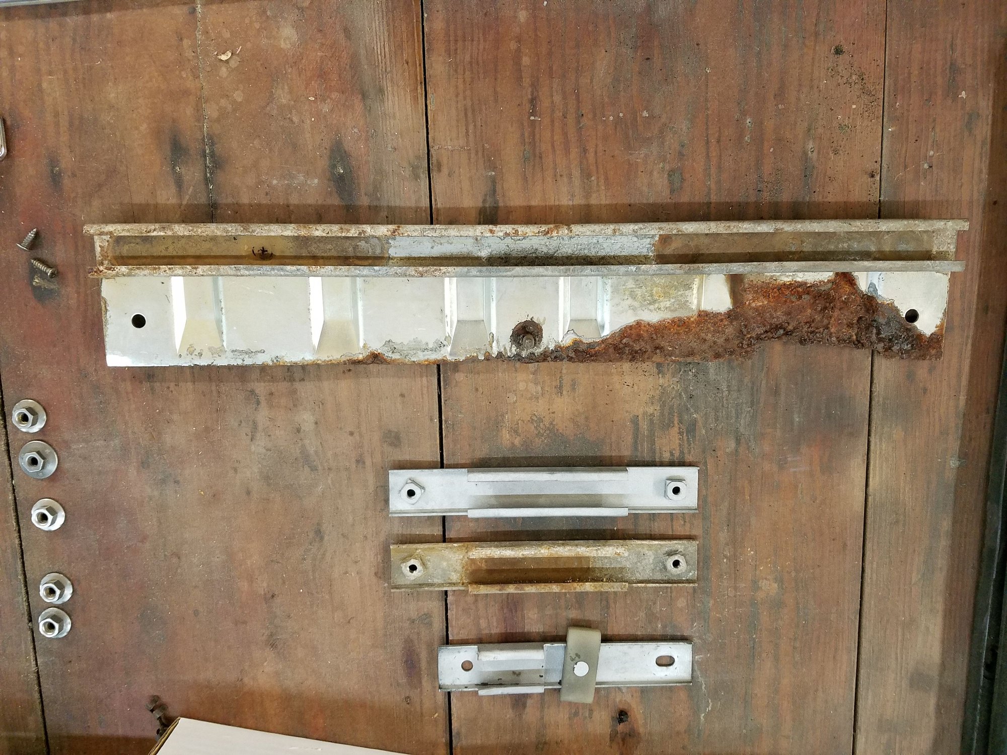

Removing the door glass on a 68/ early 69 was a part of the restore I was not looking forward to. The windows were also power and in need of new rollers on the tracks. The early design was changed for the later years. Anyway after replacing the items needing attention it was time to install them back in the door. I remember spending an entire Sunday (8hrs) and achieving nothing. Hopefully the metal attached to your tracks are not rusted out beyond repair. This design was changed for future years. After thinking about things I returned the next day and it took me 25 min. to do the entire job. I amazed myself.

Thanks for the pics. I have been dreding do the window mechanism. So far no rust damage. I wanted to fix the windows pror to removing the doors and then pulling the body off the frame. Trying to get all of the dirty work done before cold weather hits.
