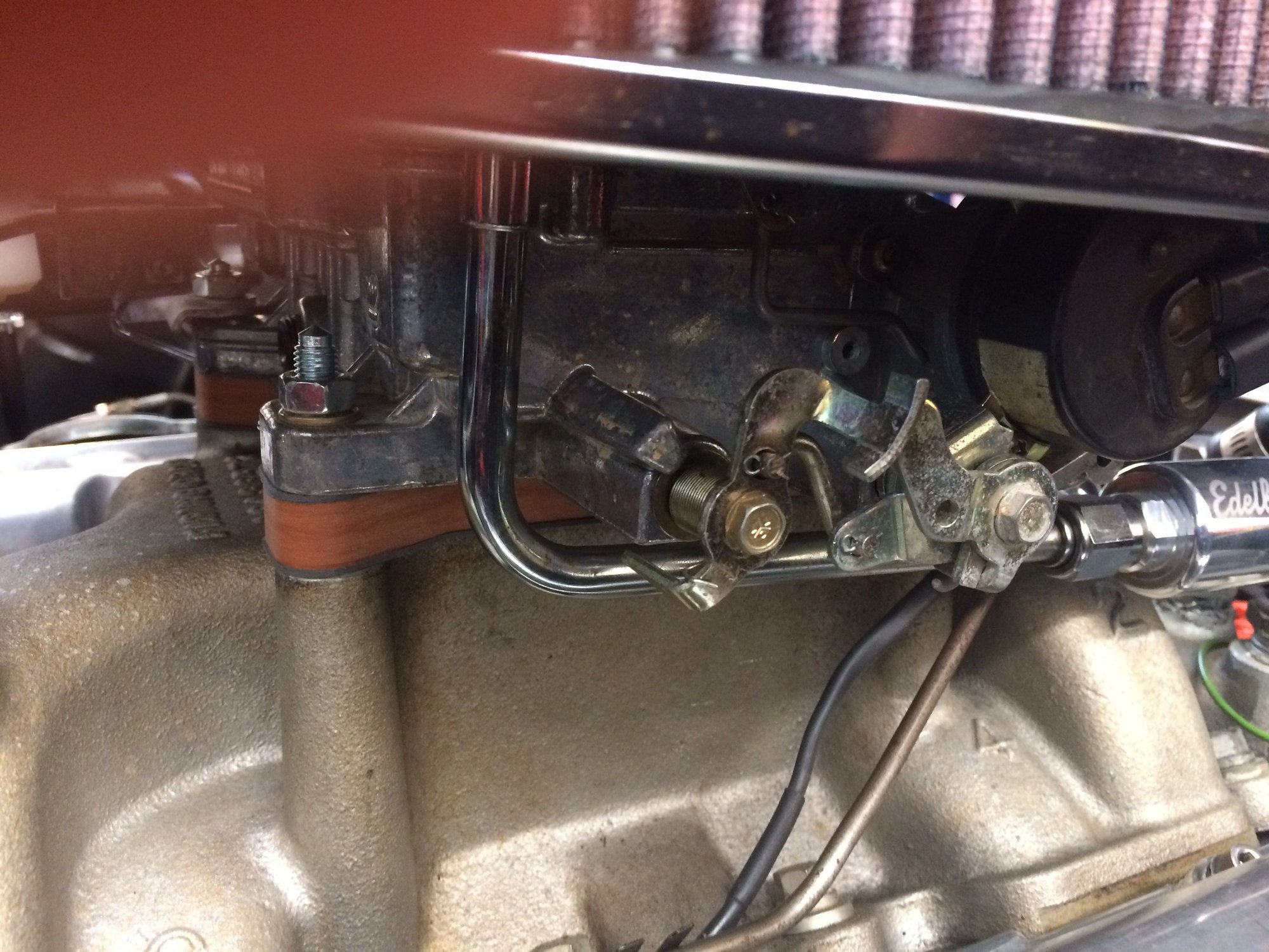

Follow what the folks here are suggesting regarding the phenolic spacer (see picture) and fuel line changes, and be sure to check hood clearance (clay method mentioned works well). It's all very good advice. Regarding getting more air, if you have the budget I'd recommend the K&N set up I have. The top is a filter as well as the sides which allows for more air flow (see picture). A bad coil could be part of the problem, but I don't think that will solve the problem you've described which most here agree it is fuel percolation/boiling. Also, a starter heat shield is a good idea. I made my own (see picture) however being in the aircraft/high temperature insulation business I have access to some specialized materials.

The photos posted above is one example of a better way to plumb your fuel line from the pump to the carburetor.

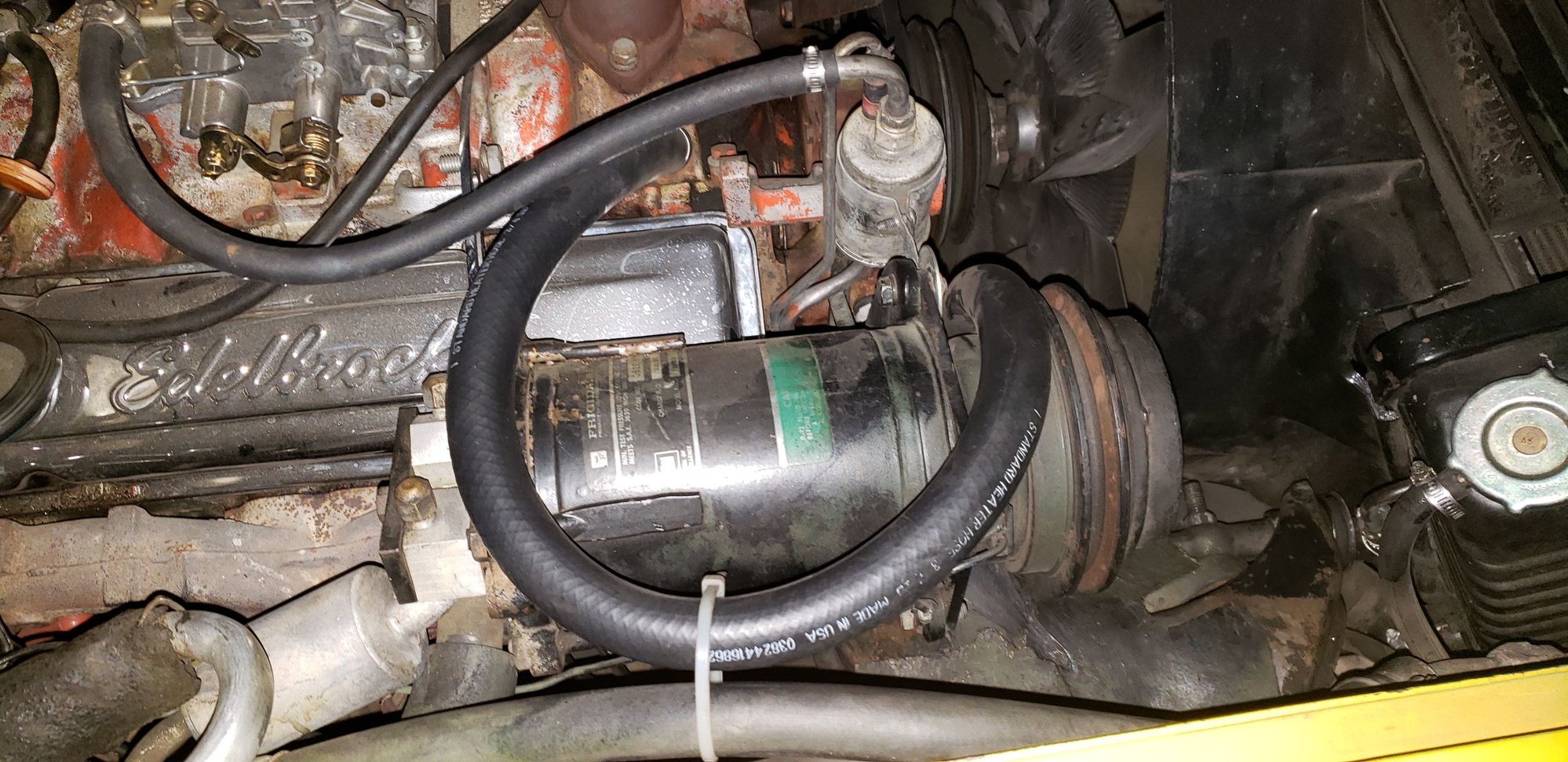

Wanted to run a potential solve by you guys. The fuel line is currently touching this heater hose. I touched it to see just how much heat was coming off the hose. It's scalding! Can't be helping this issue. I don't know where I would reroute the hose, though. My only thought is taking out the old AC unit, which isn't functional nor do I have any interest in making it functional one day.

Hey guys! So I bought some aluminized sleeving to potentially stop the vapor lock problem, in addition to moving the heater hose away from the fuel line. Check out photos below. My only concern is the sleeving may slip around. Otherwise, you guys see any potential dangers or problems with having it that close to the carb?

If you are going to keep that non-original carb, you should do as others have suggested and replace that rubber fuel line with a metal one. Does not have to be stainless steel. Find a parts shop that will bend line for you, buy a new (factory replacement) fuel filter and have a metal fuel line bent to go from your carb directly to the fuel filter - in a straight, L-shaped path. That will keep it from touching the heater hose and will minimize the chance of fuel leakage and fire that you currently have. That heat wrap is a band-aid approach to solving your problem.
