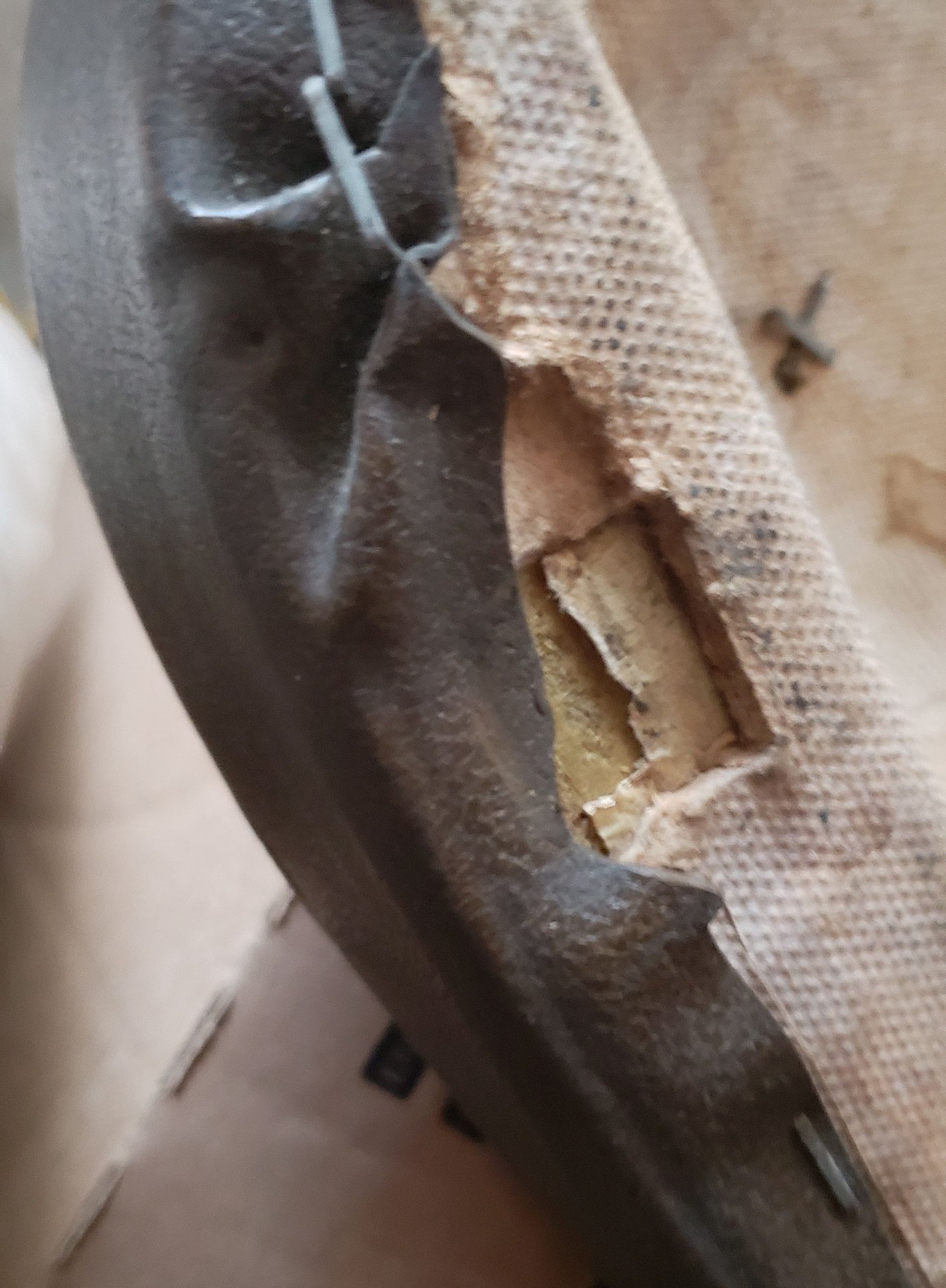

The extra screws makes sense. I may have to come up with an attachment method on my own. I have included a couple more pics so you can see what I'm dealing with. There is no place to attach the clips. The picture is of the low rear of the door. As you can see nothing to attach clip to. The other side I doesn't even see an indent in the foam. Any other thoughts, would be appreciated.

Thats easy. Since its on the bottom and you'll never see it just add a new slot right next to the original location and drill new hole to attach. Also you can add extra clips if you have other problem areas of the panel not being flush.

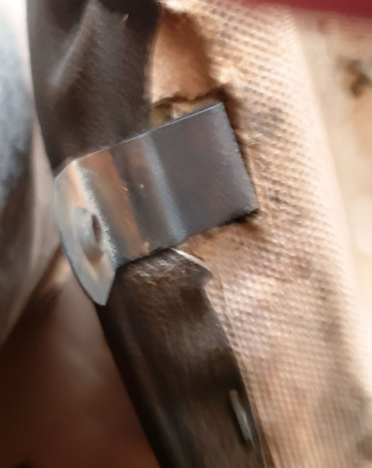

So your saying cut a slot in the foam and slide the clip in and behind the foam?
I apologize. I do't know how they were originally attached.
I think I have it figured out.
Thanks a lot guys!
