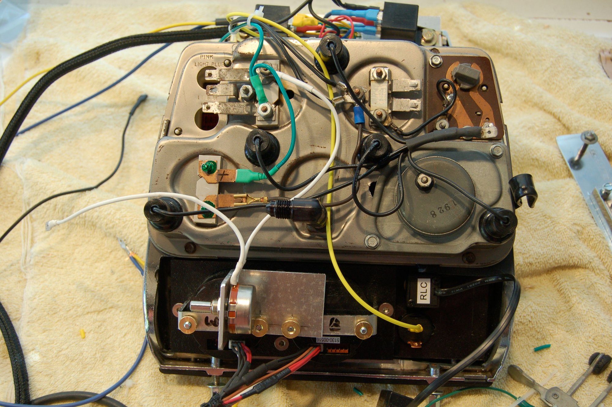

If you are not worried about NCRS judges peeking behind your cluster, you might consider ganging all your lights together and replacing all your sockets. I found some nice ones on Summit. Having all the bulbs in place (and tested, don't forget that) makes re-installation a lot easier. I made sure the one necessary connection (the spade connector) was easily accessible on the gauge cluster and the speedo as well.
