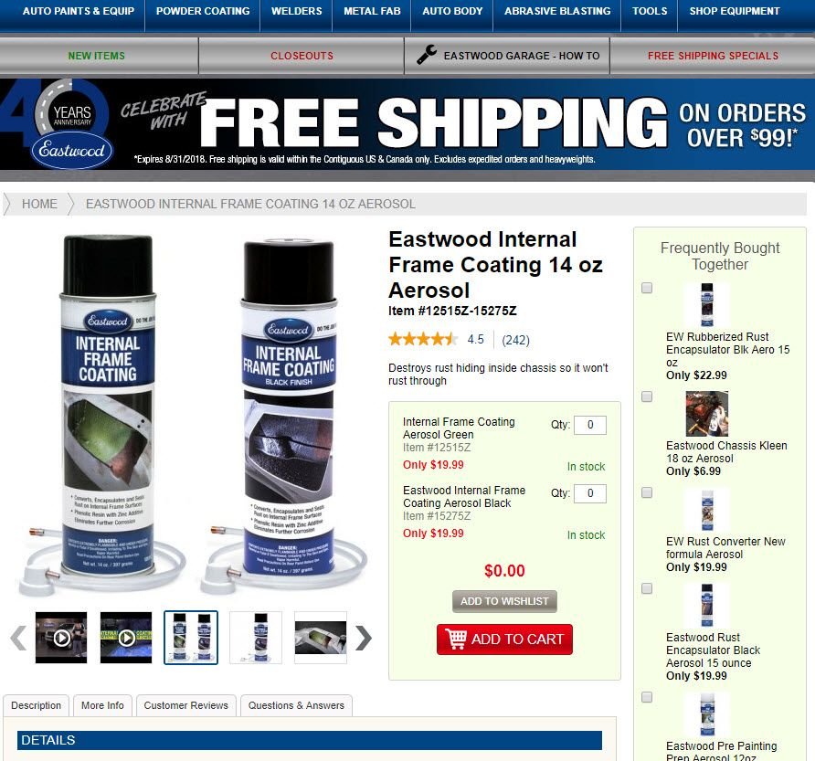

And if I might also suggest one additional consideration to Terry's post. If you do clean it and powder coat it consider blowing out the excess powder before coating, AND consider using a internal product like Eastwoods Internal Frame Coating. I have used it on my frames and love it. I hope it is okay to share this here, there may be other products as well, I just am sharing this one because I have used it and know it works well for me.David
