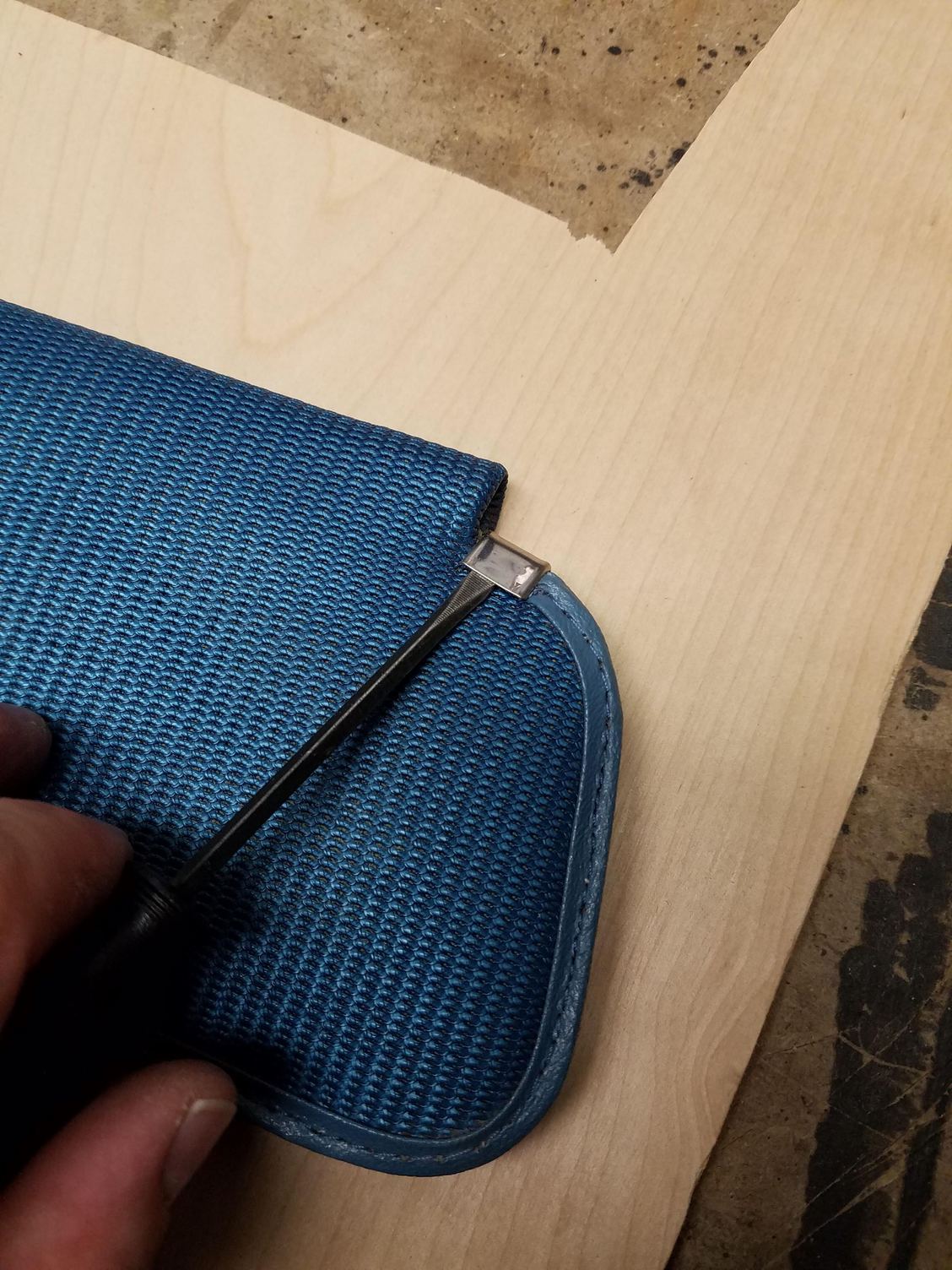

First step was to remove them from the car, then pry open the four little stainless steel clips that secure the ends of the edging material.

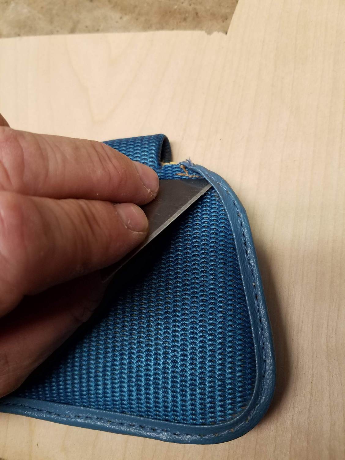

I used a razor blade to cut the thread holding the edging.

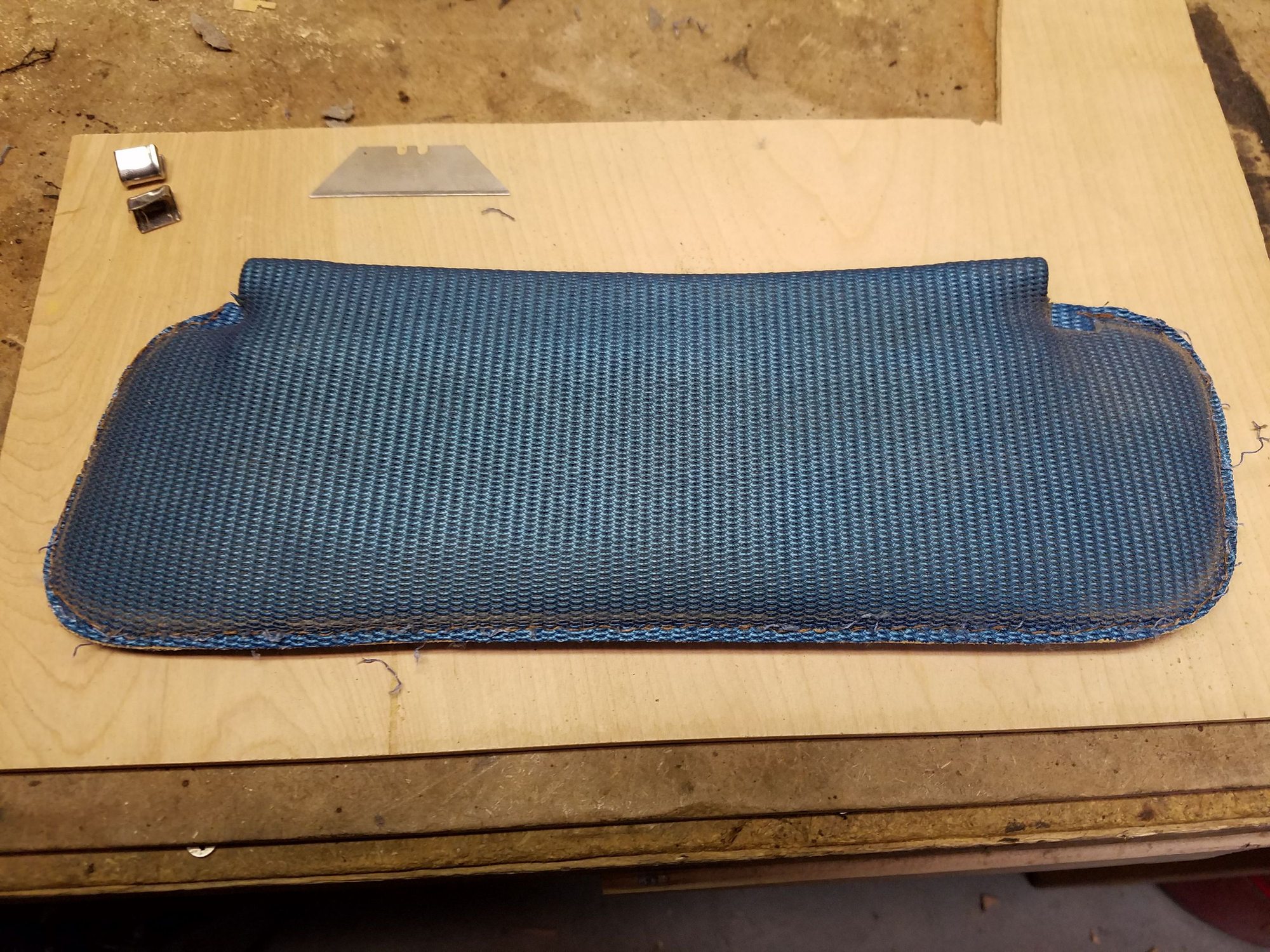

Once the edging was off, I could see that the comfortweave was also sewn together, so more work with the razor blade.

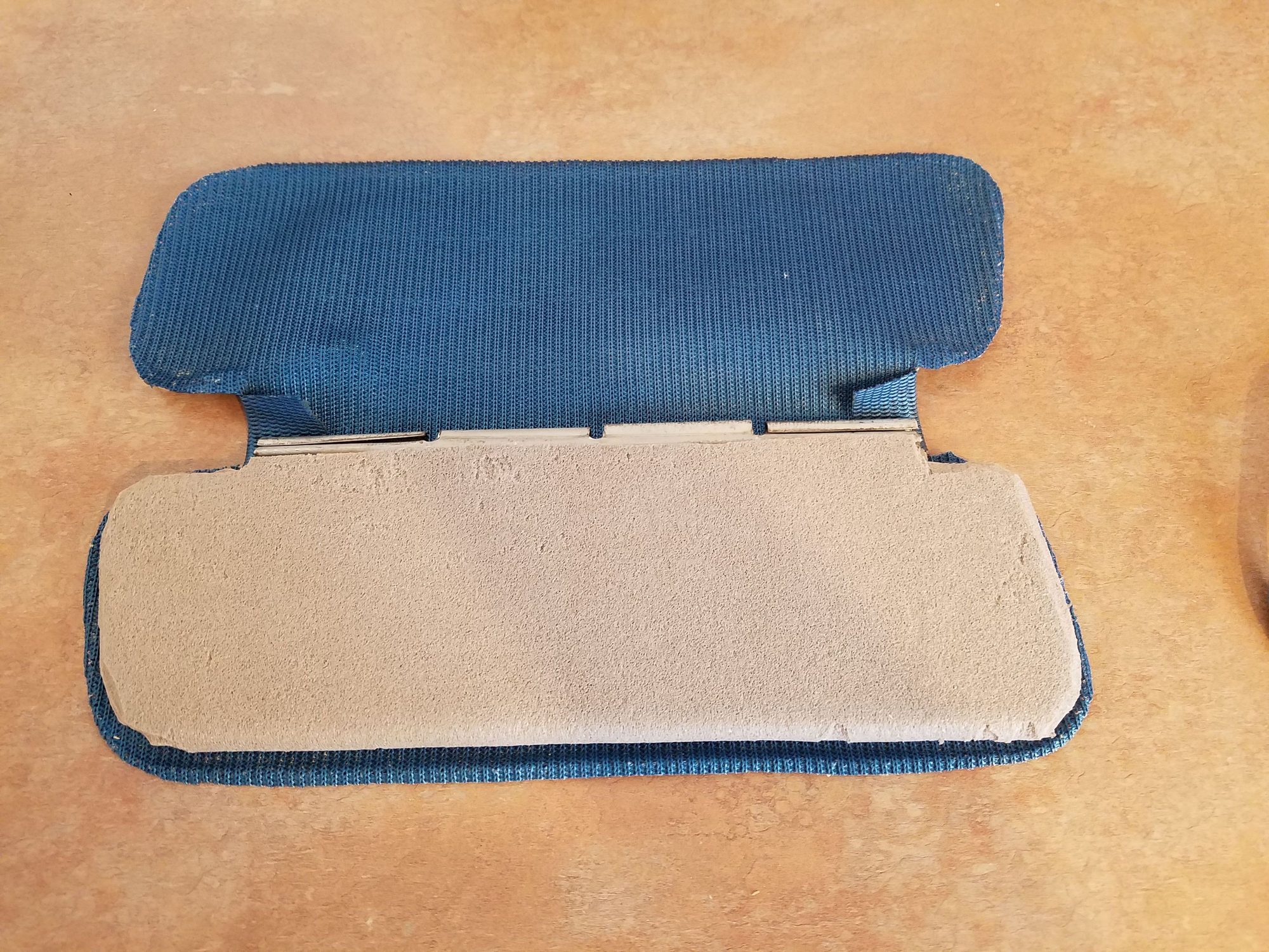

Here's what 50 year old foam looks like.

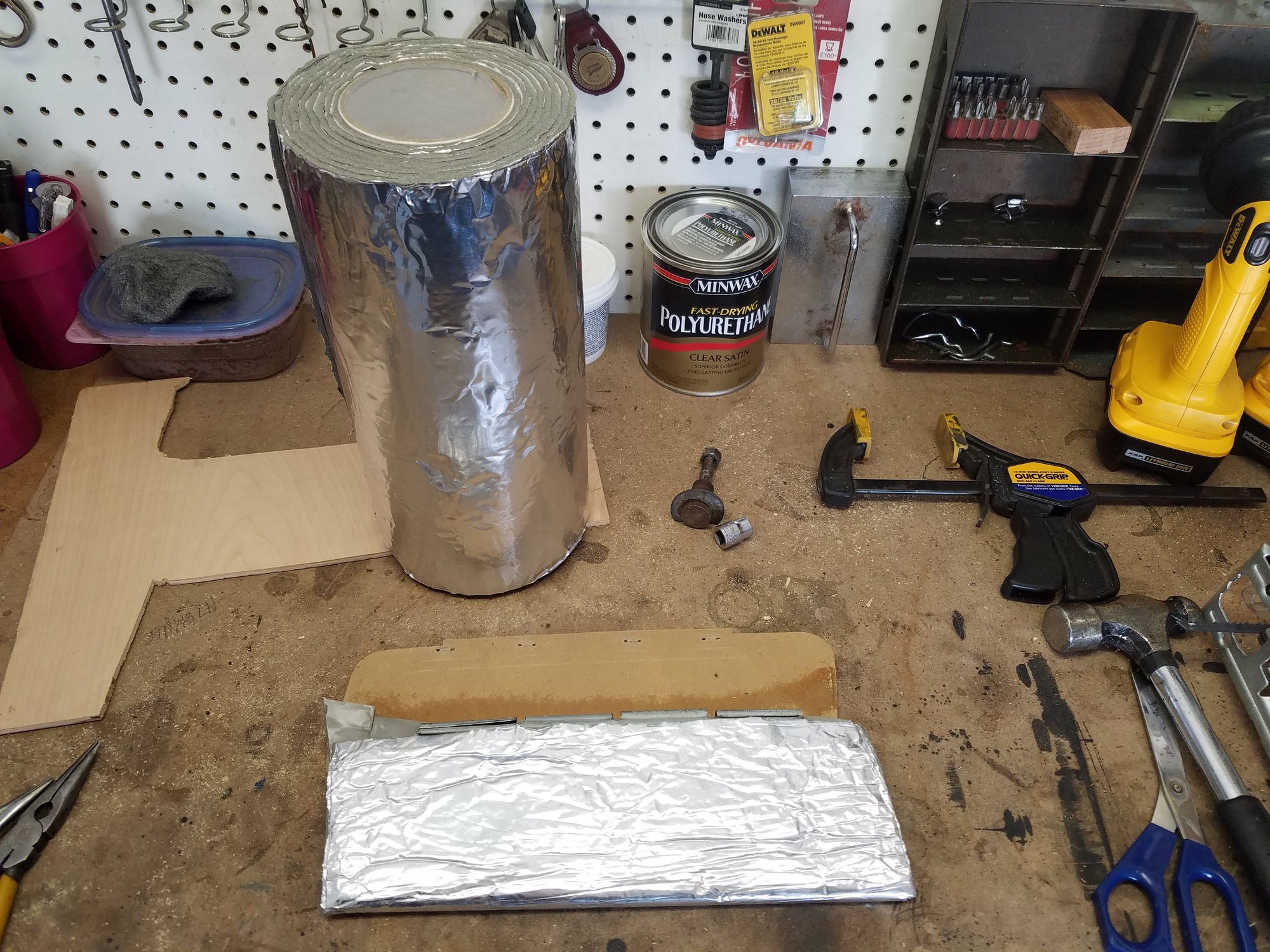

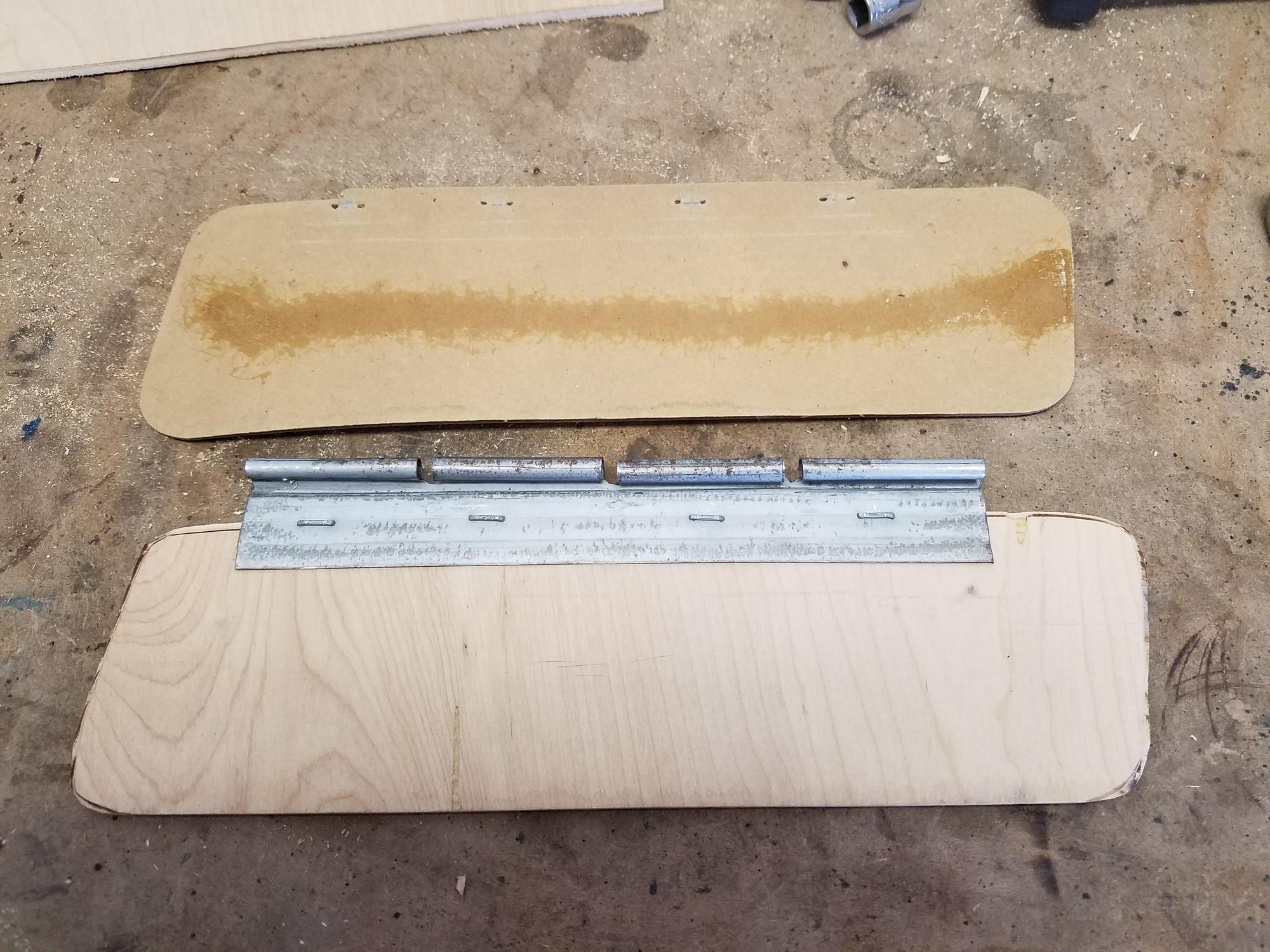

The foam is formed around a piece of cardboard/mdf material. I wanted something a little better and I happened to have some veneer-type plywood laying around, so I used the original piece as a template and cut out replacement pieces. The metal piece that holds the chrome rods was stapled to the cardboard with some heavy duty staples. I didn't have anything similar, so after I removed them all, I straightened them with a combination of pliers and my bench vise and then reused them to secure the metal piece to the plywood.
The bench vise also came in handy to force the staples through the original holes in the metal and then through the plywood. I used an appropriate sized socket on one side to allow the staples to pierce the wood and not hit anything.
Next, I replaced the foam with some Frost King product that I also used to insulate my floorboards when I replaced my carpet. It's adhesive on one side, so I wrapped the plywood with it, then peeled the foil off of it.
A little trimming with scissors, and it's ready to be put back together.

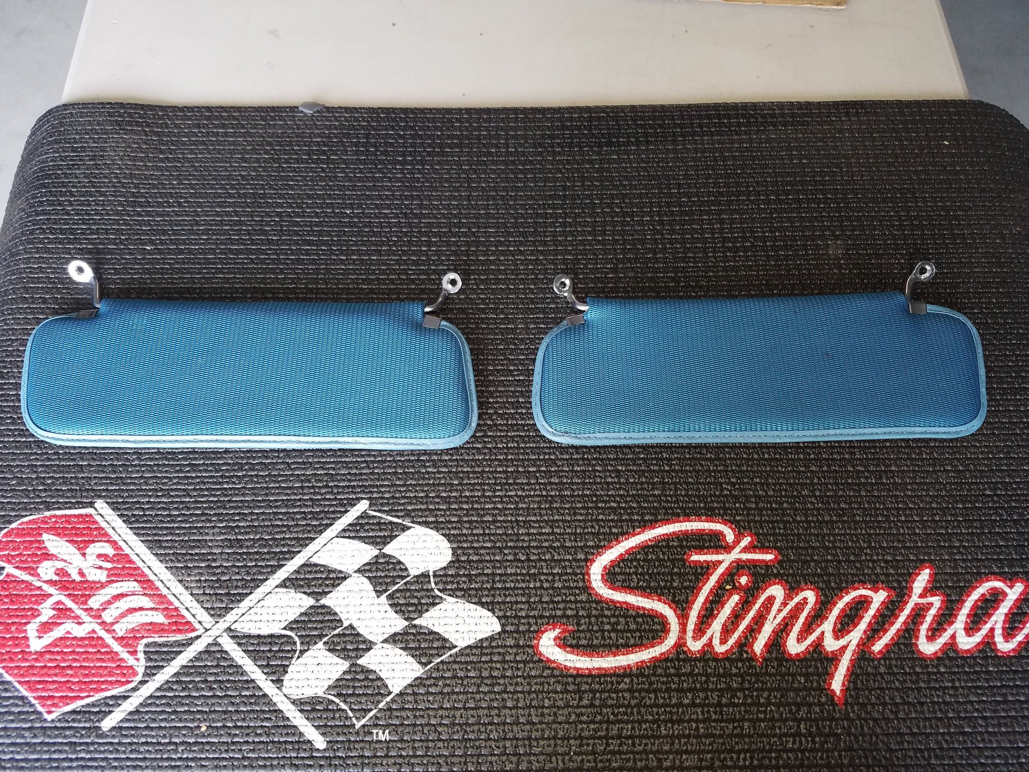

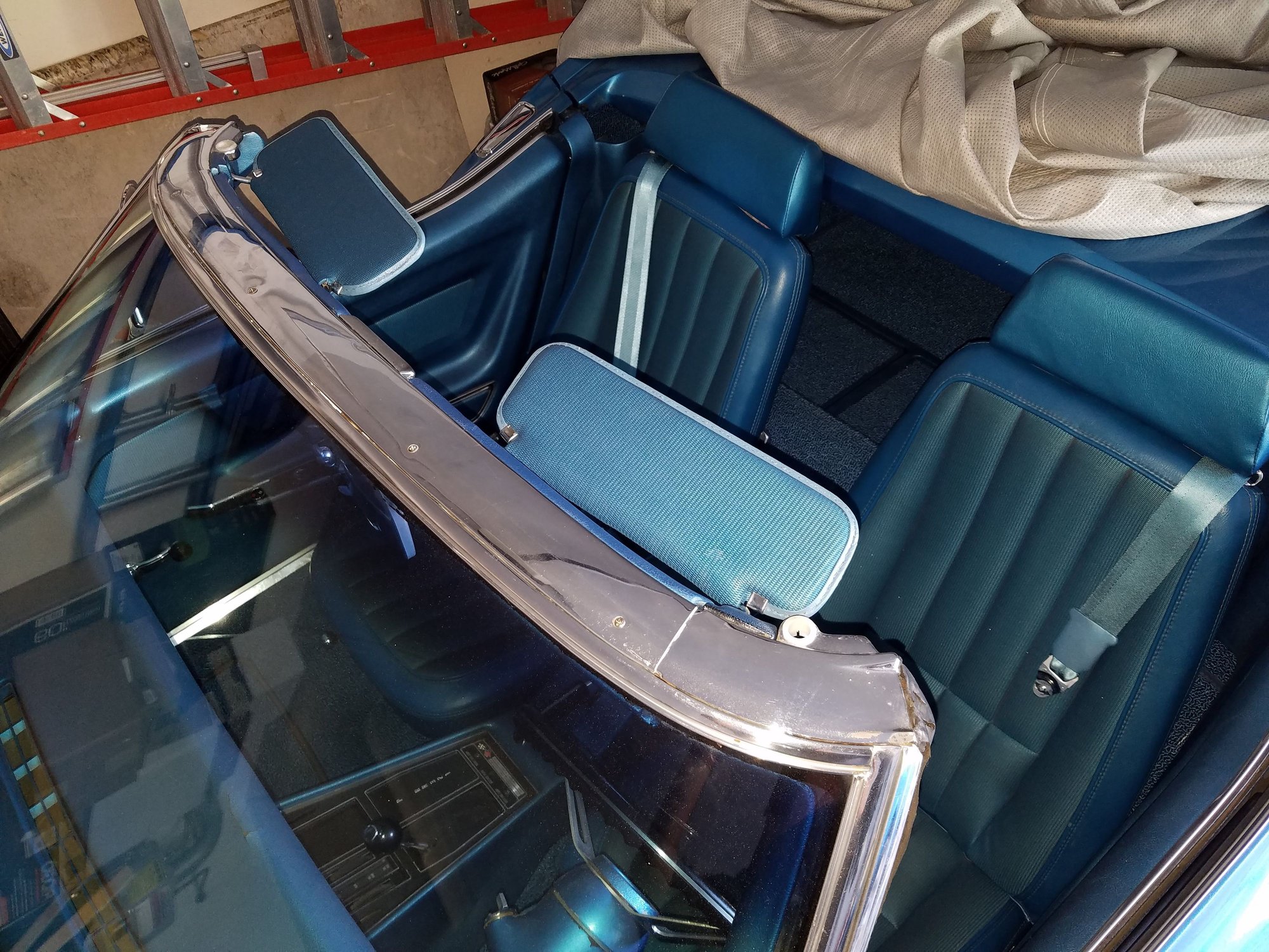

Here's the finished product plus a shot of them installed again.

I did take the time to bend and/or straighten the metal pieces that the chrome rods rotate in. Just forgot to mention it.
Mine were a little out of line, possibly due to the flexibility of the original mdf/cardboard pieces. I secured the metal piece in my bench vise and kept a screwdriver of the appropriate diameter inserted where the chrome rods fit while I worked on massaging them back into shape.
