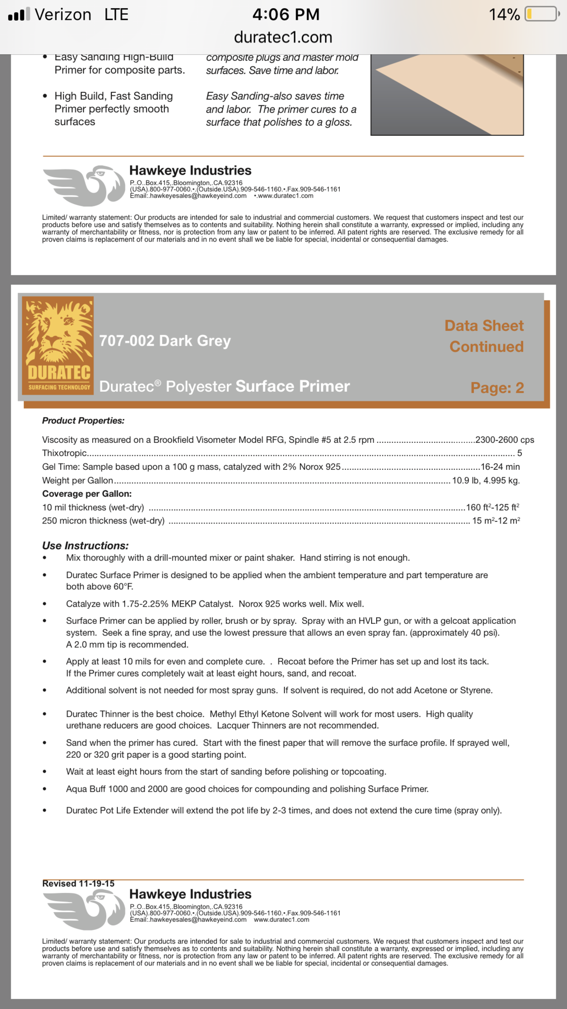

Many factors that will determine shrinkage in polyester, tempature, amount of hardener, how thick it is applied. Easy example kick off a quart of gelcoat at 1%(10cc per quart) and one at 2%(20cc per quart) weigh them after. The shrinkage will vary. If you spray some gelcoat 20 Mills thick, and you measure that thickness after it is fully cured, it will be different.

http://duratec1.com/pdf/DS%20707-002.pdf
when I use polyester primer, this is what I use, they also make a high build. Notice they give both wet and dry coverage?
