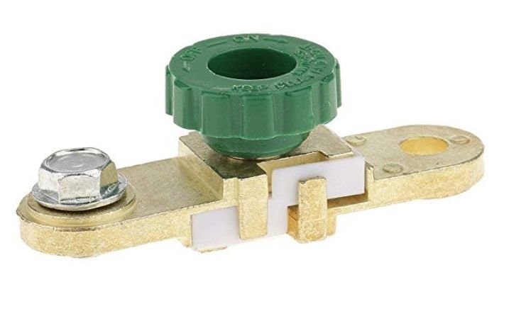

I must be losing my mind. I am mechanically inclined (as least I thought I was) and I can't figure out how this damn battery disconnect mounts. UGH.
https://www.amazon.com/gp/product/B07944H3J8/ref=oh_aui_detailpage_o02_s00?ie=UTF8&psc=1 https://www.amazon.com/gp/product/B07944H3J8/ref=oh_aui_detailpage_o02_s00?ie=UTF8&psc=1
I presume the existing negative cable mounts to the threaded side? If so, that means the non-threaded side mounts to the battery with the bolt that came with the disconnect?? The problem is that the bolt that came with is not long enough (tried two different batteries) and BTW, it came threaded into the threaded side of the disconnect. Am I doing something completely wrong, or do I just need to pickup a longer bolt? I am taking the car to an NCRS "mini" judging show tomorrow and would prefer that I not look like a total moron. LOL.
Thanks in advance for your help!!!

on mine the threaded half connects to battery cable. The bolt and non threaded half should go to the battery.

Don't feel bad, I gave up after 15 minutes of putzing with that thing too. Not much clearance for it either with a side mount battery. I guess I'll try again....

I had the same problem with the side terminal switches. Had to use a longer bolt with a washer to take up some space, as the longer bolt would bottom out on the battery terminal and the switch was still loose.

I used one like that for several years and I had to grind a longer bolt down to make it work on the batt side.
After scratching the crap out of my had for the umpteenth time trying to reach behind the battery I finally switched to a knife blade style one and haven't looked back since

yes. grind or file it down. its easy, soft metal

Ive also done this from another forum member. when you turn the **** the 2 pieces come loose but can still touch if they flop too much.

I use a longer bolt that is completely threaded. I screw a nut all the way on to the bolt head. I tighten the bolt until it bottoms out in the battery, then tighten the nut against the disconnect. Definetly not the best set up but I had several disconnects already and it does work.
