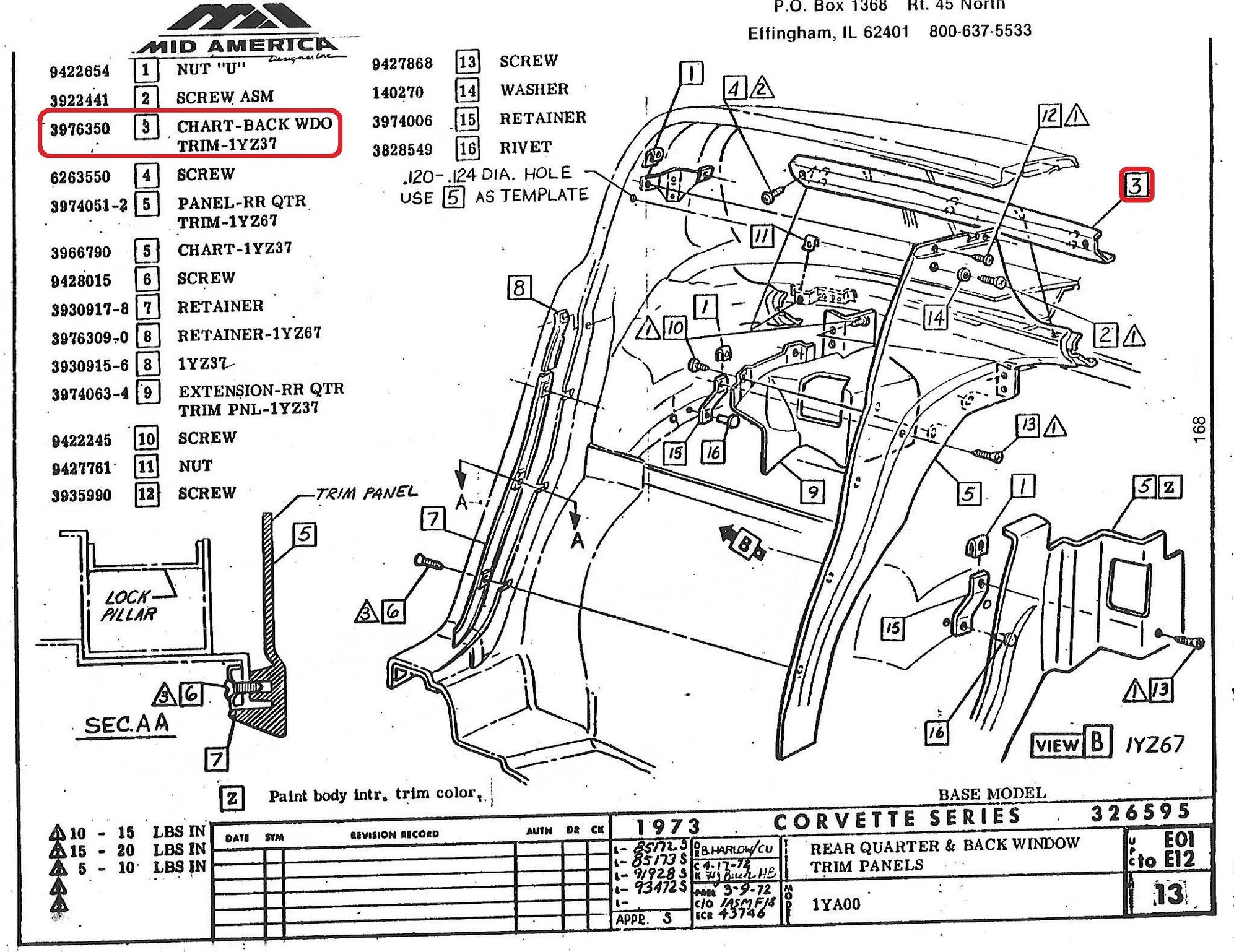

In the diagram, Item #3, the lower rear window trim piece: Does it come from the manufacturer dead nuts straight, or is there a shallow bend in it?

It is supposed to have a slight curve to it.

The broken one I removed from my '73 and the new one that replaced it were both curved.

I don't really want to replace it, as it's an original part and is in pretty good shape. It does reshape well with judicious use of a heat gun, so I'll fit, bend, fit, etc., until I come up with the right fitment.
