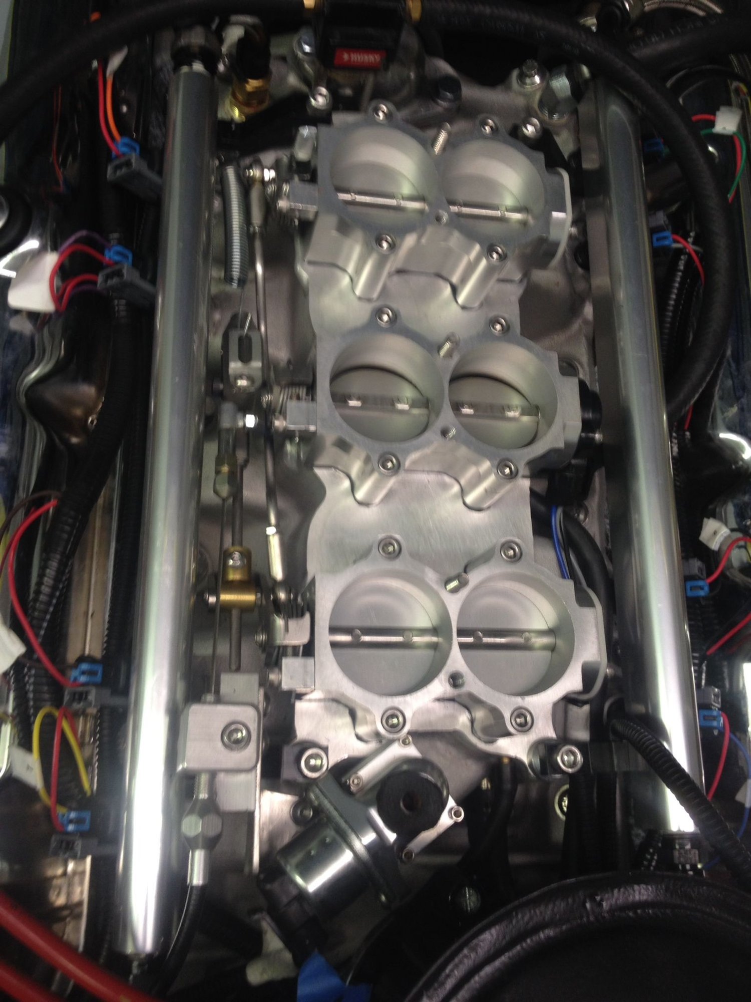

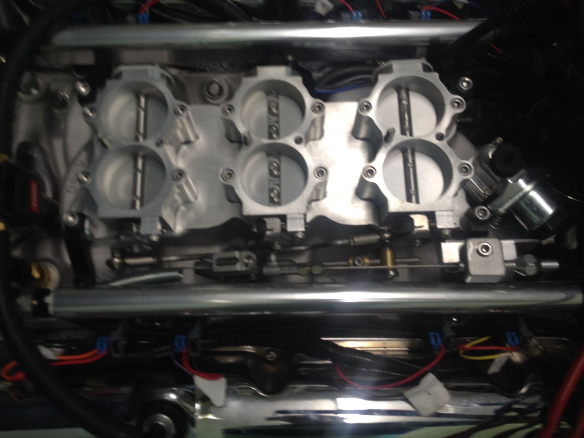

My "six pack" - 3x2 EFI on a 496 big block.

3x2 efi? You put 3 TBI units on there? Could be some big fun! Got a pic without air filter? Nope, I see a fuel rail and injectors. Just tb's... No i. Still wanna see a what is under the air filter...
Custom made by Bruce at FB Throttle Bodies. He does lot of Mopar EFI conversions. My manifold is based on an Edelbrock Dual Quad, welded up and machined for three throttle bodies. End bodies are on a progressive linkage. All run by a FAST XFI.
