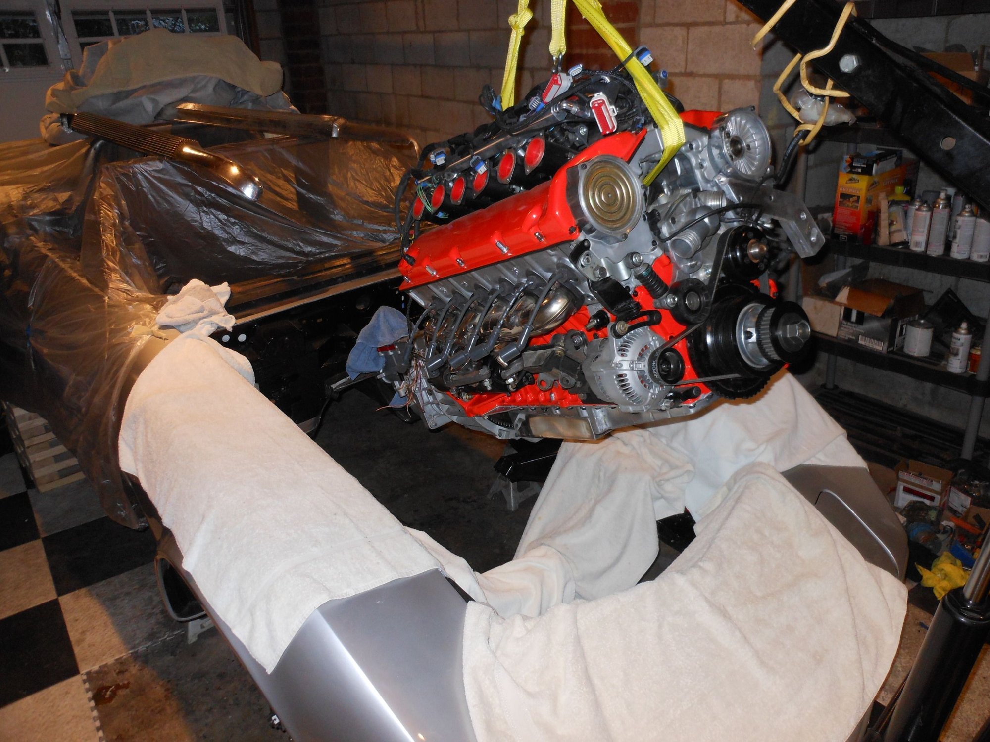

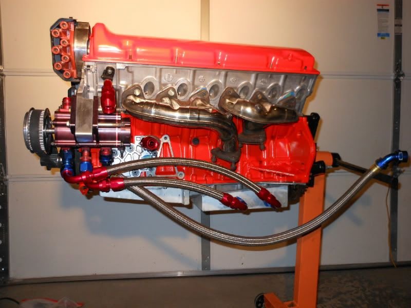

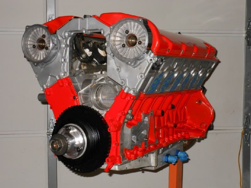

HA- I don't think Summit or Jegs has mine-
Going in my 71 which originally was LS5 4 speed convertible
BMW V12
All Aluminum-painted Chevy Orange!!!
Stock had 326HP and 360 ft/lbs
about 328CI
10:1 Compression
Dry sumped
Custom Oil Pan
Individual Throttle Bodies
Custom intake runners

i enjoyed your build thread.
you have some fab skills no doubt.
even the nasty bmw in a vette factor was ok since it is a 12 cyl

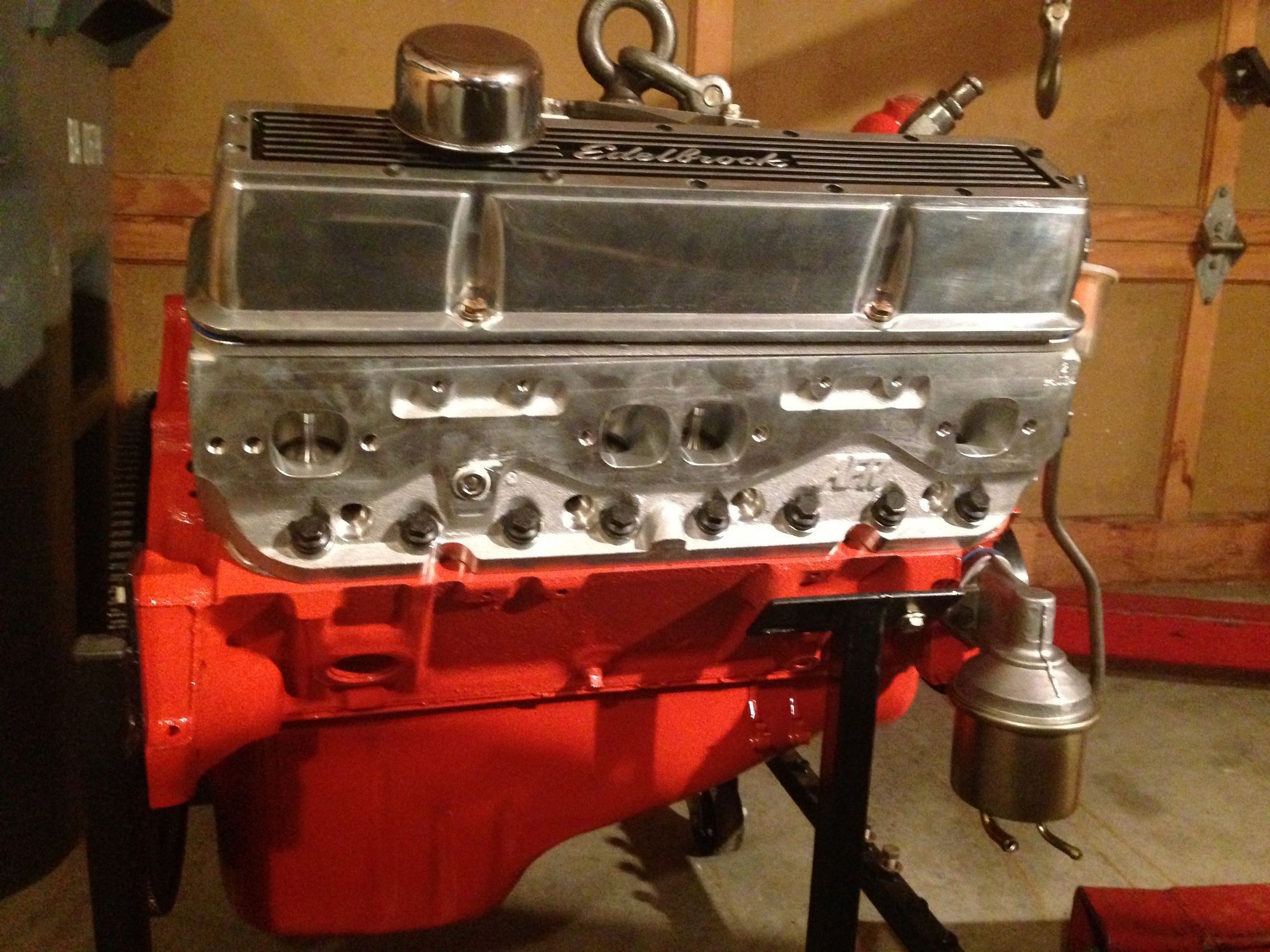

Default Little 355
My rebuilt L48 . Motor was a total rebuild with .030 overbore . stock crank and rods with new pistons . AFR 195 heads , Comp HR 288 cam , Vic jr intake and Quick fuel 750 carb . Distributor has been replaced and fuel pump has been upgraded . Long tube headers and full true duel exhaust .
Car is a 75 with rebuilt trans , spicer u joints , new 3.55 rear diff . brakes and suspension also all upgraded .
Nice little combo best time 13.1 at 105 mph . Hoping to see times in the 12's this year

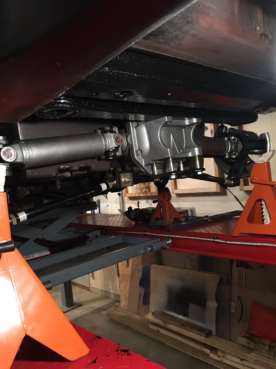

Originally Posted by Alan 71
Hi,
On the stand!
In.
Make it pretty.
Regards,
Alan
correct placement of jackstands

Default Way to go Alan
Attention to detail is the mark of a superior mind!
Hi, On the stand!
I say it all the time, goes to show what a properly built 355 can do and, in spades! With 3.70's you would be in the 12's...........................

Thanks JB . Just need to run at sea level and I would be there

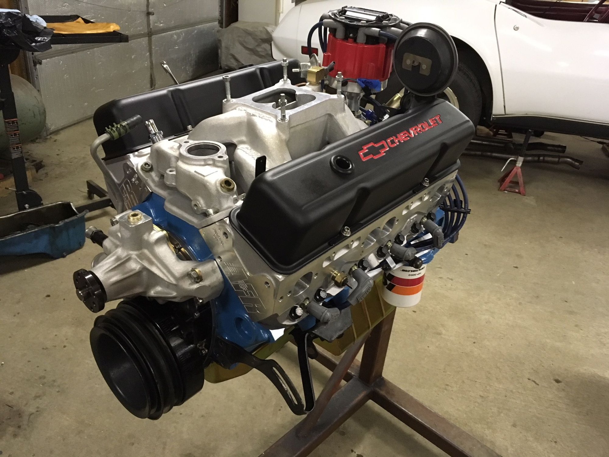

My original '70 L46 350 block, bored .030" over, stock forged crank and pink rods, polished and resized, Dart SHP 180 aluminum heads, Weiand Street Warrior dual plane, sealed power hyper pistons, ARP fasteners, Howards retro roller, Scorpion rockers, roller chain, billet timing cover and fabricated valve covers. High-torque mini starter, completely rebuilt and re-curved original points distributor, rebuilt and tuned original Quadrajet carb and Doug's 1-5/8 long tubes with 2-1/2" duals, H-pipe and Flowmaster 40's.
I wanted an ultra-reliable driver with good street manners. 9.8 compression and it's all done at 5800 rpm. It dynoed at 392hp and 413 lb.ft and i am running a wide ratio Muncie with McCleod Super Street Pro clutch. Rebuilt the driveshaft, and just today finished installing 3" half-shafts and Bilstein HD's around the new offset arms and fresh 3.73 HD Posi rear to make it snappier than the 3.36 original. Waiting on my rear spring, then alignment and back on the road soon. Have not run this one down the strip yet.
