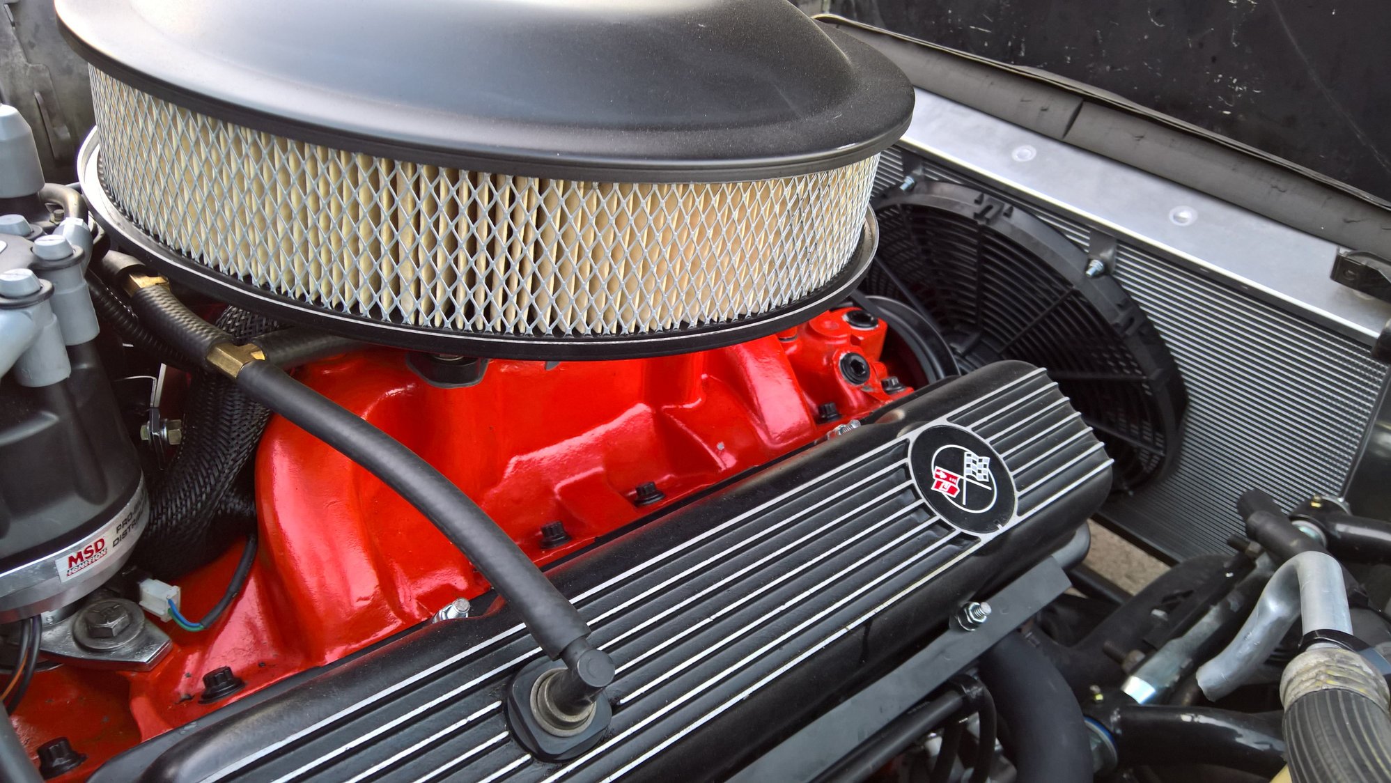

327
Keith Black 4.0 domed 10.5:1 with total seal rings
World Products Iron 64cc heads
RPM intake
Edelbrock 750
Summit 2.5" collector Rams Horn manifold to 2.5" sweet thunder pipes
Scat I beam rods
Comp Cams Mechanical solid lifter .477/.488 lift 262/268 duration
McLeod clutch /matched flywheel
Rebuilt M21
On the shelves for build later is Hekimian Aluminum 205 heads, Lars rebuilt quadrajet on a RPM spreadbore intake
I had to replace the McJacks headers. Started to come apart with multiple cracks around the welds

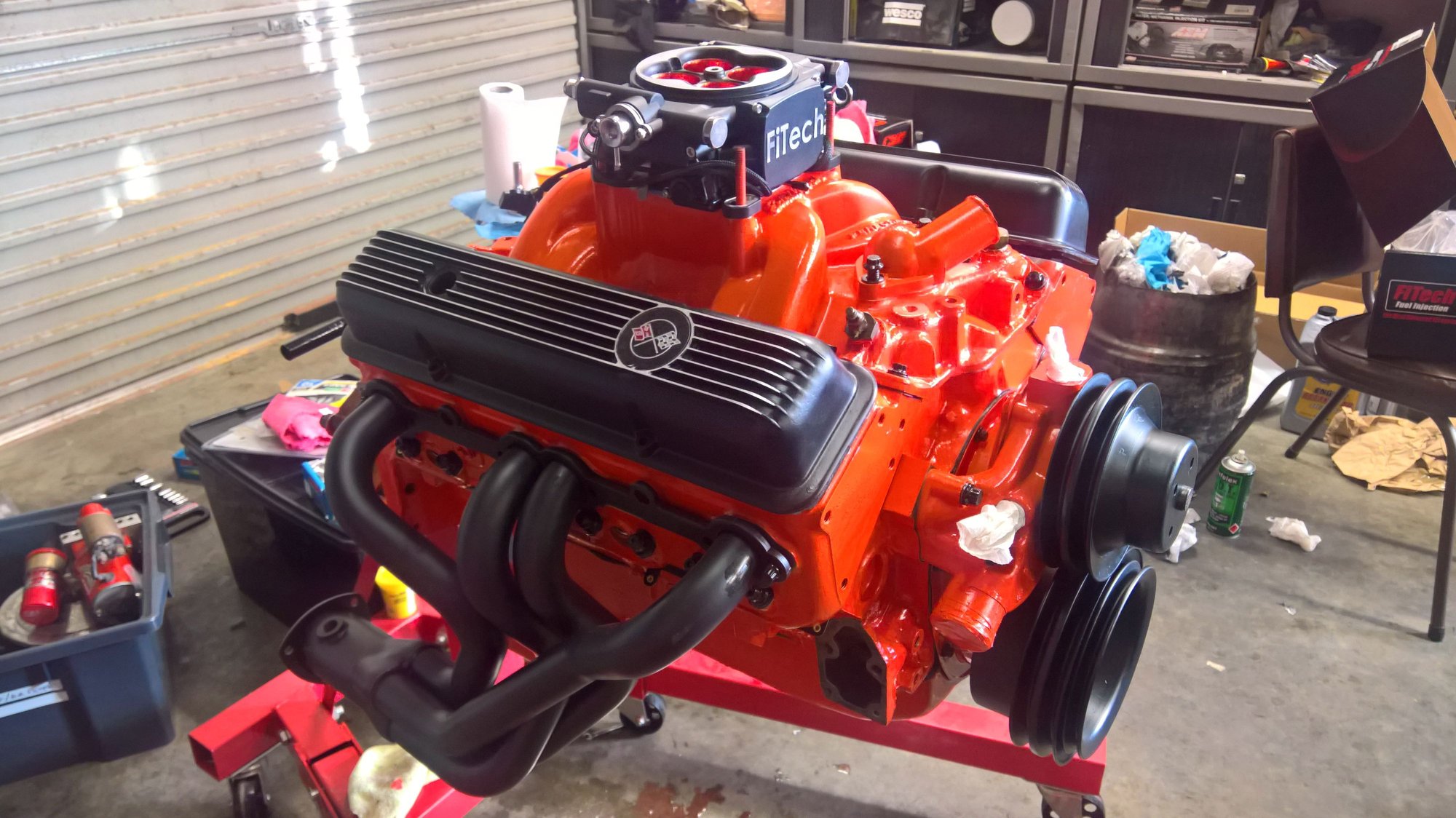

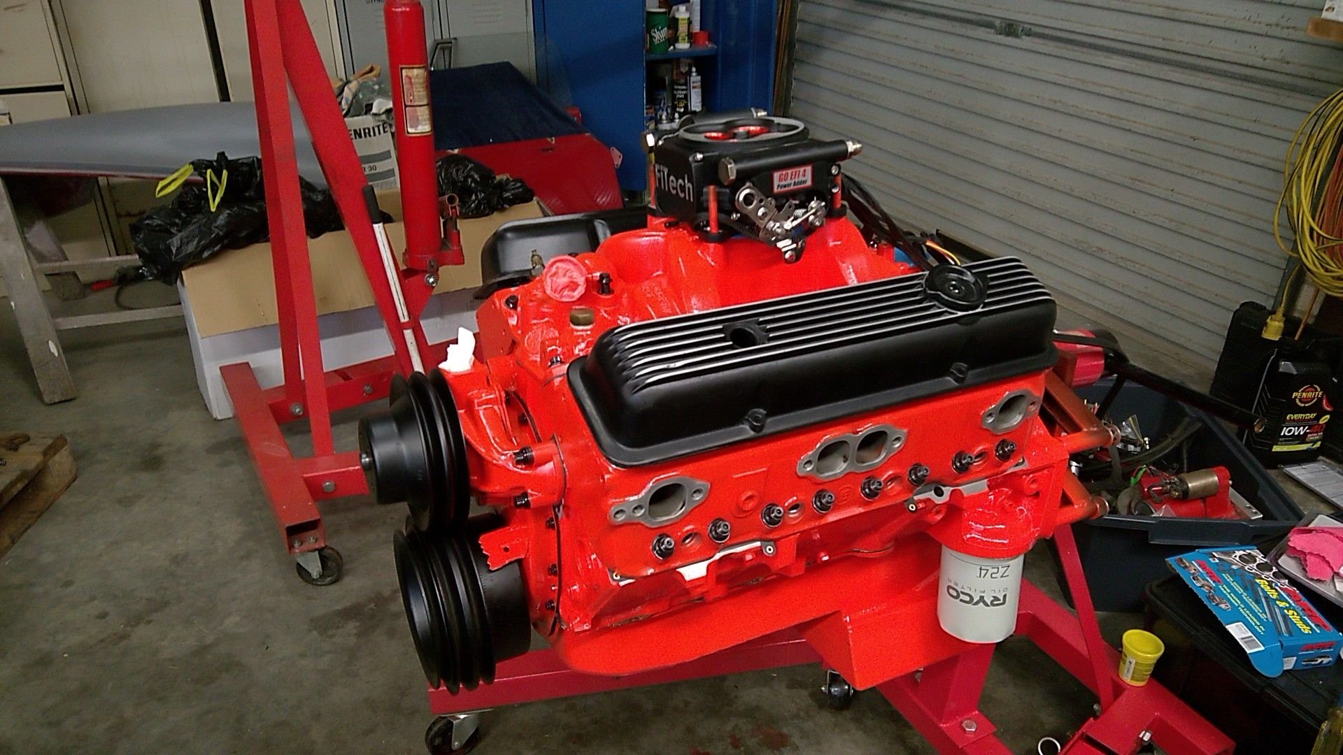

388 (0.060 over), scat crank and rods, probe pistons, heavily ported Edelbrock Performer RPM heads and matching intake, Yella Terra roller rockers. 11.1:1 compression, crane hydraulic roller cam and lifters, 238/242@0.050, 298/302 adv duration, .558" lift. Fitech fuel injection, msd ignition, backed by a steel flywheel and tko600 box. All work done, assembled and built (except machining) in my home garage. Has done over 14,000 street and track miles in the 17 months it's been in the car.
Nearing finished, on the engine stand. Here I discovered I needed spacers under my rocker covers!:

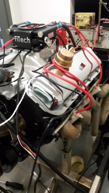

Mark Jones Vortecpro Racing built and dyno 467cu in.
Fitech 600
On the Dyno
Custom carbon fiber cold air intake with zo6 air filter in the nose

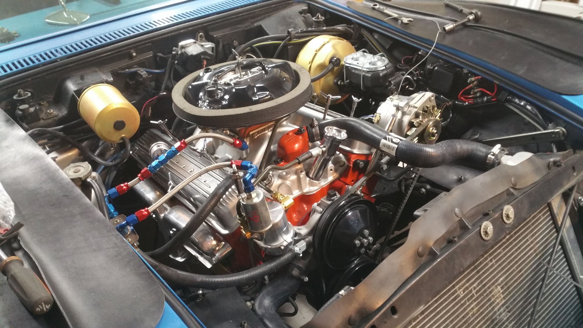

The "matching" engine in my 65.

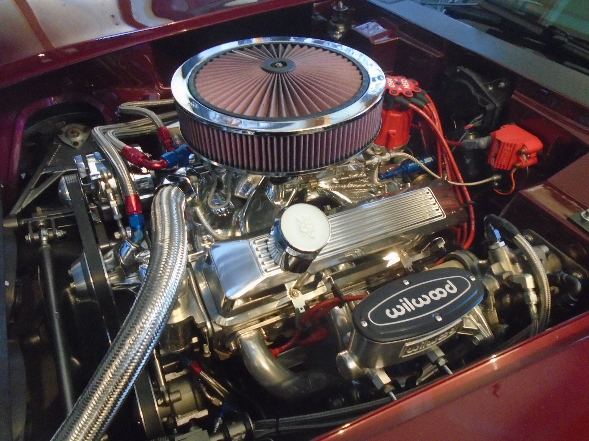

Still have some wiring to do, braided lines from tranny to cooler and fill with fluids to get it running. Description in signature.
