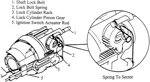

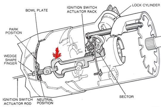

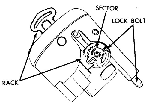

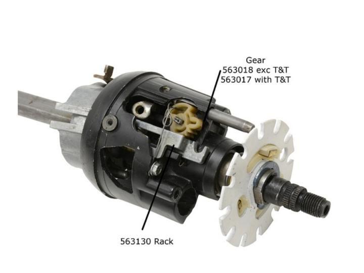

Here's some diagrams/pic of the rack, lock cylinder etc that is being mentioned in the post.

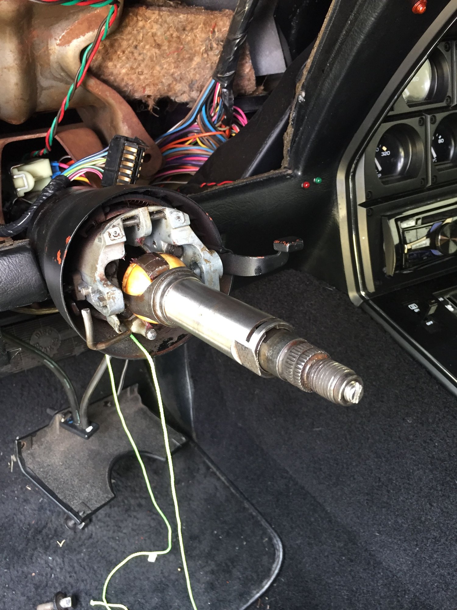

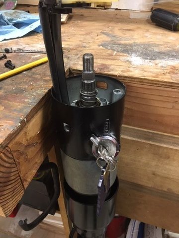

Those diagrams are much appreciated. I think you put me on the right path. Unfortunately I cant figure out how to get to see actuator rack. Ive search the internet for how to get at it. Here is a photo of where I'm stuck.

Ok now you need to take out the ing switch and anything attached to that colum like the 4 way but there are 3 screws inside and remove cover then you will see the broken rack

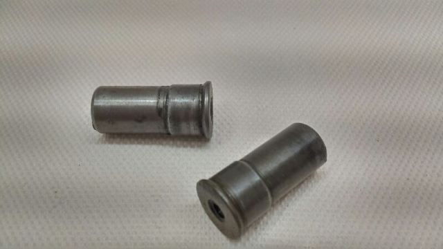

Then you are going to have to pull the two pins located in the next shroud and remove it. A special tool is made. Most auto parts stores carry them or can get you one.

Here` is a photo of the pins to pull...

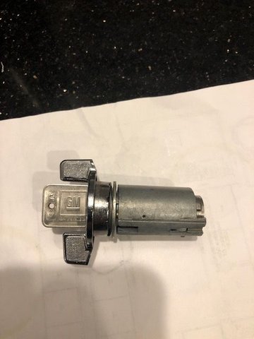

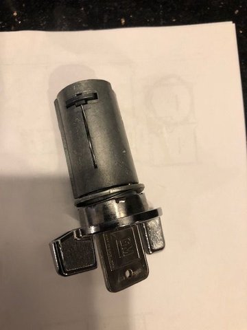

Ok, so I have the key cylinder out of the column. Shouldn't I be able to remove the key from the cylinder? It is still stuck.
can you show pictures, several from all angles? thnx

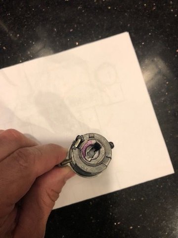

Let me know if there is another angle you would prefer to see. Thanks for the help.

I know how you must feel but this is fascinating to me. The key should certainly come out now, with nothing else influencing the operation of the lock cylinder. Did you put the assembly gently into a vice and try to pull the key out with a pliers? When the key was put into the cylinder prior to being stuck, was there any resistance? I presume you were the one that put the key in.... I wish I was there to look at it in person, this mystery bothers me too.

I can't pull the key out because it is stuck between the start and run position. It won't turn back to off. I dont remember the key going in hard to the cylinder when I last put it in. I ordered a new ignition lock cylinder from Corvette America. I'll let you know what I find. Thanks for all the support.

I had the exact same problem when my '79 was almost new to me to include the key staying stuck after the cylinder was removed. All I did was replace the lock cylinder and no more problems.
