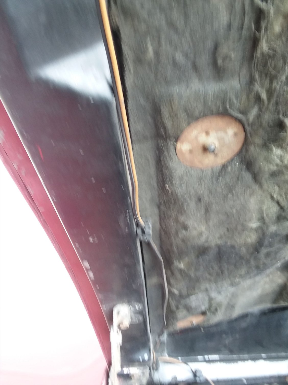

If I can get the photos to upload it is the wire that runs down the hood on my 75 convertible. Also I purchased a book for help and restoration but turns out about all it does is tell you where paint dobs

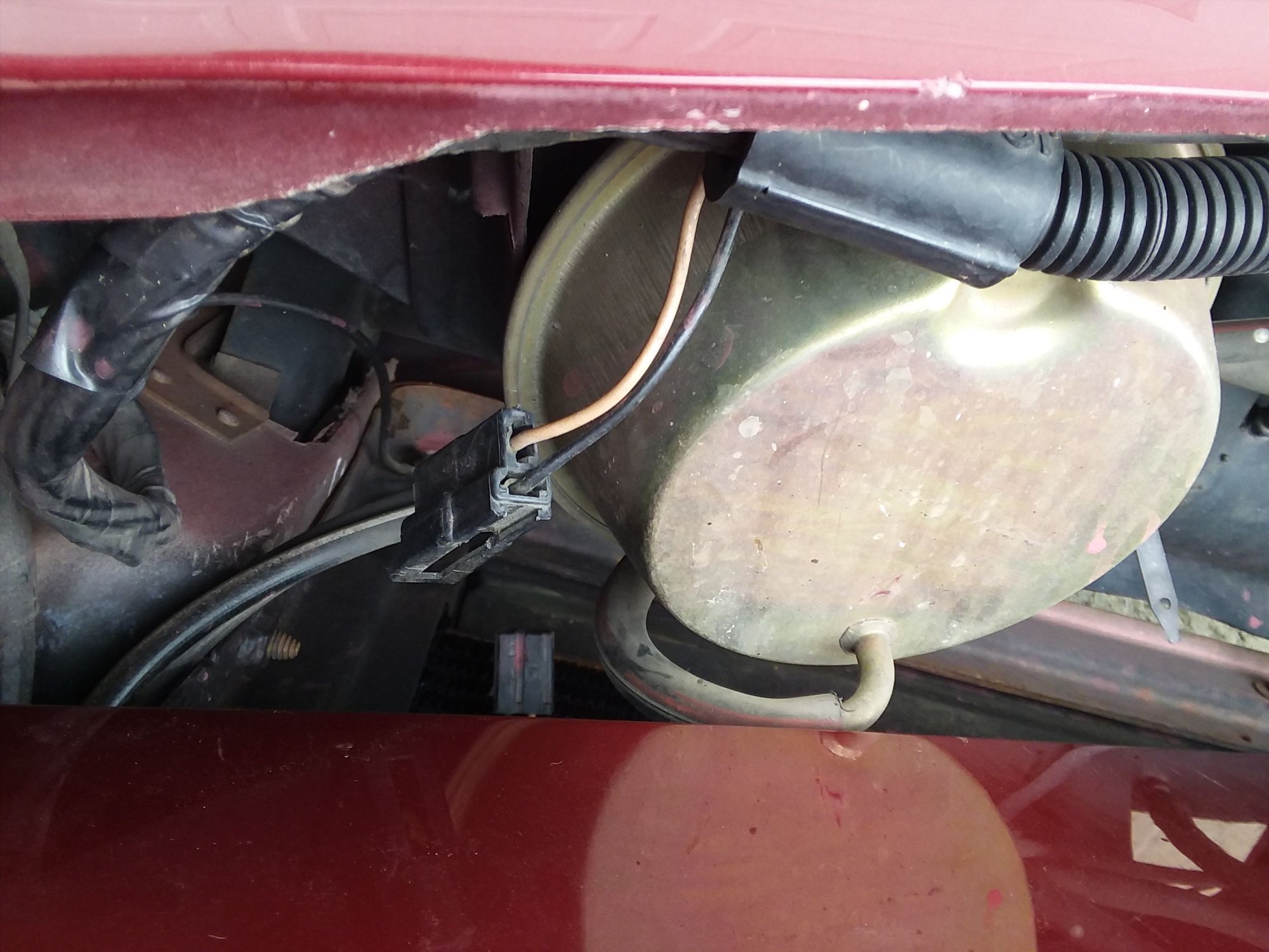

I believe it runs to your cowl induction solenoid

well I haven't had a lot of free time since I purchased this car to look into some things as much as I would like. I was wondering if it had a cowl induction selenoid when I saw the wire. That's where I will need a good manual because the next question naturally is how do I tell if it's working properly or not.

I believe this previous forum discussion on cowl induction might answer your questions
https://www.corvetteforum.com/forums/c3-tech-performance/3798173-1974-cowl-induction-system.html

Thanks for the link. I was not aware of this whole setup including a switch under the gas pedal. According to that link it also controls transmission kickdown. I do get kick down at low speed but around 60 miles an hour if I push it to the floor there is no kickdown. That could be the cause of my problem that this solenoid switch is either bad or needs adjusted.

Today I confirmed with the wire plugged in that my Cowl induction flapper does work. I had no kickdown and now I do. When I got the car out to test it the first couple times there was still no kickdown but then all of a sudden it began to work and pulls right up to Red Line and then shifts hard. Makes it feel fun on a car with no power LOL.
