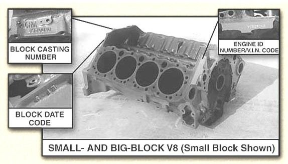

If it's a 383, it is probably a rebuilt GM block. The engine stamp pad is located at the top of the block ahead of the passenger side head, just above where the water pump bolts to the block. It may be behind your AC compressor, if you have one. If it is a rebuilt Corvette engine, the codes on the stamp pad will tell you. Or tell you have a GM crate engine like a ZZ4.
https://www.google.com/search?q=c3+c...p+pad+location
The casting number on the block, and on the heads for that matter, would be helpful. Aluminum heads? Any pictures would help, especially ones with casting numbers, or other stamped numbers.

There is a pad on the block at the front of the passenger's side head.

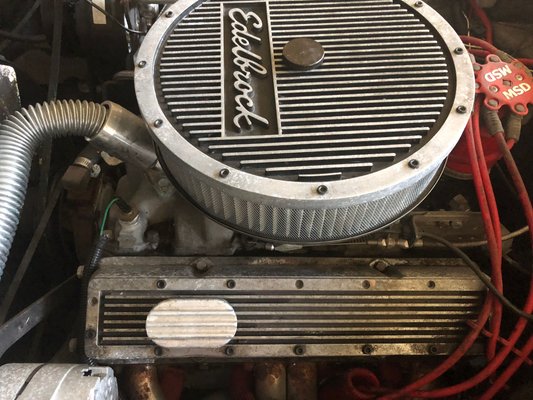

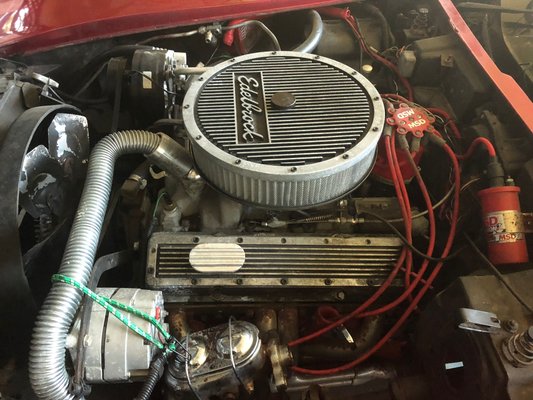

Default pictures
sorry, I was having trouble posting pictures:

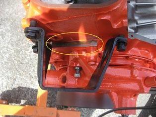

Could you look again for the stamp pad? Right where the alternator bracket is in your third engine photo, that's where the stamp pad will be below the other head (passenger side) on the other side of the car. It might be painted orange. I had to scrape muck and paint off of mine.

although, in truth the difference between a 350 and a 383 is the stroke. And you can't see the stroke from the outside. So unless you're going to pull ahead or drop the oil pan you're not going to know whether you got a three and a half or three and three quarter inch stroke crankshaft.come to think of it, yes there is. The harmonic balancer and the flywheel are both going to have counterweights on them if it's an externally balanced 3.75 Stroke motor, which most of them are. The 3.5 stroke 350 or neutral internal balance Motors the balancer doesn't have any counterweights the flywheel doesn't have any counterweights.

That engine had a hard 5 years. It does not look too fresh

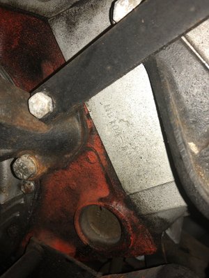

Default Found some numbers
Block casting number is 4-GM 3970010. Also has 010 on the side.
Found a number on top of tranny tunnel : 8640300 10214-A

...Block casting number is 4-GM 3970010...
The 010 blocks were generic GM 350 CID used in several model lines, including Corvette.

If you google "SBC stamp pad" you will find lots of pictures of what is being asked for.
