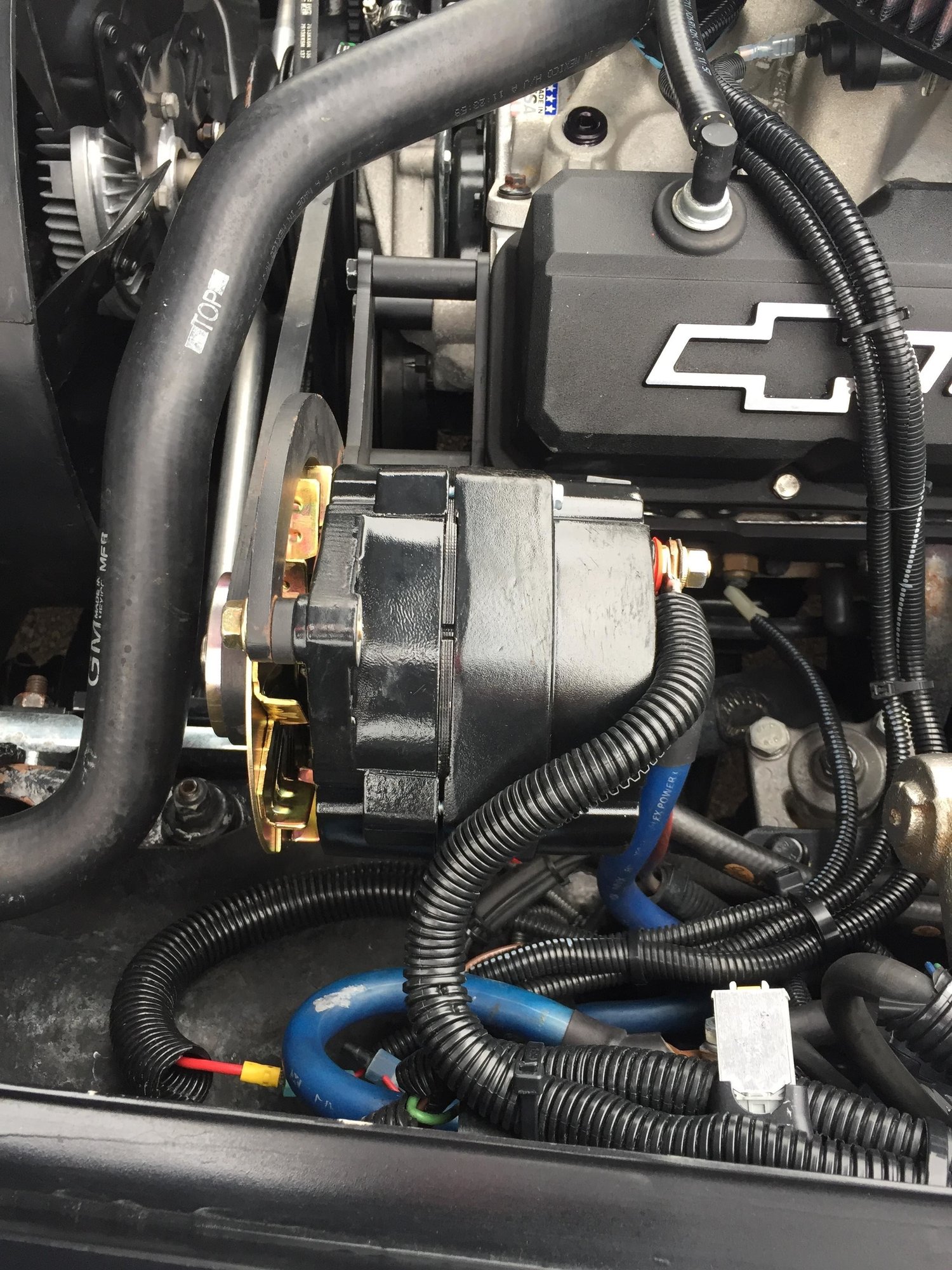

Yes, they do have them aftermarket. Most places are pretty proud of there pieces.
Soo, I made my own.

I used a Summit brand unit then went back to the factory base but kept the upper part with the Hiem rod. It works well and doesnt look out of place
https://www.summitracing.com/parts/s...make/chevrolet
Soo, I made my own.
How does that even work? You have two pivot points, unless you notched where it attaches such that the custom holey piece is fixed solid to the alternator.
Looks pretty cool! But my mind is in a pretzel...
Edit: I see now, after clicking on Rescue Rogers' link. The added part extends a bit beyond the ear on the alternator, and keeps tension on the body, making it rigid. Nifty!
