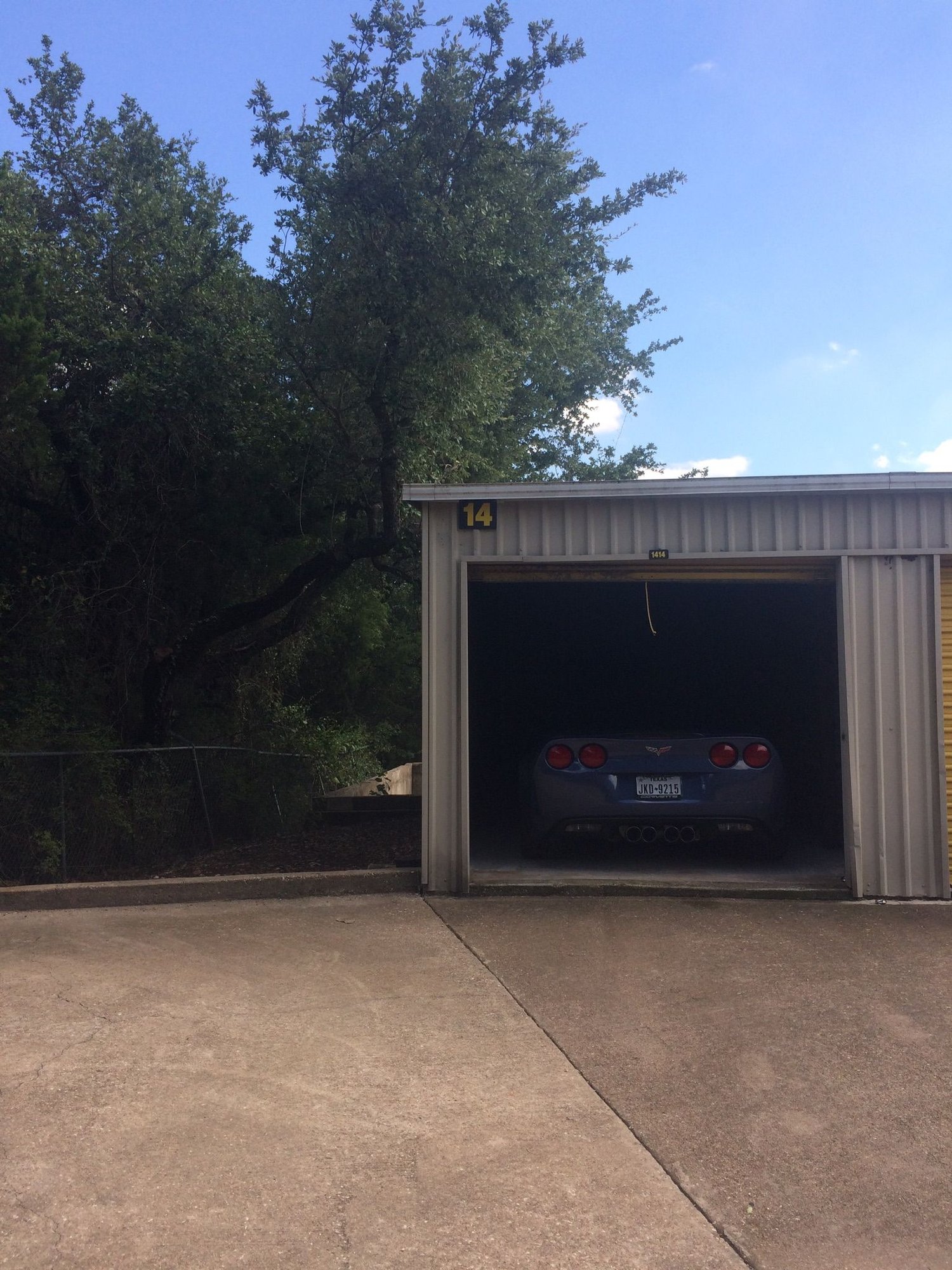

If you have the resources, you might do well to rent garage space or storage space. We can drive all year (minus a few rare and random ice days) and I still won’t leave my Vettes out in the elements. The garage at home houses two vehicles and the storage unit near our house is home for the toys. Good luck with your decision.
