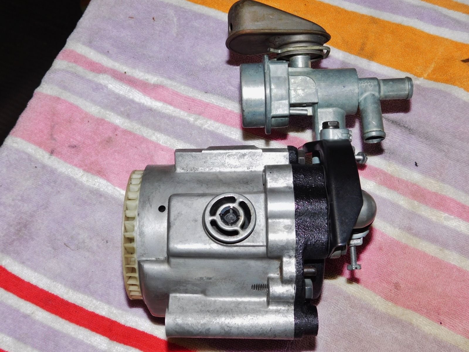

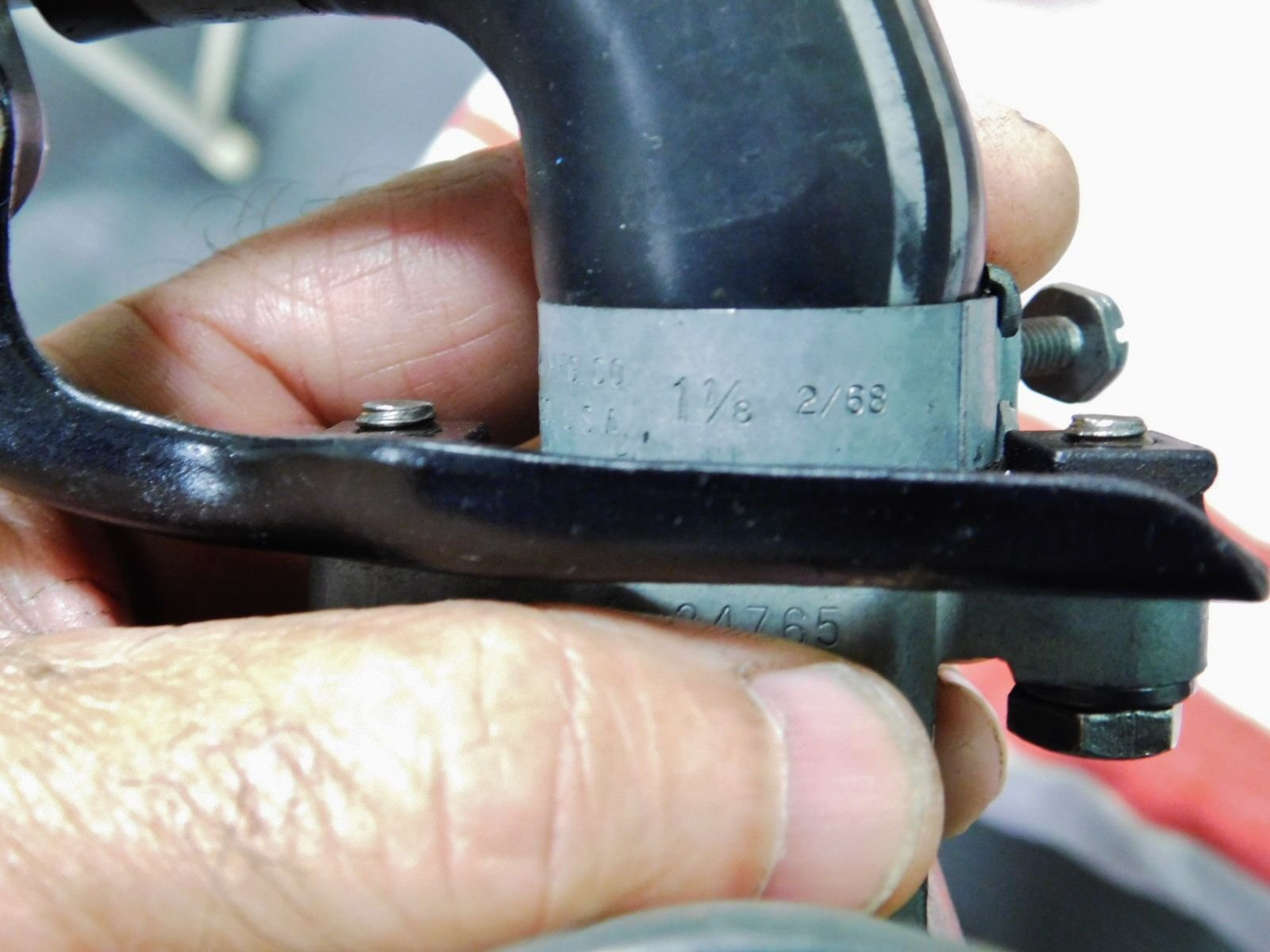

Old Oct 29, 2018 | 07:53 AM
toylman's Avatar
toylman
Joined: Dec 2006
Posts: 979
Likes: 254
From: Bethlehem, PA
Here is a '68 small block smog pump and diverter valve. This would have a spacer on the fan then the pulley. You have a big block pulley which would have been mounted directly on the fan without spacer. That pulley and pump would have been used on other GM big blocks besides Corvettes. I am not sure on the diverter valve application, but it was probably used on many big block '68s as well.
