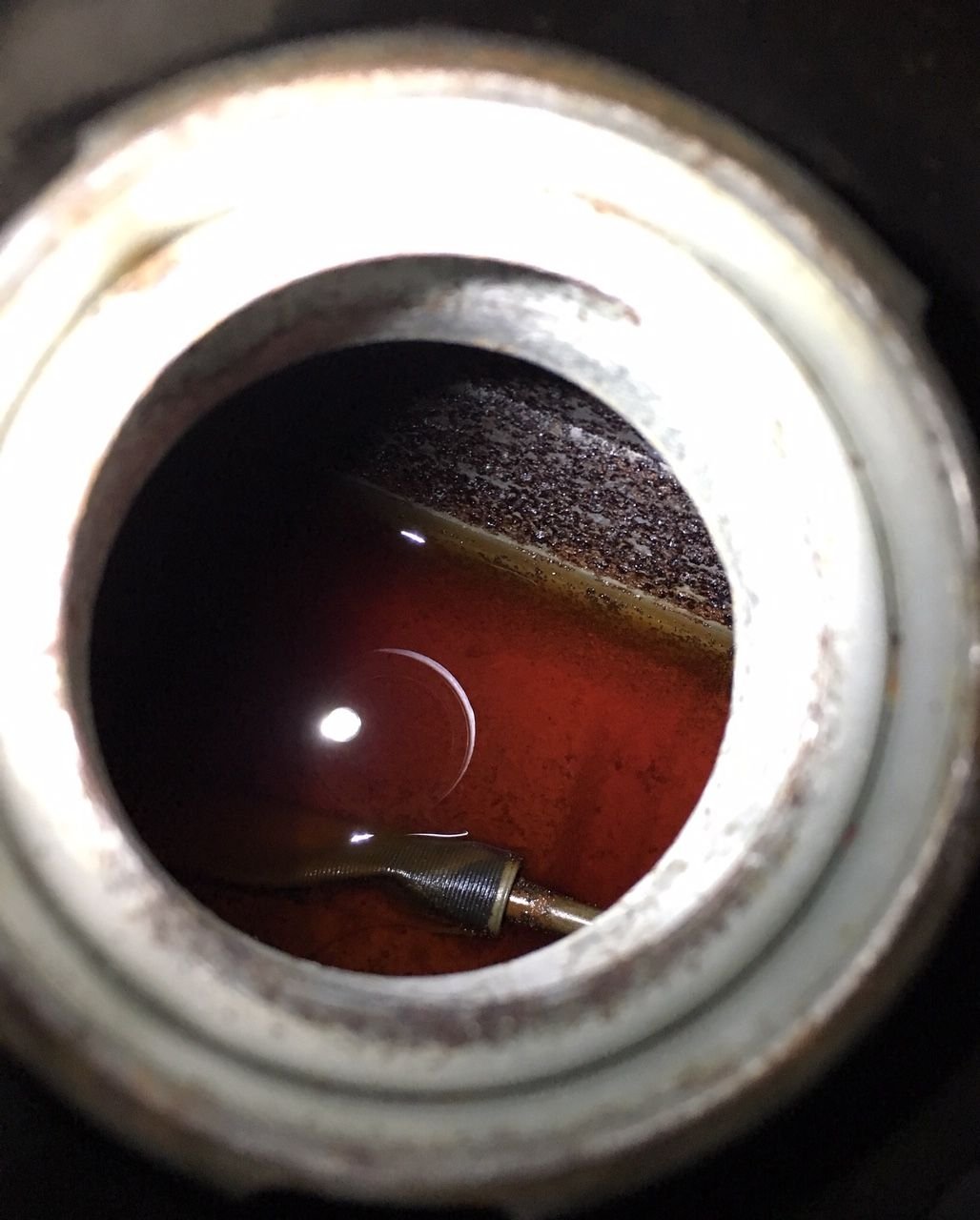

15 Month old gas with stabilizer. 89 Octane E15. I looked in the tank a few months back. All good. Started the car on Sunday, exhaust smelled horrible like varnish or turpentine. Opened the gas cap - this is what I found. Same as mentioned above by Chapter 2.
It's a '72 with non-vented gas cap. I think the tank is toast. Going to drop it and replace.
I've owned this car for 29 years. In that time I have only put on 14K miles. So it has sat in a dry garage for many years with little mileage, and with the same gas in the tank for more than 15 months at times. No issues. However, I did let the gas level get somewhat low this time. Regardless, I think today's gas contributes to this problem.
I guess the answer is to drive the car more often. LOL.
Hi guys thanks for the suggestions. I've decided to replace this tank. I took a long screwdriver and scrapped some of the rust off, a light brown rust tinge is still apparent on the walls of the tank. I don't know for sure, but I'm thinking it will be susceptible to rusting again in those areas. Tank use to be clean silvery steel. This is the factory original tank. Just removed the spare tire carrier and the Anderson logo is on the bottom of the tank.
I have ordered a non-logo Spectra tank (GM33D). Some vendors have an Anderson logo stamped tank but the tank is imported. I have heard others having rust issues after a few years with import tanks. So I'll go with the non-logo. Not visible anyway. Will purge gas line before running car again.
I should correct my comment. It was Regular E10 gas in there, not E15. I know refiners have winter and summer formulations, not sure if either is more susceptible to breaking down. Maybe 1 year with stabilizer is a rule of thumb to use. I was OK just a few months back. Looked good inside. Then it turned. My fuel level in the tank was low. Going to run 94 no ethanol from now on.
