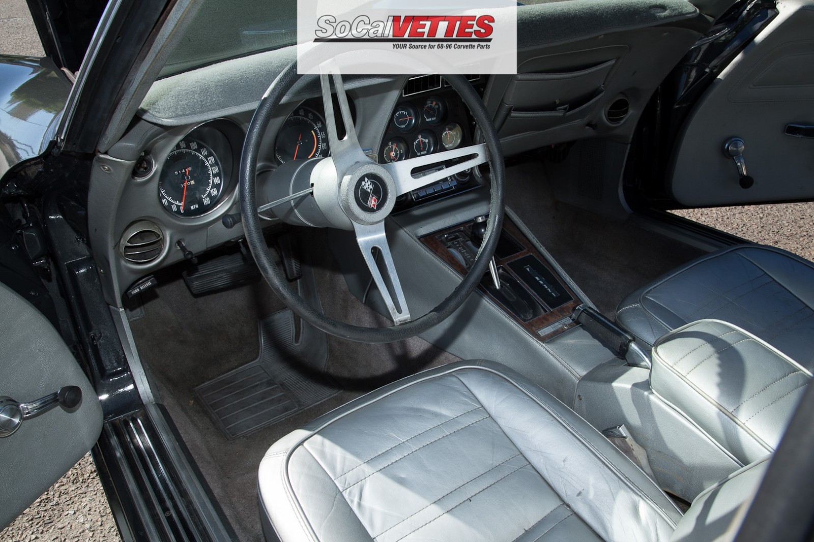

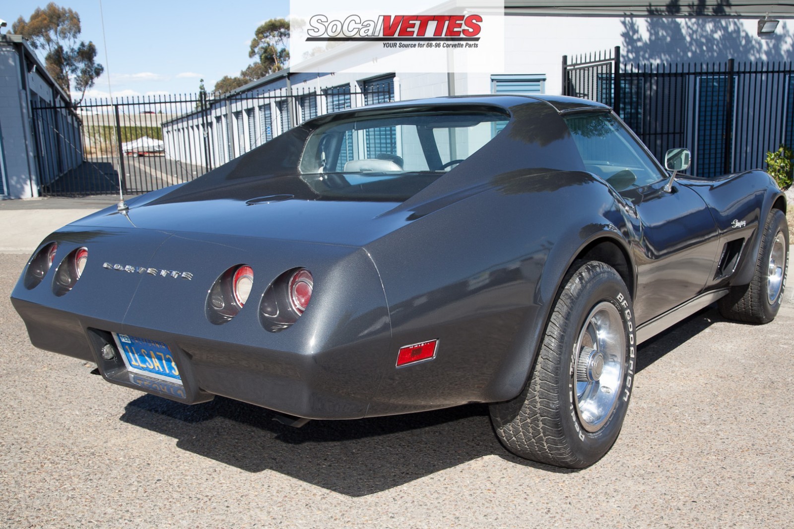

Here are some pics:
Old Oct 31, 2018 | 04:37 PM
herecomethesuits's Avatar
herecomethesuits
Cruising
Joined: Oct 2018
Posts: 14
From: San Diego
Just posted above.

Hi again herecomethesuits,
Your car looks great! New door panels (retail for about $500.00) and new weather stripping (retail about $200.00) is a good thing.
The interiors were pretty much the same up to about '77 when the seats were changed.
It would be nice to have a service history.
Rear bearings and bushings in the trailing arms run about $300.00 per side plus labor to remove and install.
The four wheel disc brakes work very well but the seals can and will leak, rebuilt calipers run about $70.00 each.
What condition is the front end in? Ball joints, A-arm bushings, and steering boxes do wear out.
The original bumpers were made of urethane and just crack and fall apart so your new fiberglass bumpers should last forever.
Looks like a cover on the top dash, is it cracked?
Solcal claims air conditioning but I don't see a compressor it the one picture you have.
Oil pressure gauges and sending units and gas gauges and sending units and temperature gauges and sending units have to work.
Under the hood you missing the stock air cleaner and the chrome ignition shielding.
Overall it looks like a nice car, as far as the price, a little less would be better.
Others that know more can clarify but does an automatic transmission go into kick down after 45 mph?
