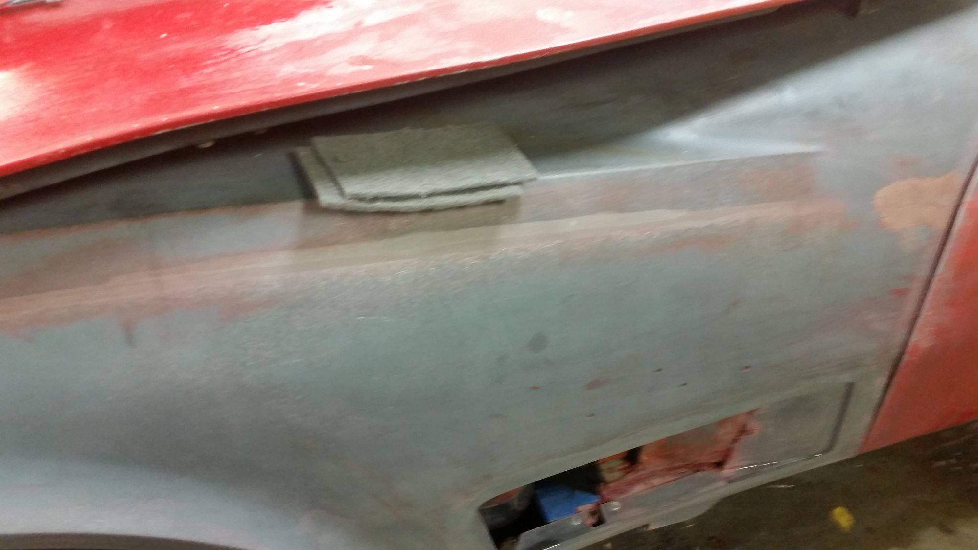

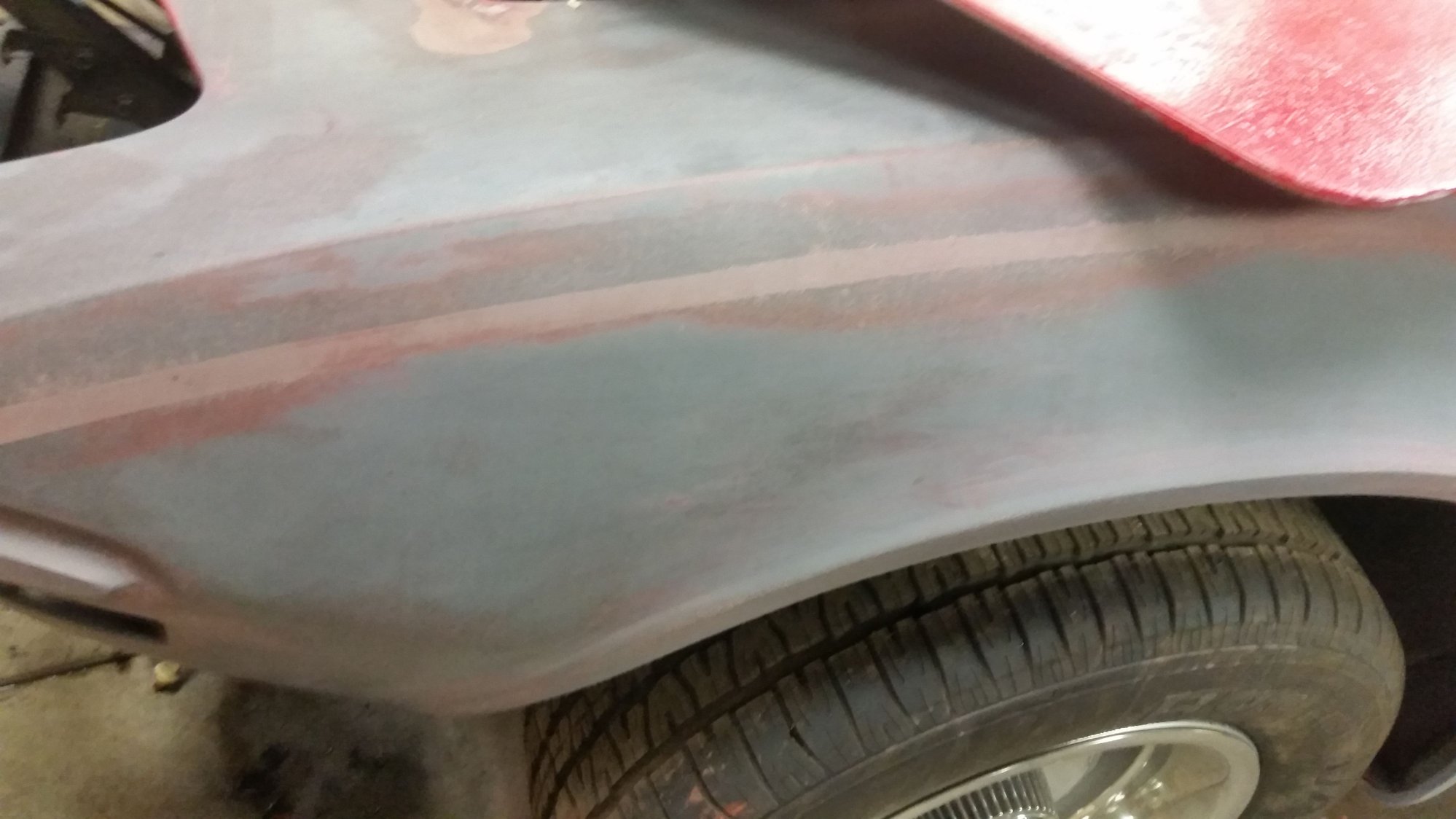

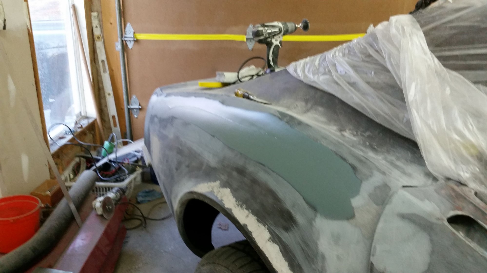

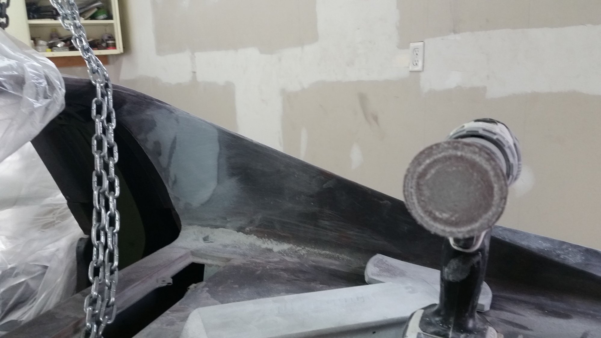

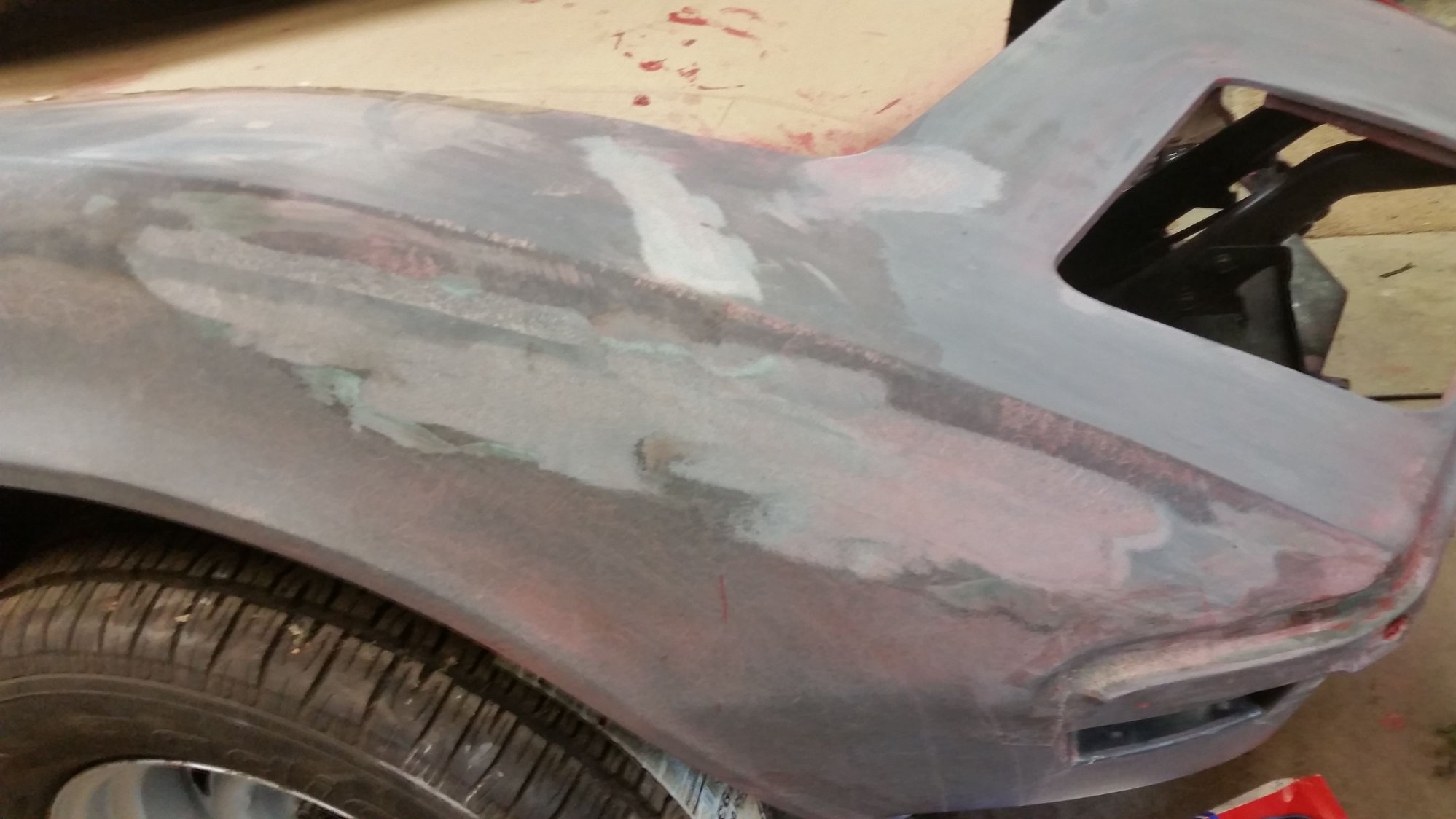

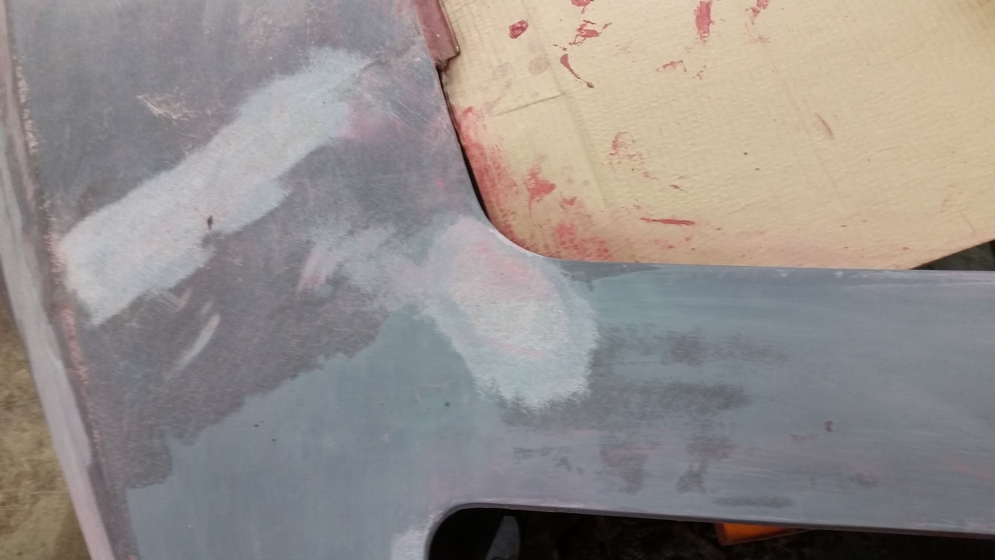

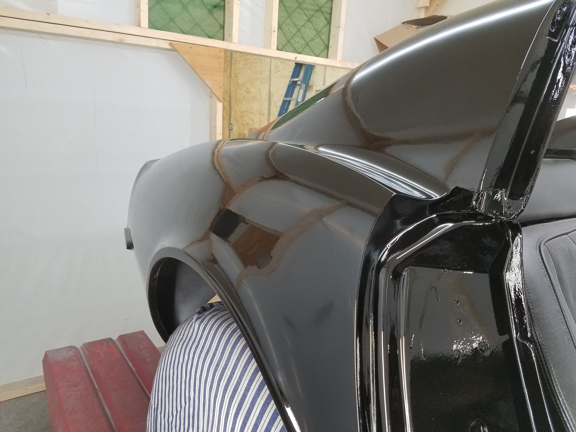

Okay, so here is what was suggested that I do to both my 69 and 71 projects. The cars were both in the no paint stage, raw fiberglass. Tool used was a air driven small sander (36 grit) roloc pads, tilted on edge a little I formed a small groove in the bonding seam line. This must be done cautiously so you don't blow through the fiberglass. You would then have a shallow bed for your VPA (Vette Panel Adhesive ) to adhere to. There are some dynamics to VPA which you should be aware of. This product is extremely strong and can setup quickly so you want to apply it as smooth as you can feathering the edges similar to applying drywall compound. Once applied you can actually start sanding with 80 grit. I would strongly advise testing VPA on something just to see what I am saying. You can use a razor blade to remove any ridges after just a few minutes. Once this stuff cures sanding is a bear. You don't want to apply VPA and wait a few days because it will be very hard to work but still doable. Hope this helps, there is probably more but I don't want to right a book. Below are some pictures. I was a novice and the suggestions were all part of my learning curve supplied to me by Dub who is a professional on the forum.
