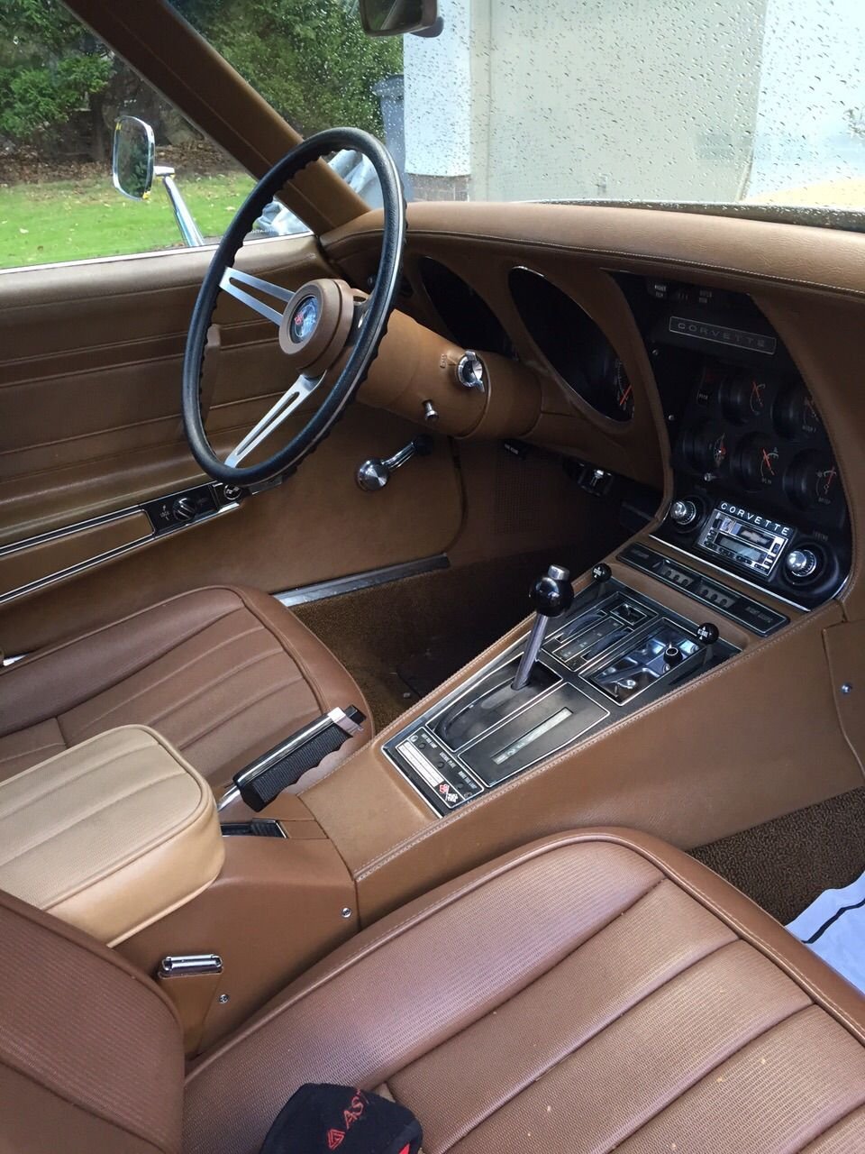

Looking for info on 1971 coupe VIN: 194371S107270. I googled the vin & checked the C3 registry without success. No pics yet of the tach or console plate and have no idea of birdcage, mounts & frame condition. It's a lady looking for info on her recently deceased husbands car.
Any help in decoding what this was / is gratefully received.

The car is a ZQ3 base engine (350ci - 270hp) coupe with an automatic. The tach will have a 5300 rpm redline.
The car has been dressed up to look like an LT-1 with hood, valve covers, air cleaner sticker and I'll assume console plaque.

A pic of the trim tag inside the drivers side door frame will be a big help in noting if the car has had a color change.

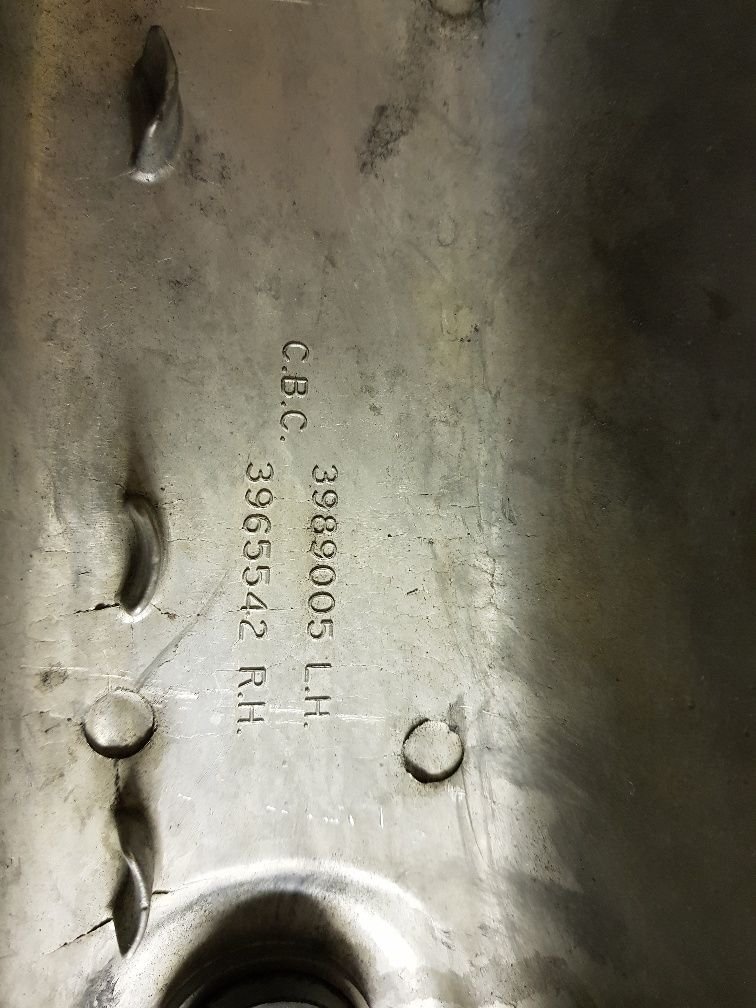

firstgen. I have a '71 LT-1 but I take your suggestions on board. I've just had my valve covers off for polishing and took a pic of the codes inside

What on earth can be made of this ?

CE indicates an engine replaced under warranty. TXB is the ID code for a 75-77 truck block. The 70 appears to be hand stamped.

A replacement engine? Looks like a '75 Camaro or something, changed under warranty...?
Ooops! Mike beat me to it!
Thanks Mike & Stephen and as I thought. I'm still planning on going over the car, not to purchase but just to advise the Widow on a fair selling price.
