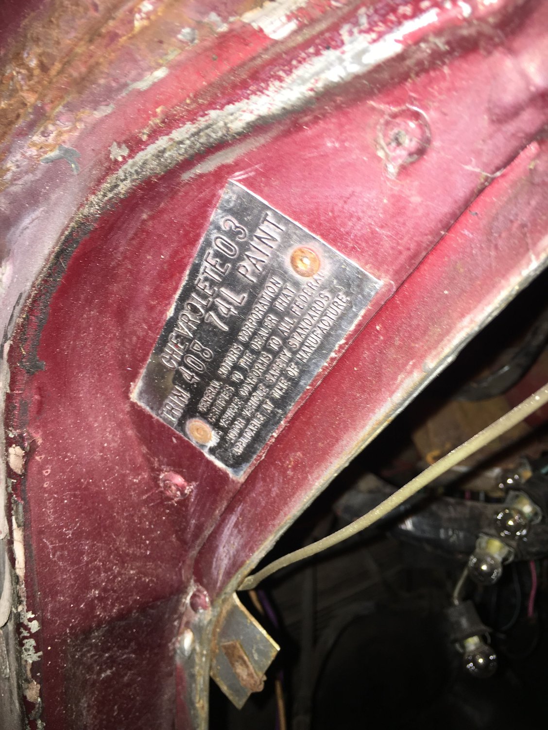

As mentioned above, you could compare the engine stamp pad to the VIN if the car still has the orig. engine. A sure and quick check will be the driver's A pillar trim tag. Is the paint code 74 (1975) or is it 37 (1976).

Here is the vin and engine tag. They match and shows 75 and the actual real title for the vette says 75. Why would it have no vents, metal floors and a 76 steering wheel then?

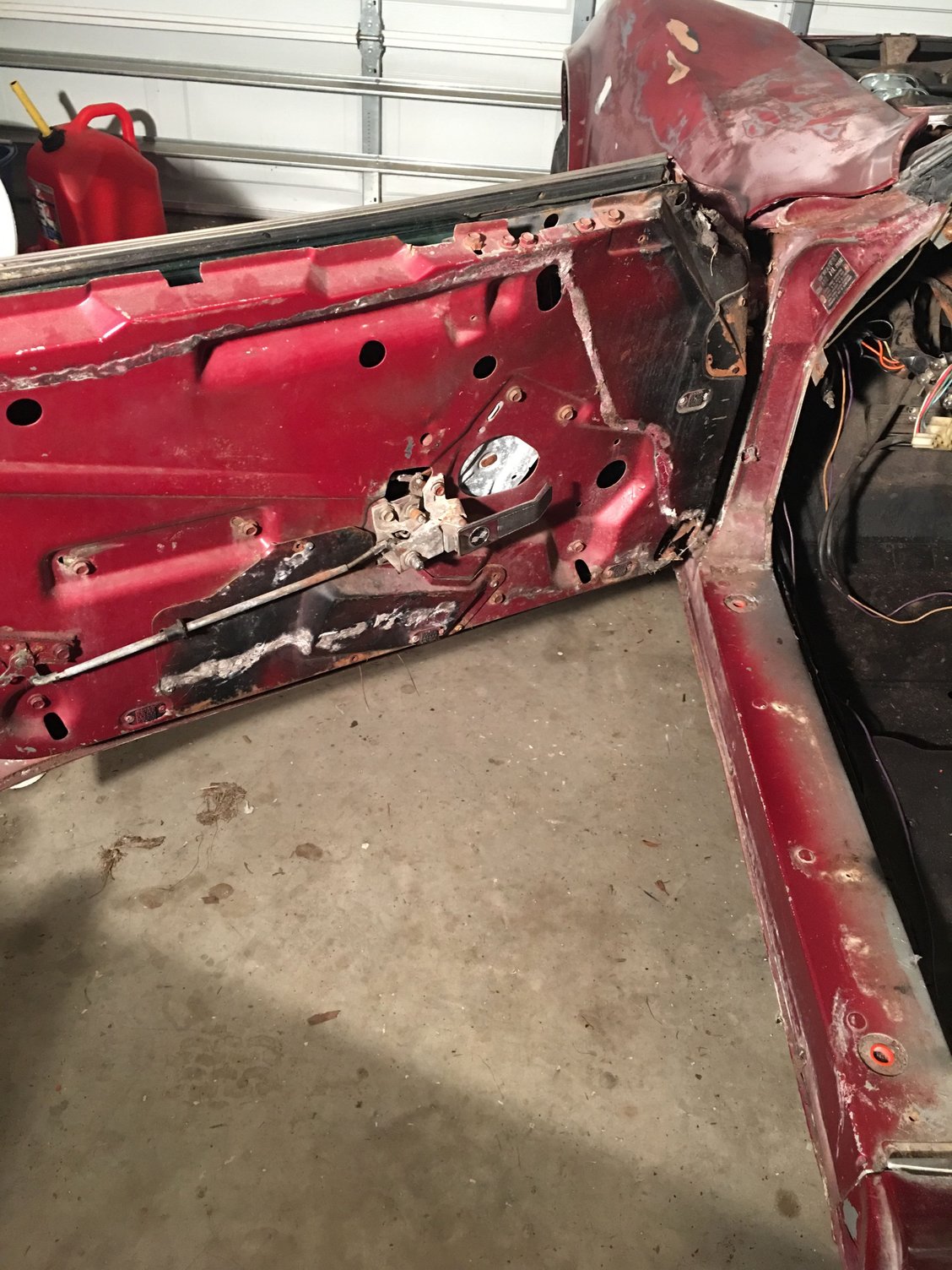

I was looking over the forum about the Astroventillation and one person said some factory AC cars did not come with it. Really got me curious on this one. Here is a picture of the sad looking doors. Also, the title I got does not have Nova on it anywhere. I’ll include a photo of that too. Since I’m still a novice on Vettes and learning more thanks to you guys, I didn’t even think about decoding the vin when I was looking at it originally. Lesson learned there too.

AC cars still had the rear vents...they just didnt work.

That trim tag has a 75 exterior color, and a 74 interior (any "natural" interior left?) and I don't know if trim tag rivets can rust. The partial VIN on your engine is not lined up, as if it were stamped by hand with the head still in place. CKZ is the engine code for a 1974 190hp 4-speed car. The VIN tag looks to have proper rivets, and you need to remove the windshield to do that anyway.
My guess:
VIN and (new) title are correct. Restamped motor, but whatever. Rear clip replaced at some point with a 76 (no vents, new badge). I won't speculate on the trim tag, perhaps my website source has a typo.
