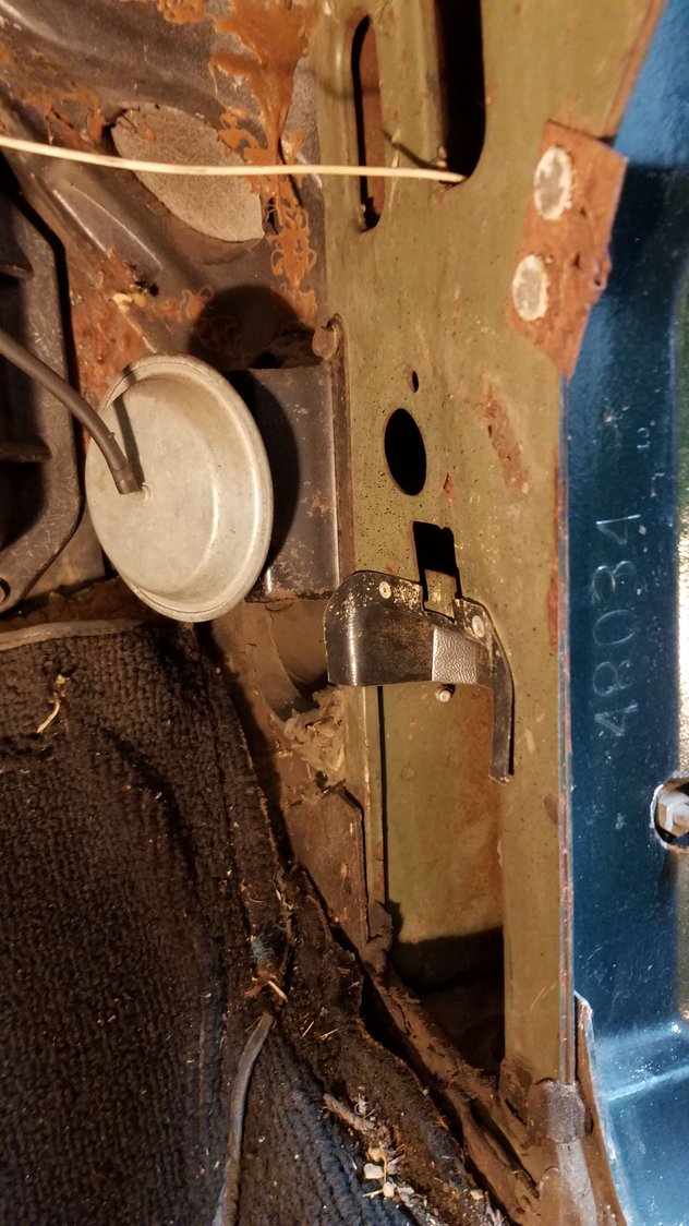

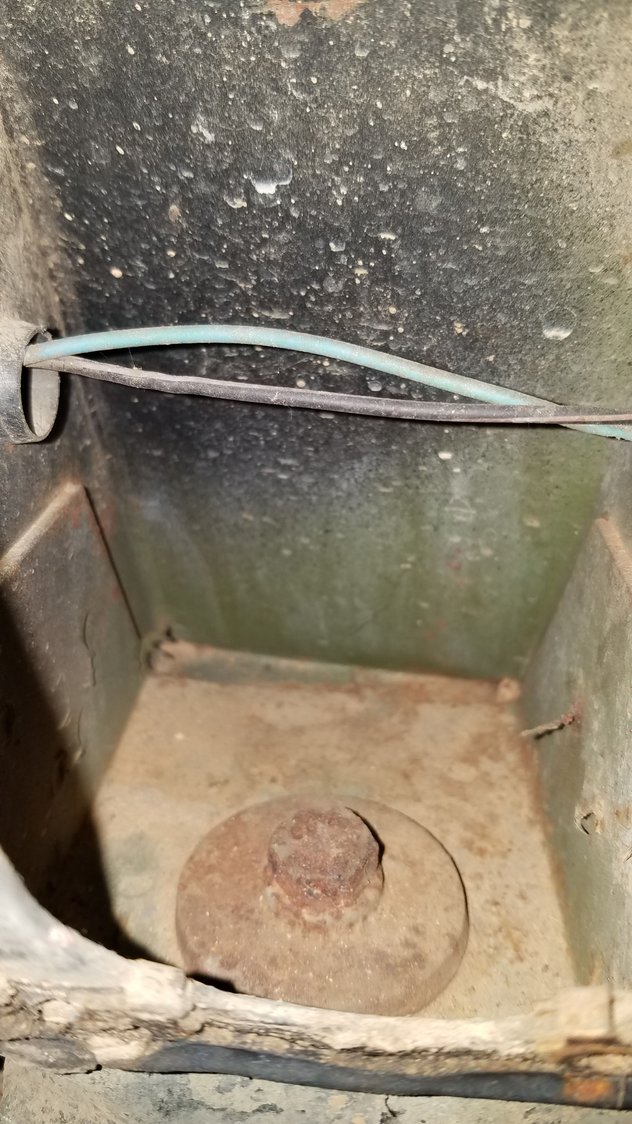

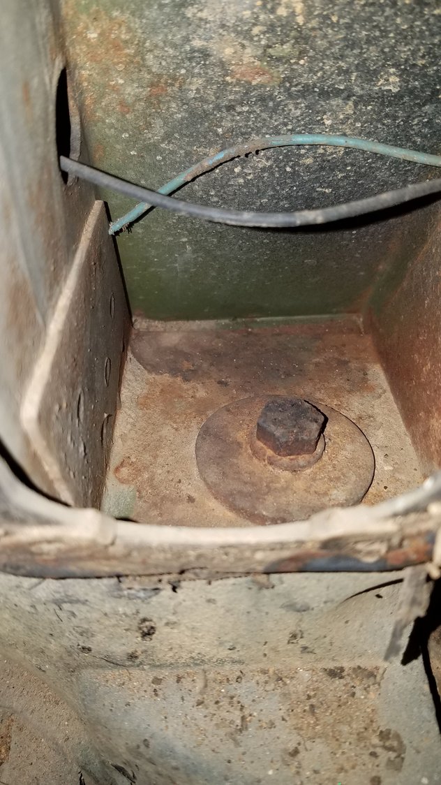

Im stumped, i inspected my birdcage last night and took some pictures to show, i tried several times today the same way i have been uploading pics with no luck, went back and read the sticky on uploading pics tried again tonight, wound up with about 50 duplicates in my photo album but still none on the reply i was trying to post. Looks like gonna be more trouble to document the process than to actually do the work.

From the pics that made it here , that cage looks great.
I too have had trouble posting some times, it's almost like the site is bogged down . I try a couple hours later and usually it's working ok again.
Absolutely , only take the body off if you really really have too.

Never heard of a body shifting on a frame before, you know the captured nut up inside the rear compartment (#4) mounts, is just a cage that's rivited to the fibreglass so if you force it too hard it will break free and just spin.
It really sounds and looks like a good solid foundation for a restoration .

I have personally looked at Toms Vette. In my opinion it is one of the best examples of a unrestored C3 I have seen. Wish I had this platform to work with, Tom is fortunate to own it. I'am looking forward to watching the progress and taking a ride in it one day. Not to many 68 verts out there with no rust anywhere.

Those mounts look great. If you are replacing the rear brake line, you might as well look at doing the fuel lines too. I've done the rear brake line with the body on, but haven't figured out how to do the fuel lines with the body on without piecing it together. I'm not sure a few inches if a few inches of body lift will help, but worth looking at IMO.

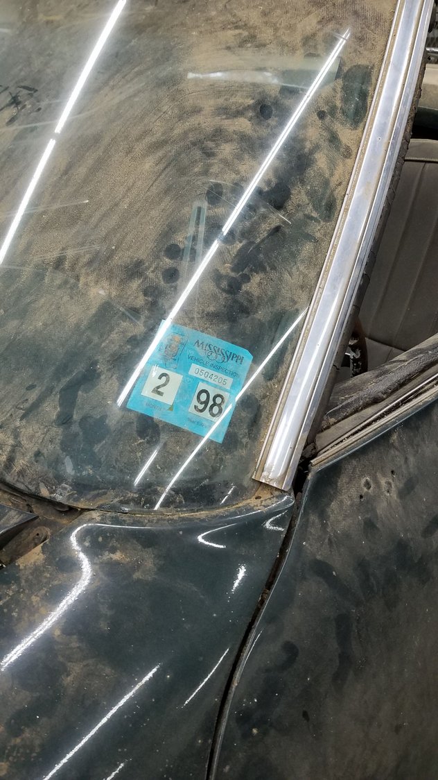

What's the trick to getting the trim on top of the windshield frame off, i think i have all the screws out. The side was stuck on with some sorta sealer, I'm thinking same with the top .

Tom, the end caps on the top of the windshield have very small screws in the front under or very near the glass. You need to remove the glass to get the end caps off. You can try to unscrew them with the glass in but you need to know yo may but the windshield. Vey wise to remove that trim to inspect the windshield frame. You Don't want what I had.
