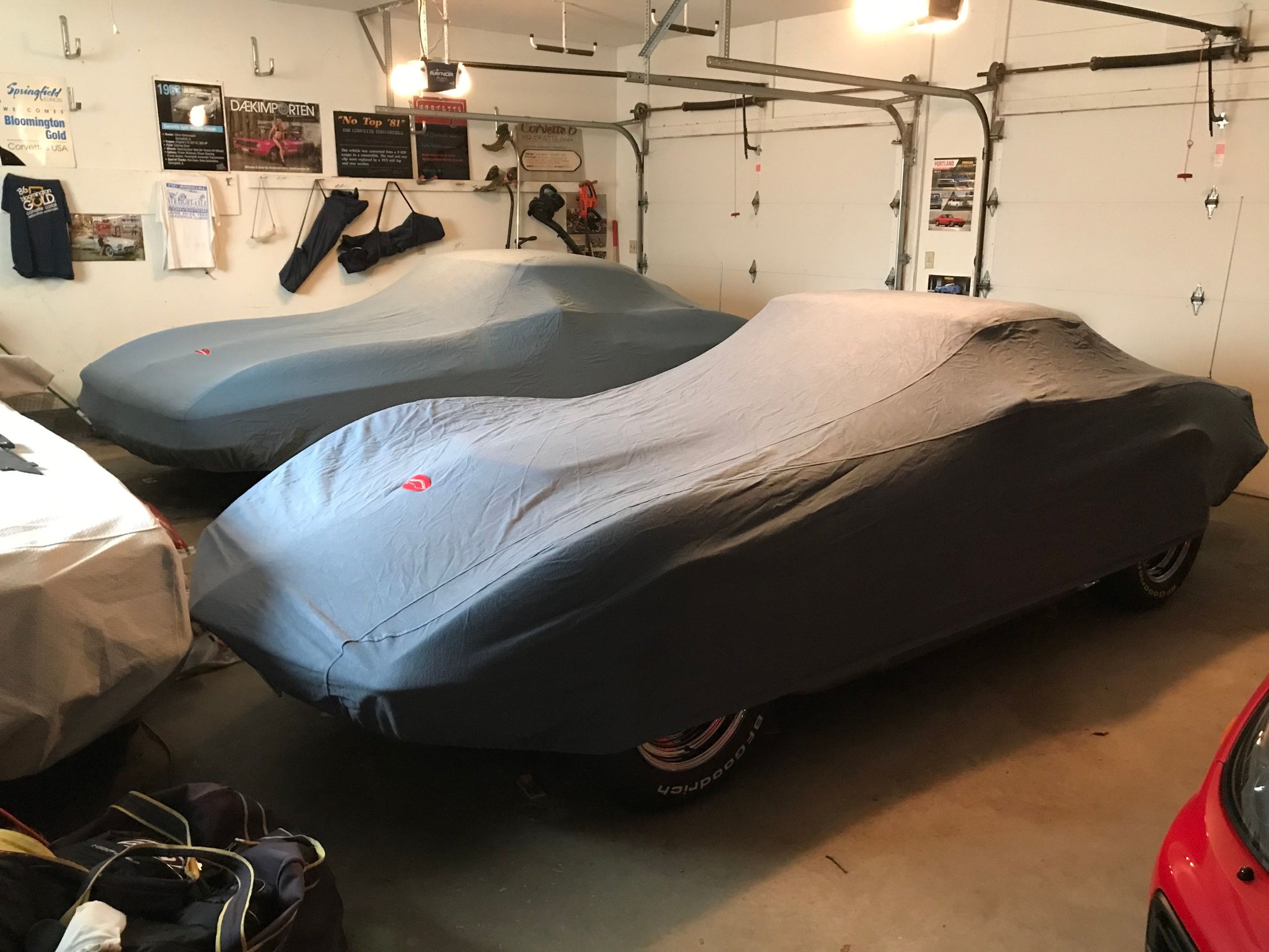

I put Bounce dryer sheets in the interior and the engine compartment and a few snap mice traps around the car. Disconnect the battery and put the top up for the first time since Spring to stretch it out. Snow this week ended Corvette season. See ya in April!

hey guys ,put a bar of irish spring soap in a room where you are watching TV ,in about a hour or less you will be getting up and removing it from the room!!!
Old Nov 16, 2018 | 01:42 PM
Bills17n72's Avatar
Bills17n72
Joined: Sep 1999
Posts: 4,909
Likes: 698
From: grand rapids, lowell mi. area
Vettebuyer6369 ,I think you need a couple more corvettes!!
Old Nov 16, 2018 | 03:34 PM
vettebuyer6369's Avatar
vettebuyer6369
Joined: Jul 2000
Posts: 53,982
Likes: 6,209
I agree with that wholeheartedly.
Unfortunately I need a few more parking stalls as well!
