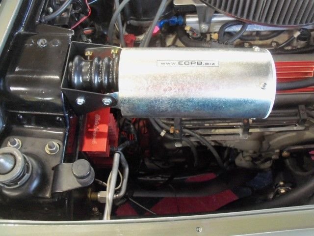

As far as I know, there a 2 commercially available wiper door conversion kits available, and they both cost about $1000.
The first is made by a company called ECPB, and it is hideously huge and ugly!!!
The ECPB kit also used to operate very slow, but they have since changed to a faster linear actuator. Most of the Corvette parts supplies sell this kit, there is a video of it in operation on Zip's site:
http://www.zip-corvette.com/68-72-el...rsion-kit.html
The second kit is made by Detroit Speed and Engineering, and it is a VERY well engineered kit. The wiper door motor is hidden under the wiper door, with nothing showing in the engine compartment. This kit is a much better deal than the first kit because for the same $1000 you also get a modern windshield wiper motor with delay control.
