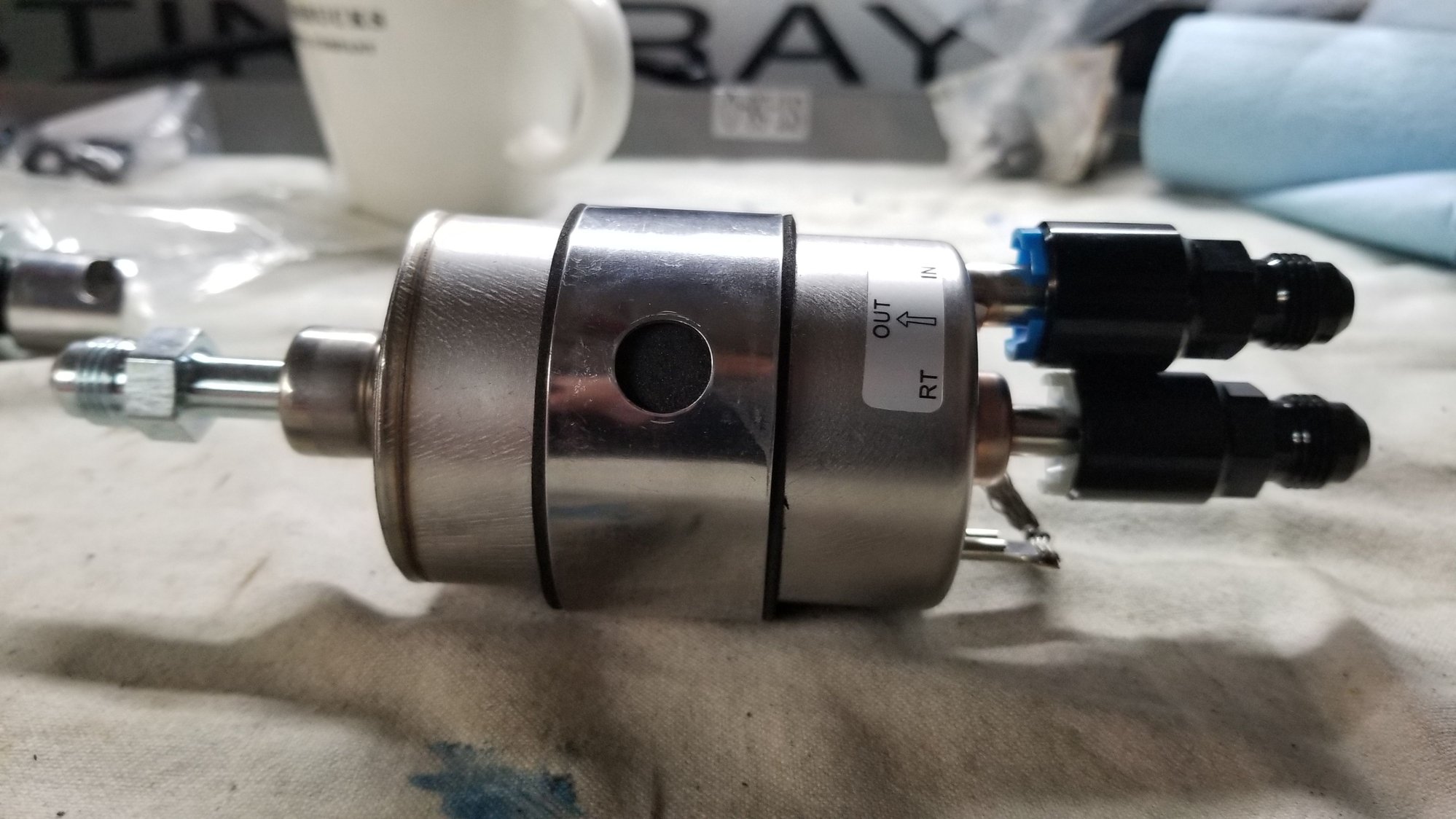

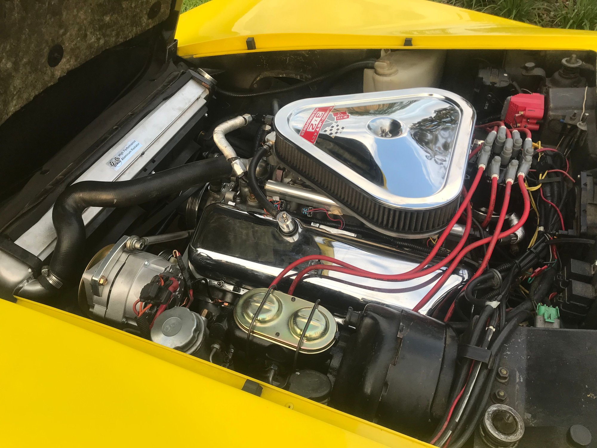

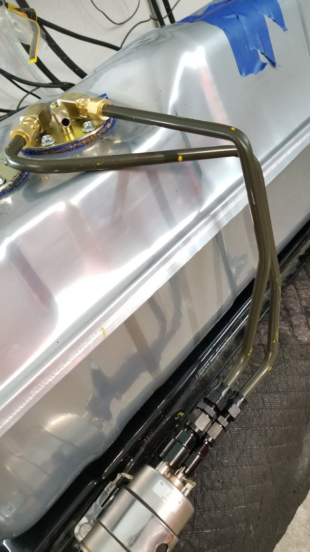

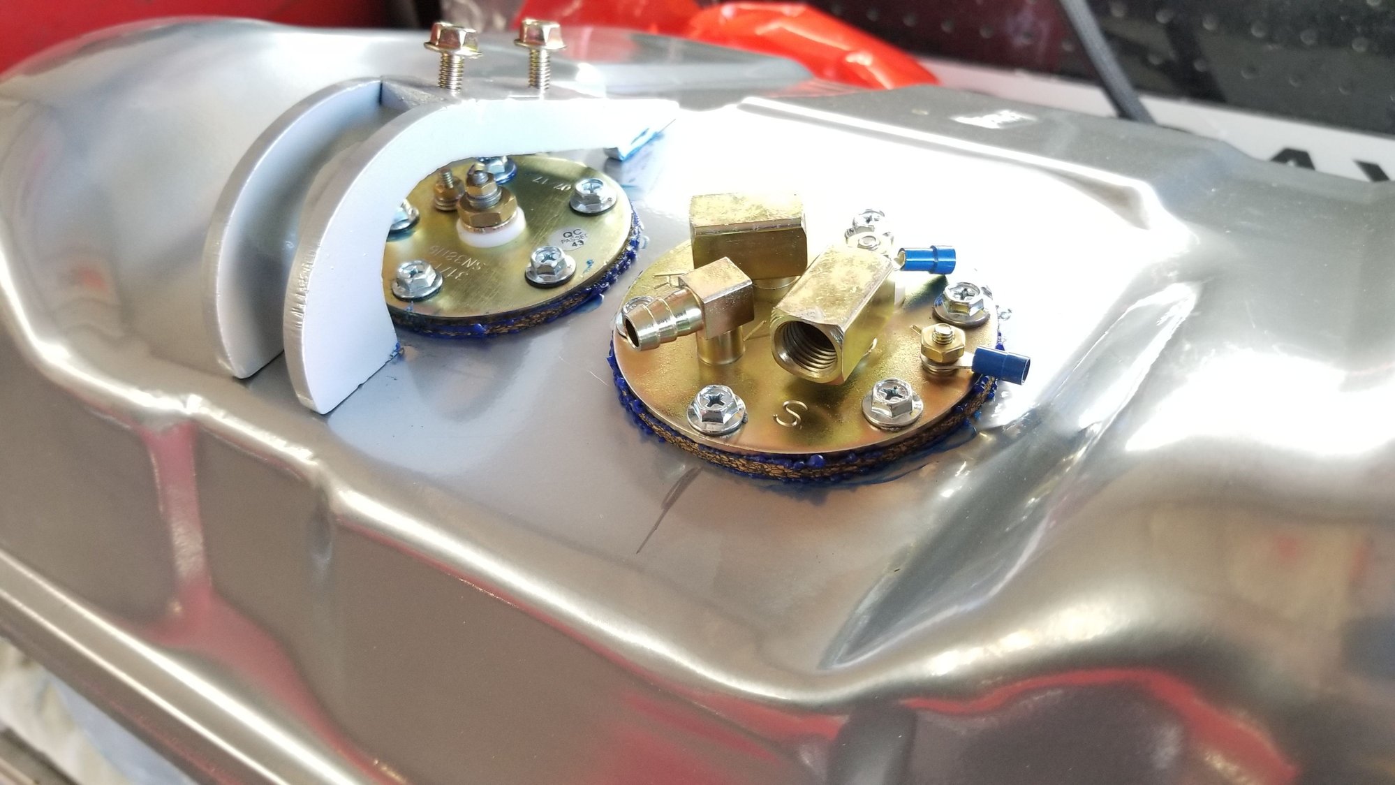

Here are some pics of my setup. It is -8 feed line from an Aeromotive in-tank pump using an Aeromotive regulator and filter back by the tank. Comes up under the heat shield in front of the passenger foot well where there is a Y-block. Two feed lines (actually those are still the Goodridge braided steel) to the back of each rail. Then a crossover at the front of the rails for pressure fluctuations. You can see the heat shielding added to the rail feeds and crossover if you look carefully. The sensor for the fuel pressure gauge is at the front of the passenger side rail.
The intent was to make it look like something Chevrolet would have done if they could have done a 3x2 port injected EFI 496 big block backed by a T-56 6 speed in 1975.
