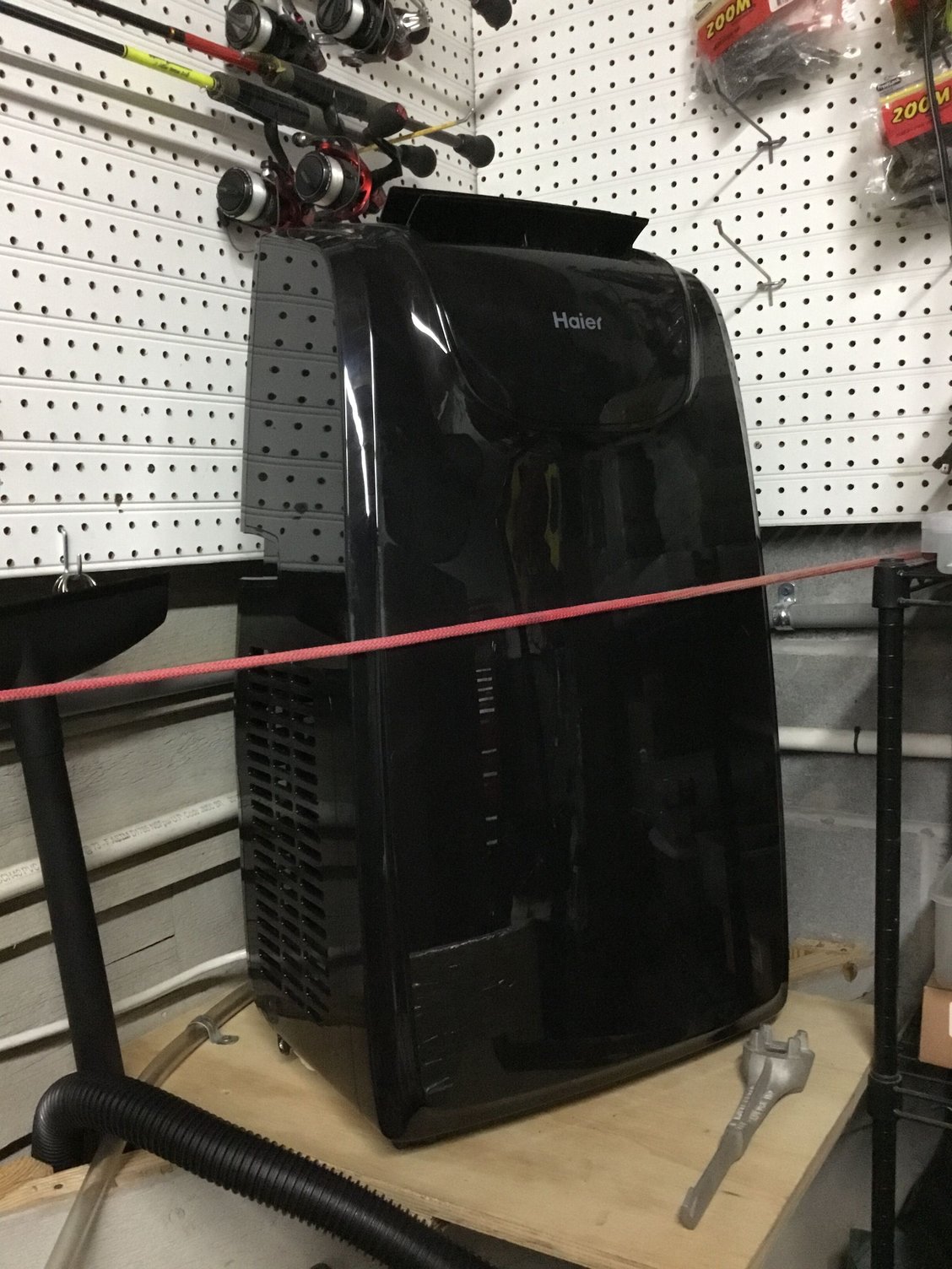

I use a portable heat pump in the garage where I keep my Corvette, the garage is a 15x30 addition I built to store and work on the car. The HP has a dehumidifier setting as well as heat and a/c. The garage gets afternoon sun so I run the unit year round to control heat and humidity as well as heat for the winter, it does a pretty good job. I paid $250, bought it from Walmart.com.
