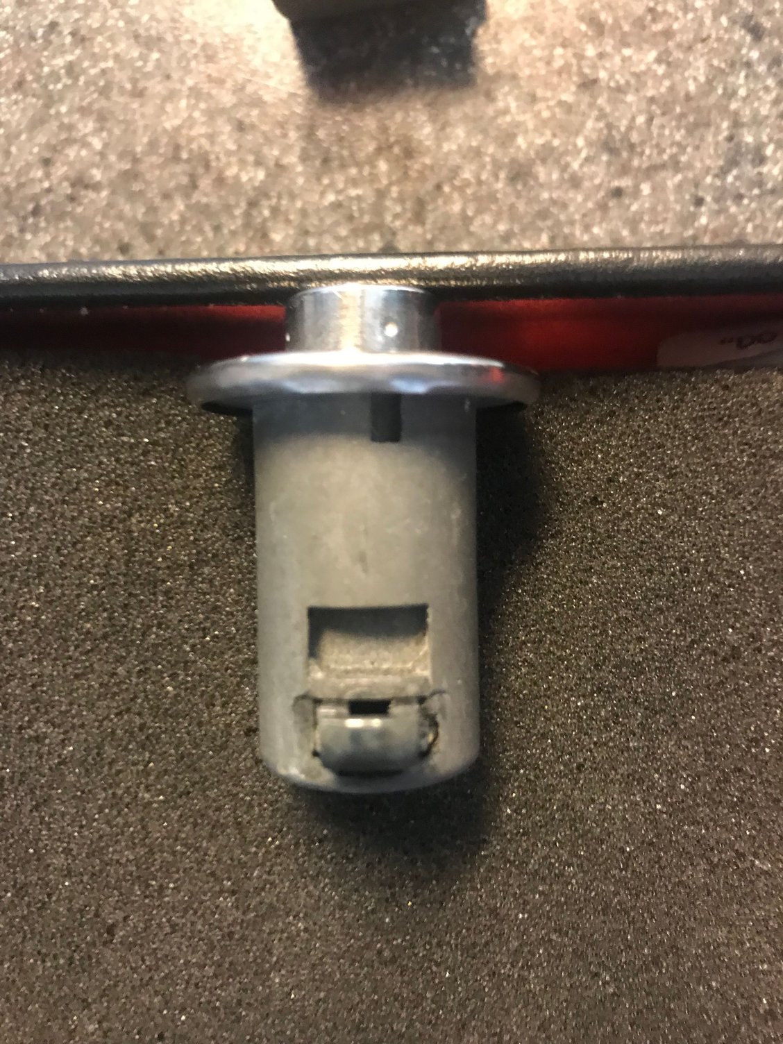

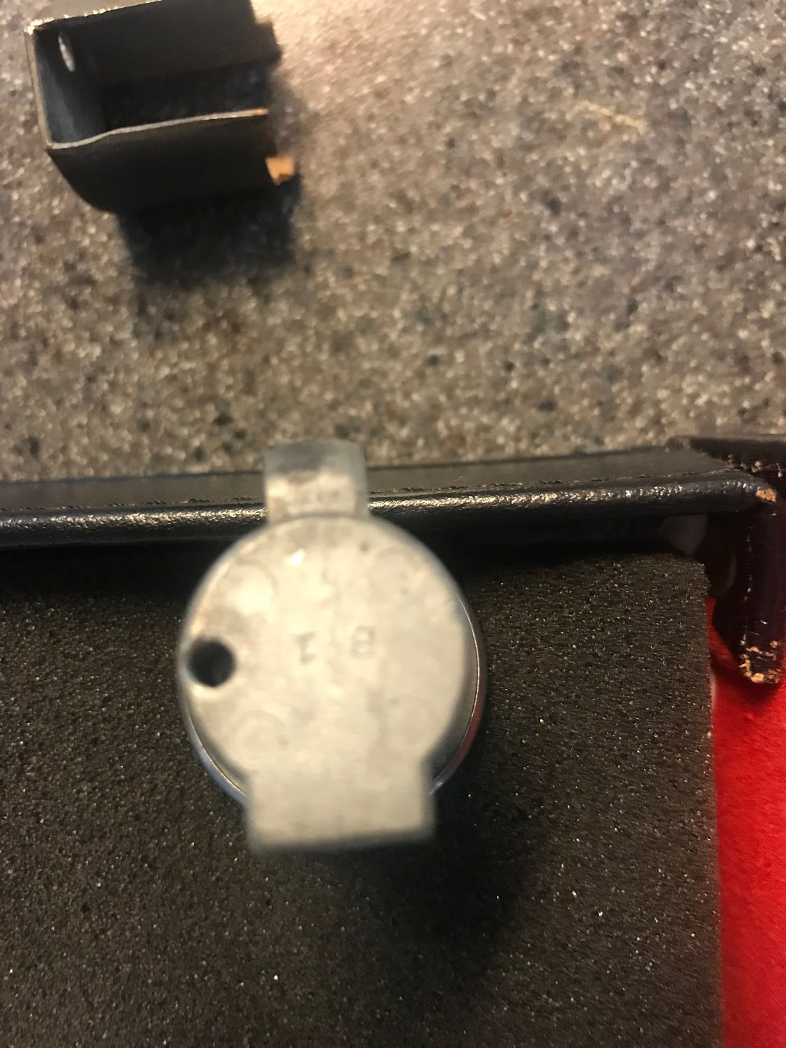

I purchased a new console lock for my 73 and would like to rekey it use the existing door lock key. I took it to a local locksmith and he told me it could not be rekeyed. Not sure if that's true or he just didn't want to mess with it. I've attached photos of the new lock.

Actually, if you remove the key cylinder from the housing you'll see 5 wafers that coincide with the shape of the key so that when the key contacts them they retract into the shaft so the shaft can spin inside the cylinder.
The first one the key goes through has a tab that fits into the groove down the side of key. If you remove that wafer and then file the rest so that with the key inserted none of the wafers are protruding, then the cylinder will turn with your ignition key. You may also find that once you can insert your ignition key that some of the wafers protrude a significant amount. You can just remove them. As long as you leave one wafer in it will still function as a lock.
A real locksmith would just change out the wafers.

Remove the cylinder by using a paper clip to depress the wafer on the left using the access hole in your 3rd picture and pull. Once that wafers clears the shaft you can insert the key and remove the shaft.
That first wafer would be the wafer you have to remove to open up the entry way.

The first wafer also serves as the cylinder retainer. He could bypass the retainer keyway restriction by simply filing off the keyway restriction and reinserting the wafer to function as a retainer only.
OR
Stamped on the cylinder should be the original 4 character key code which he could take to any locksmith and have a key cut.

Right about the first wafer being needed! Forgot I removed one but I had an unrestricted wafer that I put in its place. Been a few years since I had my locks apart.
